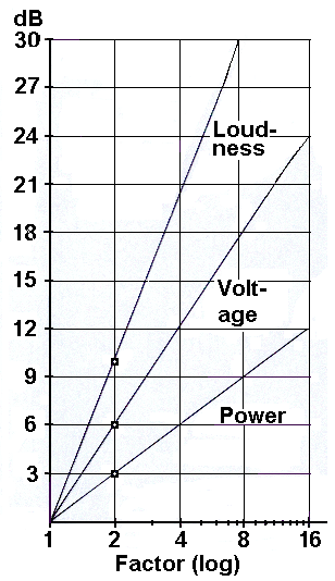

You may already know this, so I apologize if that's the case, but keep in mind that a 3 db increase is double. So 103 db is twice as loud as 100 db. 10dB is 10 times more intense than 1dB, while 20dB is 100 times more intense than 1dB.
In stereo world 3db is perceivable difference, but it takes 10 db to be detected as double the output levels.
Levels in decibels (dB) and their different factors
