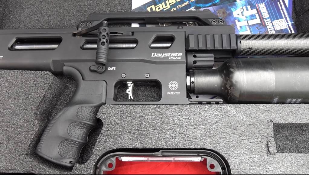

Hey guys, I managed to get ahold of the first High Power (FAC) Daystate Delta Wolf HP .22 in the USA. There is a load of these headed to the USA now...so a pre-order will actually get you one within a month or 2. Thanks to AOA for letting me skip the line and bring you this close up look at the Delta Wolf HP .22. This video has no shooting. This is the first video in a 4 part series. This video covers all the specs and how to operate and program the Delta Wolf. I also explain why the Advanced Settings will give you better accuracy than the factory sets...(although they will both shoot like lasers). Thanks for watching! -Nate @ Airgun Channel

Barrel Kits for caliber changes? LW barrels are hard to get now..so all Daystate's LW barrels will need to be used for complete guns. Kits in all calibers will eventually be available.

'here is some more info on the Delta Wolf:
They forgot to tell the gun how to de-cock. They must have just totally spaced it off. The bolt knows when it's open..why can't you hold the trigger down with the bolt open and then it knows your trying to de-cock it?
..oh yeah that's how you unlock the gun, but it takes a 4 second trigger pull, why not a one or two second trigger pull for de-cocking.
It's not just annoying, but dangerous. You can't change your settings without ending up with a cocked gun. So you have to shoot it to make the gun safe again.
I'm curious to find out if they actually "just forgot" to program de-cocking, or if there is some reason for it. I think they just forgot.
also my gun has no presets for .177 pellets. I guess that will be up to me to figure out. I think it should have at least 3-4 pellets programmed for each caliber (not .30 because there are only 2 kinds).
The good news: maybe with that USB port you can just hook it to a PC computer and update it. Many companies (drones like DJI) will have updates that release new features and abilities for existing products. That would be cool. I'll ask AOA about the de-cocking next time I talk to them.
