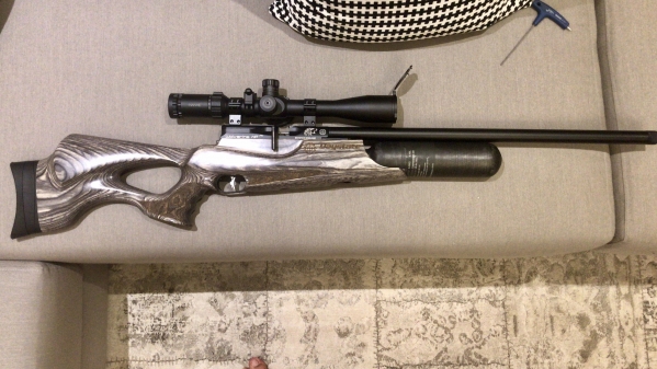

I’m definitely going to put the gun through it’s paces before I fiddle with anything. Like others have mentioned, every Daystate I have ever owned has come tuned up pretty darn well right out of the box. I only tinkered with my .22 air ranger and that was simply because I wanted to shoot the 21 gr Kodak’s at 900. Getting it there was pretty simple with just a couple hammer spring spacers and I did a little polish work on the transfer port. That makes sense about having the higher than normal reg pressure with the slingshot hammer after thinking about how consistent my old unregulated Wolverine B was.
I forgot to reply about the scope. I love the Sightron scopes. I run the SIII line on all of my .22’s and .17 HMR rifles and I have three different S Tac series scopes on air rifles. I enjoy clear glass after shooting precision center fire rifles with nice German scopes for most of my life. These do a great job in that department and have been 100% reliable since day one. I would estimate that I have owned over 10 Sightron scopes total so far and currently own 6. I like em. I stick with the S-Tac and SIII series scopes and havnt has any experience with any of the SIII or SI series.

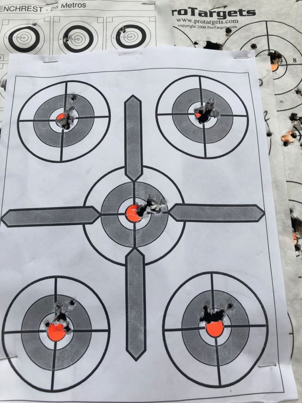

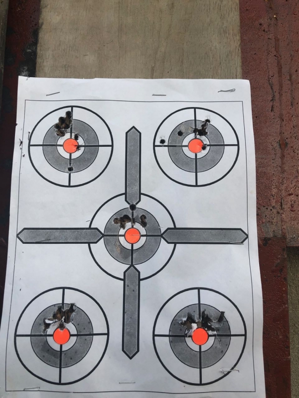

Just a little update... I’ve yet to stretch the Wolverine out past 50 yards but I was able to work out a 45 yard shooting lane at my house. No pics from the targets because I forgot to grab the target off the holder and the sprinkler subsequently soaked it and ruined it. I had 50 rounds down range all in 5 shot groups shot through the magazine and every group was well under 1/2”, no exaggeration. The accuracy and consistency that I’m seeing in this rifle is amazing. The addition of the Huma regulator really fined tuned an already great rifle. I am absolutely loving everything about the rifle thus far and would highly recommend it. I will hopefully have a chance to get some 100 yard groups on paper in the next couple weeks. Cheers!
