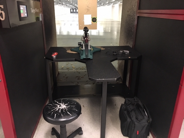

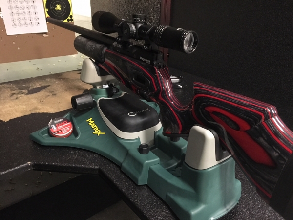

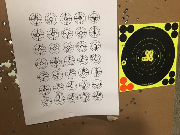

I was shooting my new Red Wolf HP .22 inside yesterday at 50 yards. It was spot on using the redesigned 25.4 JSB's at mid power. I started at the bottom of the target page and worked my way up to the top row. I was also switching from mid to high power on the middle rows. Settled on mid power and was very happy with the top row! All the flyers were my fault for the most part.
