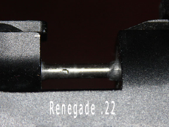

Here's a photo of the damage to my Renegade. I had 8 breech seal leaks in the first 3 months of ownership. When using the magazine, each shot got progressively worse. At 25 yards the final shot from the magazine would be off by inches.
I used a Dremel to trim off the offending edge of the actuator on the magazine and problem solved. That was over 3 years ago and I have not had one single breech seal failure since I made the repair and every shot from the magazine is now accurate.
My Pulsar also had damage but not as bad. So I decided to leave the magazine alone. Then while out shooting the magazine jammed. I took it apart later and found that the edge of the actuator had broken off, so it sort of repaired itself.
Sadly, Daystate was no help at all and said it was "just cosmetic". After repeated complaints they finally agreed to let AOA replace the probe.
Then they designed a completely new magazine that doesn't damage the gun. Just a coincidence? I think not.

That is interesting. I understand how the actuator in the old mags can dent the probe, I had a couple that looked like yours. But, they both shot fine, and I never had a breech seal issue. I don't doubt your experience, but I'm having trouble understanding how it affects clambering, and causes breech seal damage. Regardless of the condition of the probe, it should remain centered during chambering. Do you have a theory on how it's causing the O ring damage?
