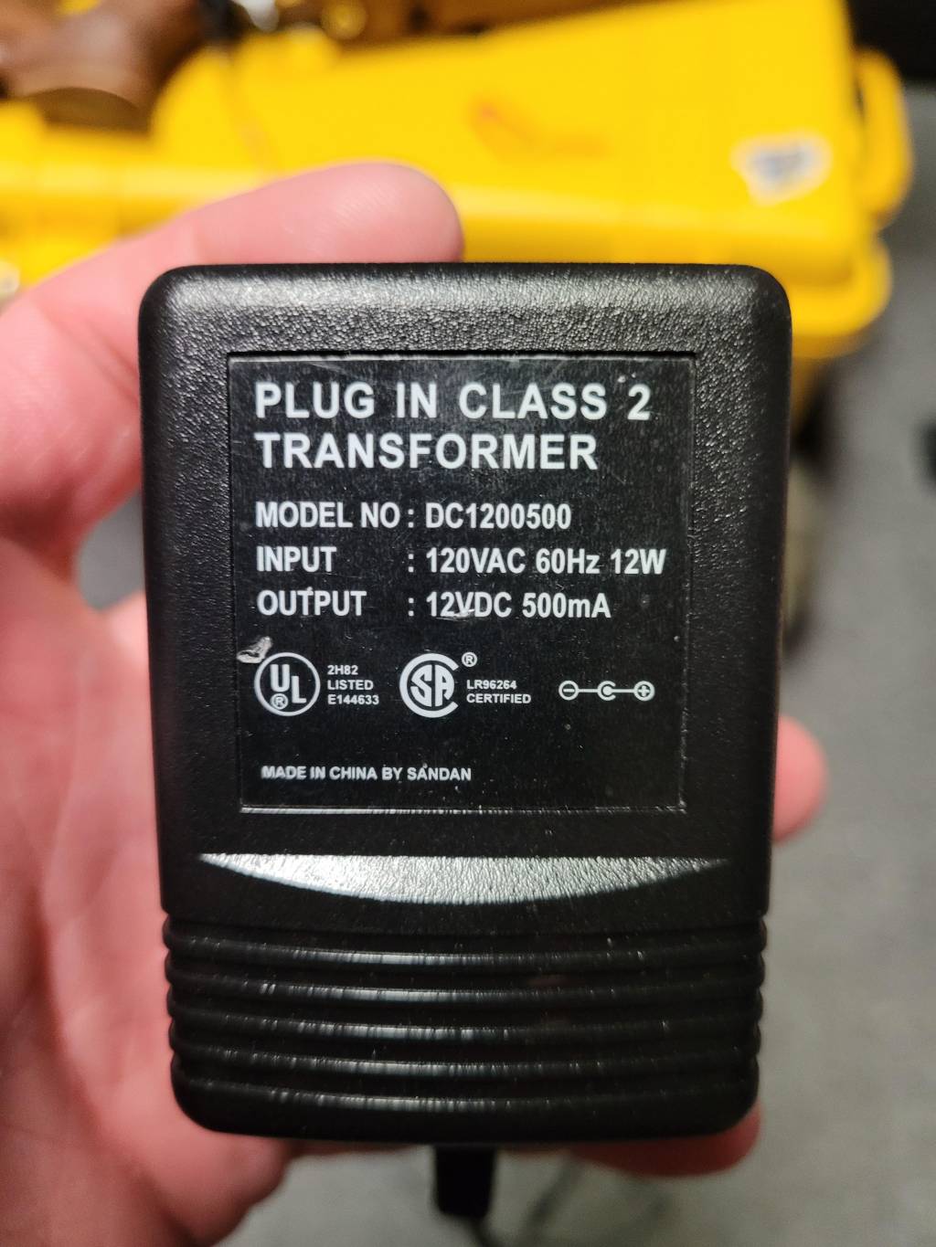

This is the one that came with my Mk3. Works fine. A little higher output, but the manual states that it is fine. Could very easily make one with the correct plug end.
