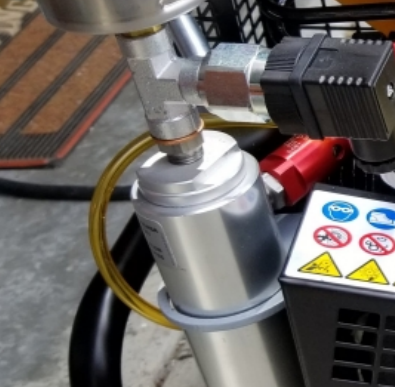

In a thread about the LC-110s I added a male foster check valve on the input side of the gold filter tower in my system.
https://www.airgunnation.com/topic/the-daystate-lc110-compressor-report/page/4/
It acts as a poor man's priority valve by allowing an owner to open their tank valve before pressure builds in the LC-110. When the compressor pressure exceeds the pressure in the tank being filled the check valve opens with pressurized air in the filter. A male foster with a check valve inside allows a partially filled tank valve to be opened before the compressor builds pressure. PMV's are only a requirement when filling a tank from empty. It is critical for dive compressors more than it is by PCP owners since dive tanks are usually closer to empty when refilled. Thanks for the alert observation. Accuracy point for you.

I want to stress that there's nothing wrong with a third party filter solution, I just decided to make it close to stock which has some minor advantages. The Coltri filter tower drops right into the existing mounting ring and bolts to the existing slot in the base plate and has its own matching bleed valve just like the existing separator. The formed metal tube in between is factory Coltri and fits perfectly. The air exits the tower on the side without interfering with the removable top that allows access to the filter cartridge, and there's a spring that pushes the cartridge up and out of the tower for easy access. I use the 13x molecular sieve cartridge for drying the air, they have twice the moisture capacity of the scuba type cartridges. The Coltri tower parts, bleed valve, adapters and tubing were about $250 and the cartridges are about $30. I'm working on an easy way to repack the filter cartridges which is about seven times cheaper with sieve material purchased by the pound.
The PMV is the common 211 model at the tower outlet. This feeds the existing fill whip. With the necessary adapters it was about $100. The pressure maintaining valve makes the moisture separator much more effective and extends the life of the filter considerably whenever filling from below 2000 psi.
The hour meter I started with is an internal battery self contained vibration sensing unit from Amazon, under $20. I also have an AC powered unit which requires a housing, so I 3D printed a housing but I have not installed that one yet. I may change to it because it can be read even if the compressor is off, but it does require wiring into the motor power. The vibration sensing type requires pushing a button to read if the compressor is not running.
I also changed from the DIN300 at the end of the whip to a Foster female and added a bleed valve. This is useful for filling small tanks and airguns as well as my SCBA tank. The bleed valve is required because the PMV blocks the standard bleed valves from draining the whip, and the small tanks and airguns don't have a bleed on them. This upgrade was about $75.

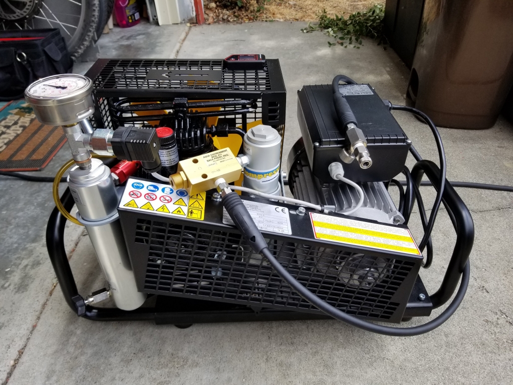

Generator Test #1
Started and ran the Daystate LC-110 compressor from a Honda EU3000 generator today. This is one advantage of the LC-110 vs the T2. With the T2 a 230V generator would be required which is not something that is common here in the US.
I haven't run the EU3000 in a long time, and it started on the third pull. Honda engines are amazing. And that's with standard gasoline (with ethanol). It does have a fuel shutoff so the carburetor can be run dry. Of course the electric starting battery is dead, but the pull cord with automatic compression release makes it easier to start than an EU2000.
Since the compressor's starting surge is the primary concern, not the max running current, I didn't build pressure. This generator can handle much more than 15 amps at 120V so I don't expect that to be a problem.
Later I will test it with the EU2000's but they are in storage so not convenient to do right now. I can test with a single and two ganged together. With a pair of EU2000's paralleled there's little question, that's more power than the single EU3000. The real question is will a single EU2000 do the job. I'm doubtful that will be enough. If it is enough here at low altitude it still may not be enough at higher altitudes where the power drops off. I'll give it a test at some point. It might be useful to take the compressor when we go camping in the mountains and have a wonderful opportunity to shoot.
1566245212_15761651615d5b015cccb121.38329030_DayState LC110 20190819_120614.jpg
Daystate LC-110 with Coltri Filter Tower, 211 PMV, Foster with Bleeder on Fill Whip and Hour Meter. Takes standard MCH6 (SC000340) type filter cartridges (available from multiple sources), spring loaded to provide easy access. Removing the filter tower cap is unhindered by plumbing, and there's a standard purge valve in the base of the tower just like the water separator.
I designed and 3D printed some wrenches for the Filter Tower, Oil Vent and Oil Drain. In particular the Filter Tower wrench is handy and more convenient than a huge standard wrench large enough to fit the tower cap. The blue stripe on the cartridge needs to be checked periodically, when it is no longer blue it is time for a new one!
This is essentially a scuba compressor with a smaller motor (though it is not rated for breathable air by Daystate, and we are not using breathing air type cartridges).
I'm working on a simple way to refill the cartridges using some 3D printed parts to extend cartridge life that is not completed yet.

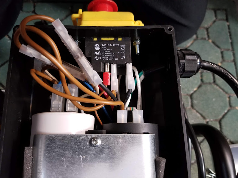

Auto Shutoff Adjustability
I took a look into the control box on my LC-110 this morning. There is no pressure shutoff adjustment there.
Note - there are hazardous voltages in this box and capacitors that can store dangerous energy. Don't go in there unless you take proper safety precautions.
There are very few components inside the housing (but there are a lot of wires). There are the two motor capacitors. There are a pair of connection blocks, each with an open terminal, perhaps where the hour meter can be connected (I did not verify this). There is the power control switch/relay, a KJD17B. If you search for the part number lots of info can be found. This unit incorporates the stop/start buttons and control relay, the input from the auto-shutdown unit, and controls the up to 16 amps to power the motor. It also has under and over voltage shutdown as well as power loss shutdown built in. Very nice unit, and a fairly expensive part.
The control circuit is 120V so the signal from the pressure sensor must be 120V, and any adjustment would have to be internal to the sensor, which is screwed into the tee just below the gauge on top of the oil/water separator (it is visible in the photo of my compressor in the previous posting). There are three conductors in the cable from the sensor to the control box. One is ground. One goes to the control input on the power control switch/relay, the other goes into the motor via a small white wire (which may be from the internal RPM sensing motor run switch). The sensor must be normally closed, as unplugging it causes the motor to stop as soon as the run button is released. The power control relay won't latch in.
I see no signs of adjustments on the sensor itself. The adjustable sensor is a different unit (Humdinger found a video on installing it), It is larger and has a cap covering an adjuster as well as a lock screw to keep vibration from changing the setting.
Take Care and Be Safe.
1566672144_6673897595d618510330915.58200543_lc-110 controls 20190824_105712.jpg
I've not been inside the box but speculate that perhaps they're a start and run capacitor for the electric motor? Looks like the resistor bridge is sacrifical in the event the start capacitor fails (black)? Looks like a four pole run capacitor in the other (white)?
I'm pretty sure the 4 pole pressure shut-off switch on the condensate tower is electro-mechanical and acts more like a pressure switch than an adjustable variable resistor. Mine will spring rattle during the compression cycle as it nears shut-off pressure.

I agree - start and run capacitors and the pressure cutoff is a switch. Nuvair sells similar units from Nason. I don't see a brand or model on the one here, and no sign of adjustments when installed. Perhaps there is something coaxial inside the air inlet? I'm not inclined to remove it to have a look.
