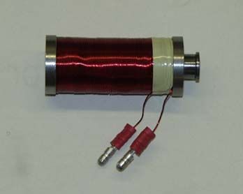

From memory, I tbelieve the Airworlf uses a tubular push solenoid. If it's anything like the tubeular designs I have seen here then the end of the piston might unscrew. If it does, they you can make a replacement using a screw with the same threads. That way, you wouldn't need to alter the original parts in any way at all.
