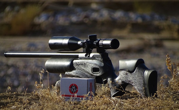

I have 2 of each, specifically .30 SAFARI & CROWN, .22 SAFARI also, plus I have .25 barrels for both and both models in .177 as well, HP and 12FPE.
I have recently been doing a lot of tinkering with the new FX SUPERLITE system on the Crown Continuum and although accurate there can be huge issues with POI shift and having to index the liners to get the initial zeroing of the gun right, this is never the case with the Redwolf IME.
Contrary to popular belief it is very easy to change calibers on the Redwolf, especially from .22 to .25 and reverse, I have found that no programming is required for both to shoot extremely well at 100 yards with nothing more than changing the barrel and probe, TOMCAT did a video on how to acheive this.
The new DELTAWOLF could be seen to have removed the arguments on caliber changes and tuning completely though, effectively negating the "perceived" advantage of FX's caliber change system, although IME you end up investing a huge amount in these extra barrels and probes etc. so FX caliber changing certainly isnt cheap.
Above all the aesthetics and QC of the Redwolf wins out IMO, certainly the .30 SAFARI pips the post in the accuraccy stakes at 100+ IME and this is as set up from the factory, I absolutely love the Daystate electronic trigger and have never had issues with them, the FX units seem to constantly lose a stage or fail to reset though which annoys the hell out of me, but the trigger is good when it works.
