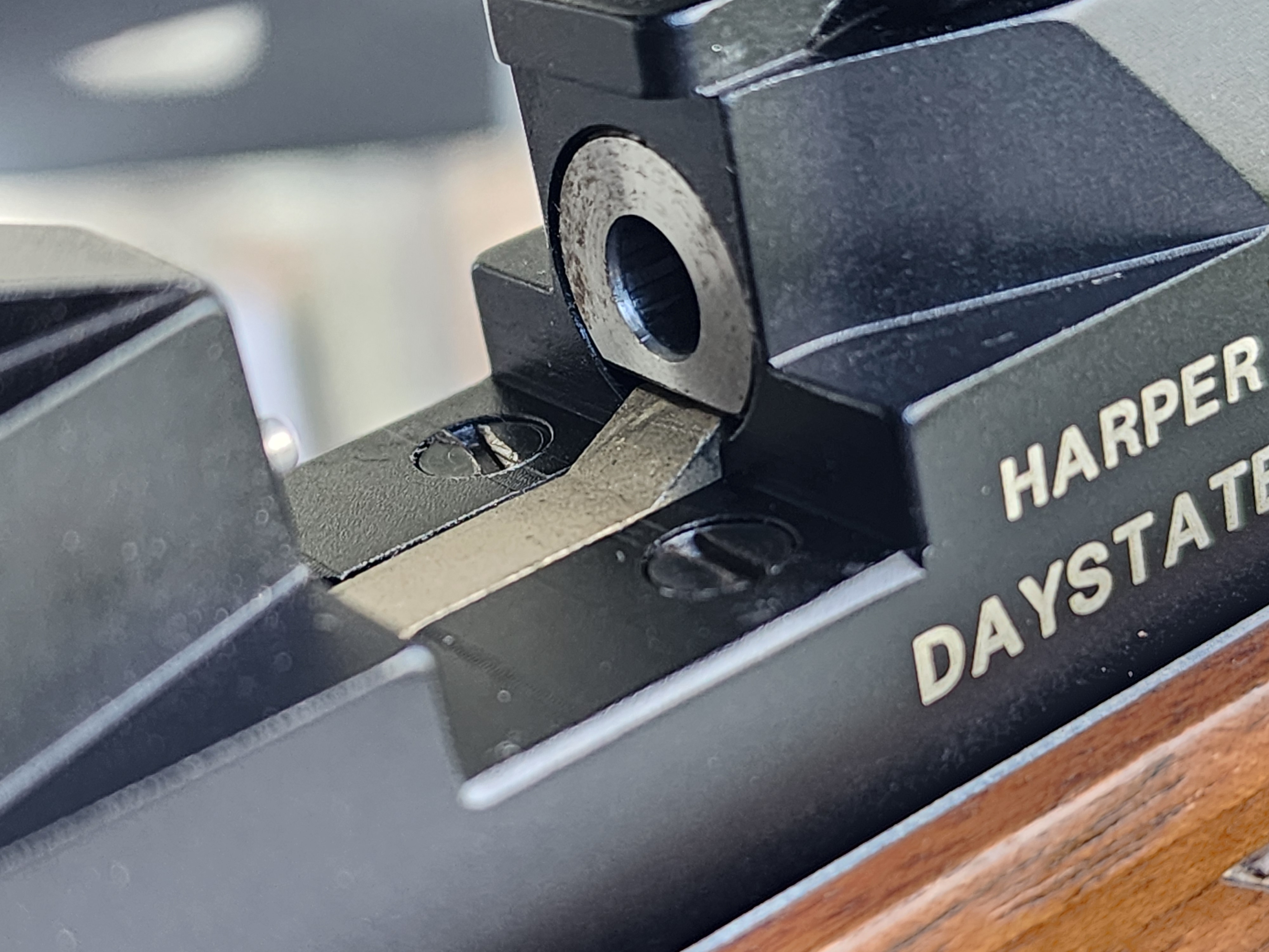

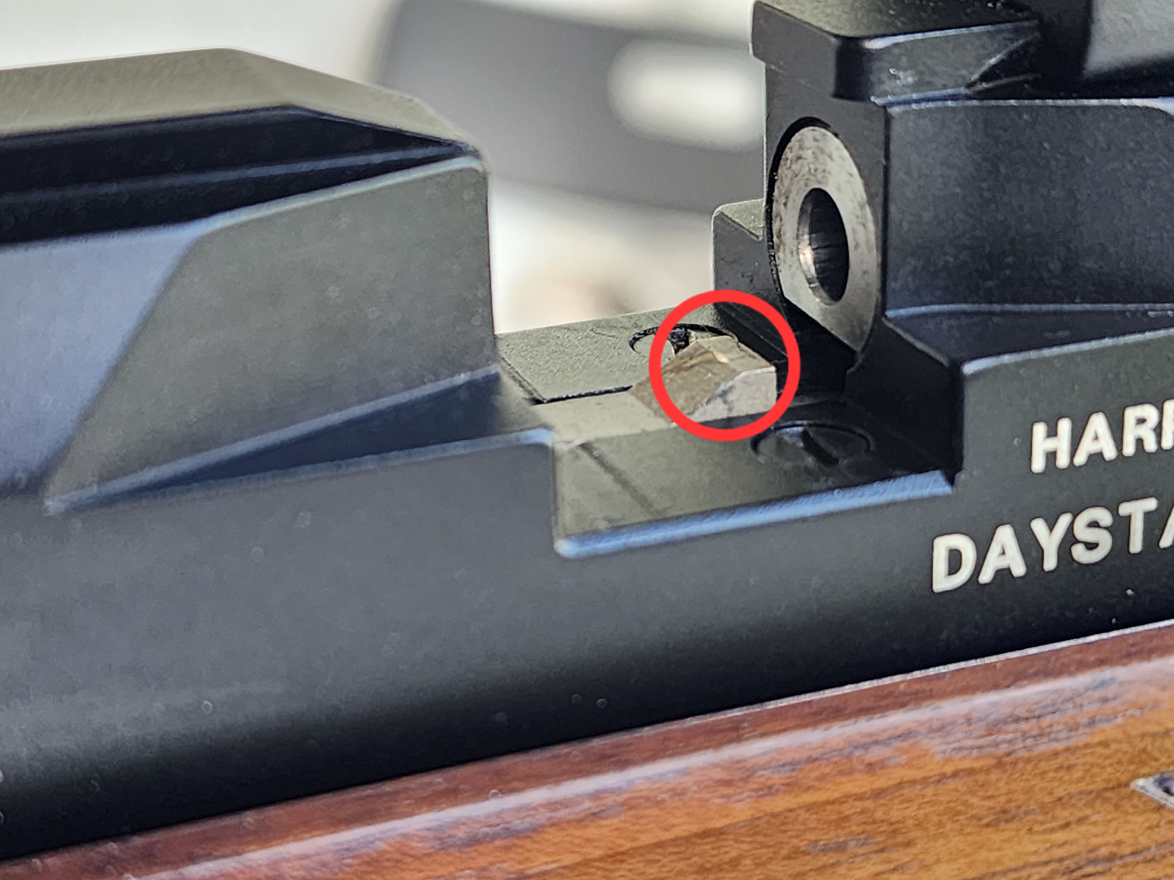

I just bought a new revere .177 from aoa,
And after first tank I realized the sound of the rifle changed,

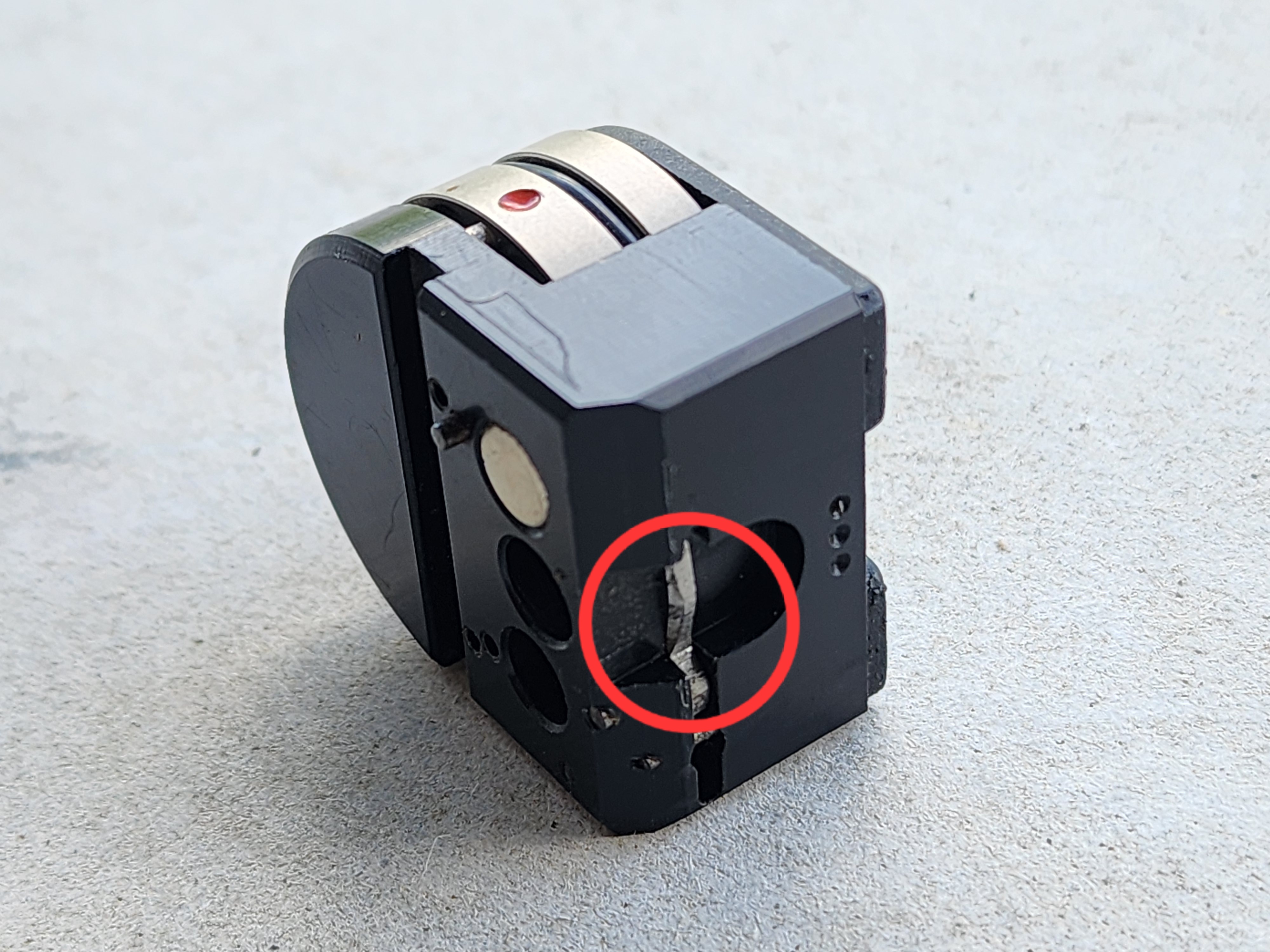

Upon inspection a portion of o-ring that holds the transfer port in place was sticking out just under the barrel breach port!!!
Called Aoa and they said it happens after every 600 or shots!!!
They are sending me some spare o-rings and if that won’t work,
I can send the rifle back to Aoa,
Now my question to all u guys who use these pcp’s
Since this is my first ever pcp,
Why manufacturer has this portion shaved off at the entrance bottom part of the barrel port which is letting the o-ring slip out under pressure???

Ok guys a little update on my revere .177,
just got it back after 2 weeks from Aoa,
apparently the repair guy at Aoa said that the brass bushing that sits on the tp was undersized from factory and they just replaced it with bigger size and tested about 50 shots using 16grain pellets to stress test the rifle,the rifle held its seals with no problem.
i just shot like 4 13 shot mags through it using 10.3 grain and it is functioning fine…

Funny u brought this up,
I had a chance to physically see the original tp brass bushing and when the repair was done by aoa i did request the repair guy to send me a spare brass bushing that he installed and he did,
and I can tell u with proof that the replaced brass bushing is beefier than the one I saw when I opened the rifle to reseat the oring.
even the aoa guy said just consider it bad luck and that with daystate that is Avery rare case.
all I care is that Aoa fixed it with warranty and it works actually better than before.

But can u tell why that part of barrel is shaved off which is letting the o ring slip out??
To answer your question, the shaved out portion is a carry over from the older Huntsman Regal. The Regal used the older style of magazines with a different indexing system. Here's a pic of my Regal...
When you pull the bolt back all the way, the portion circled in red indexes the magazine to advance for the next shot. The Revere does not have this indexing lever in the breech so now it's just an empty space and they just continued to mill out the barrels with that flat area. Hope this helps.

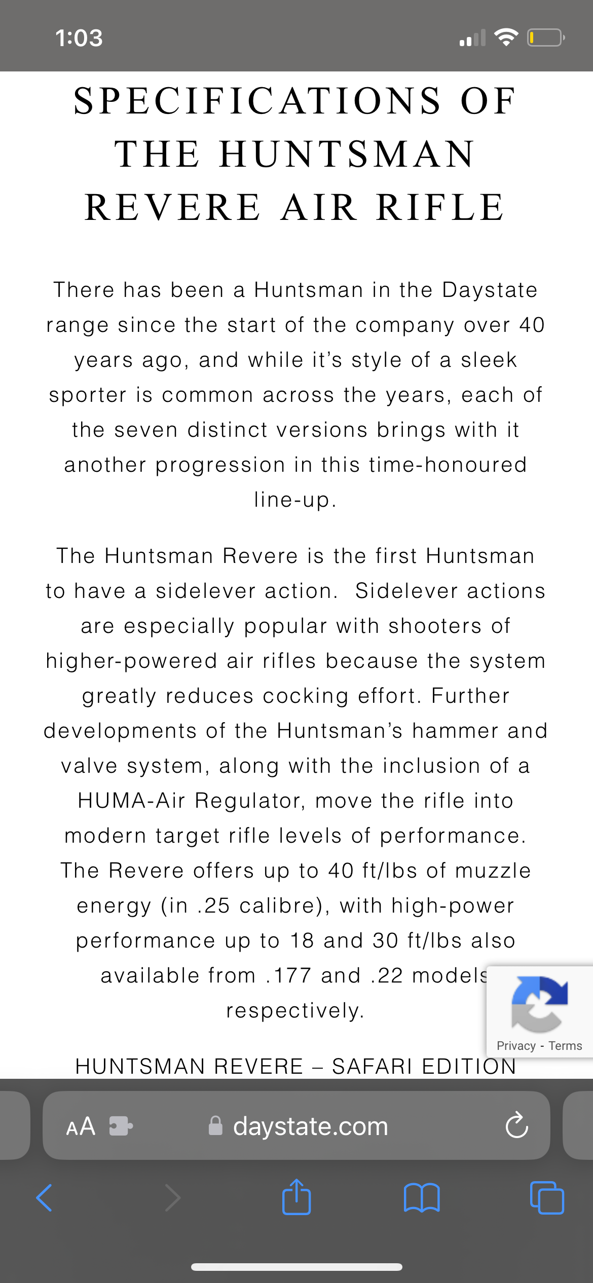

@1:30 this Aoa sponsored reviewer used this term, listen buddy!!!
Reactions: Raider03
He is a good reviewer.
This is the Huntsman Revere description from Daystate’s website. They speak of 40 years of progression across 7 versions… they also speak of “further development of hammer and valve” along with adding a regulator….
Daystate themselves don’t mention a “ground up redesign” - at least not in the Revere product description on their website.
