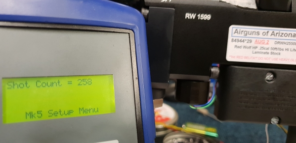

As I said, I will check in the morning. Its morning and I have checked They are using a N70 as they have done on every high power rifle up to date . Trials on red wolf which involved many thousands of shots didn't flag this and even when I asked they were doing a batch of this very gun and they had not had a problem - see picture below which just happened to be on test when I asked.
So while I enjoy the challenge of being told that we are making faulty guns in one breath and then being asked and what are we doing about it in the next, its not being seen here.
Feed this back to AofA and see what they say. Maybe it's a local issue, special abrasive pellets or lube ? Don't know, but now we are aware we will monitor this closer.

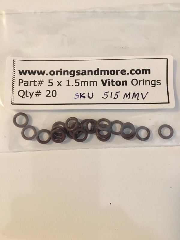

I’ve been working with AOA and they have ordered the 75’s for the breech seal issue. Im on 1000 plus rounds without issue on my 1000fps redwolf. It also added some consistency to the shot string as well.

with reference to the redwolf o ring issues being discussed above, i would like to preempt and get some Viton 75 orings for my upcoming .25 redwolf hp and my current .22 pulsar.
could someone tell me the sizes i would need for each. also where could i order these from.

Apparently there is an issue, since I am getting a .25 HP i might as well get the o rings which are working for other people. And as there is a substantial lag between ordering and receiving in Pakistan, I would like to order now.
Even with my .22 pulsar, the breech oring blew in about 1500 rounds. The second one has done 500 plus without issues but no harm in trying the viton 75 if they are better

75 shore will last longer
I just bought and rec'd these orings a few days ago. I have the Redwolf .22 HP, and I hope these are the correct breech orings. I have only put 150 pellets through the gun so far, and no problems what so ever. My question is, should the breech o ring fail, are there any videos that show you how to replace the breech oring? Are any special tools required? And can the oring be replaced with out taking the scope or barrel off. I'm a newbee, thus all the questions, thanks much in advance for any guidance.
ps: the orings cost $5.67 delivered.

I personally would go with oringsandmore. Good people and great service. Not that McMaster isn't good. I just prefer the other. And I find that McMaster doesn't have some of the sizes I need.
Crusher
Could you please guide as to what should I be searching on oringsandmore for viton 75 breech o rings. For both the .22 and .25.... can't seem to find while do8ng a search on their web site
