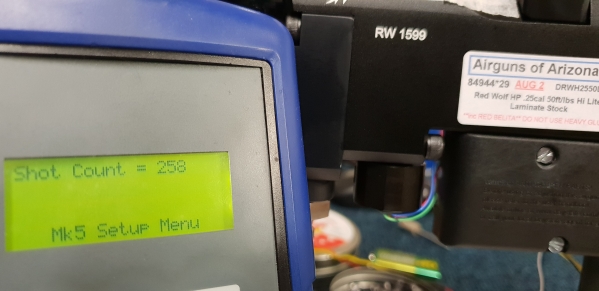

Is there a common problem with the RedWolf .22 HP blowing the breech o'ring? Mine is eating them like pringles. I get about 300-400 shots and it blows. If I shoot the 34 grain pellets on HI, I only get maybe 100 shots before it pops. I switched to nitrile and it did the same thing. So now I'm on Viton to see if it helps. Is it possible there is something wrong about the o'ring grove or maybe the probe?
I've got to get this fixed. I'm shooting this gun at EBR this year and I can't have it blow up during the match.

As I said, I will check in the morning. Its morning and I have checked They are using a N70 as they have done on every high power rifle up to date . Trials on red wolf which involved many thousands of shots didn't flag this and even when I asked they were doing a batch of this very gun and they had not had a problem - see picture below which just happened to be on test when I asked.

During your testing are you shooting the .22cal HP guns on hi power for thousands of shots with 25gr pellets? That's what I had issues with.
34gr in my .25cal Renegade HP did it as well. Maybe the heavier weight is putting more stress on the oring than your testing? Just a thought. Keep up the good work and can't wait to see what you bring out next. A bottle Electronic Bullpup would be nice.
