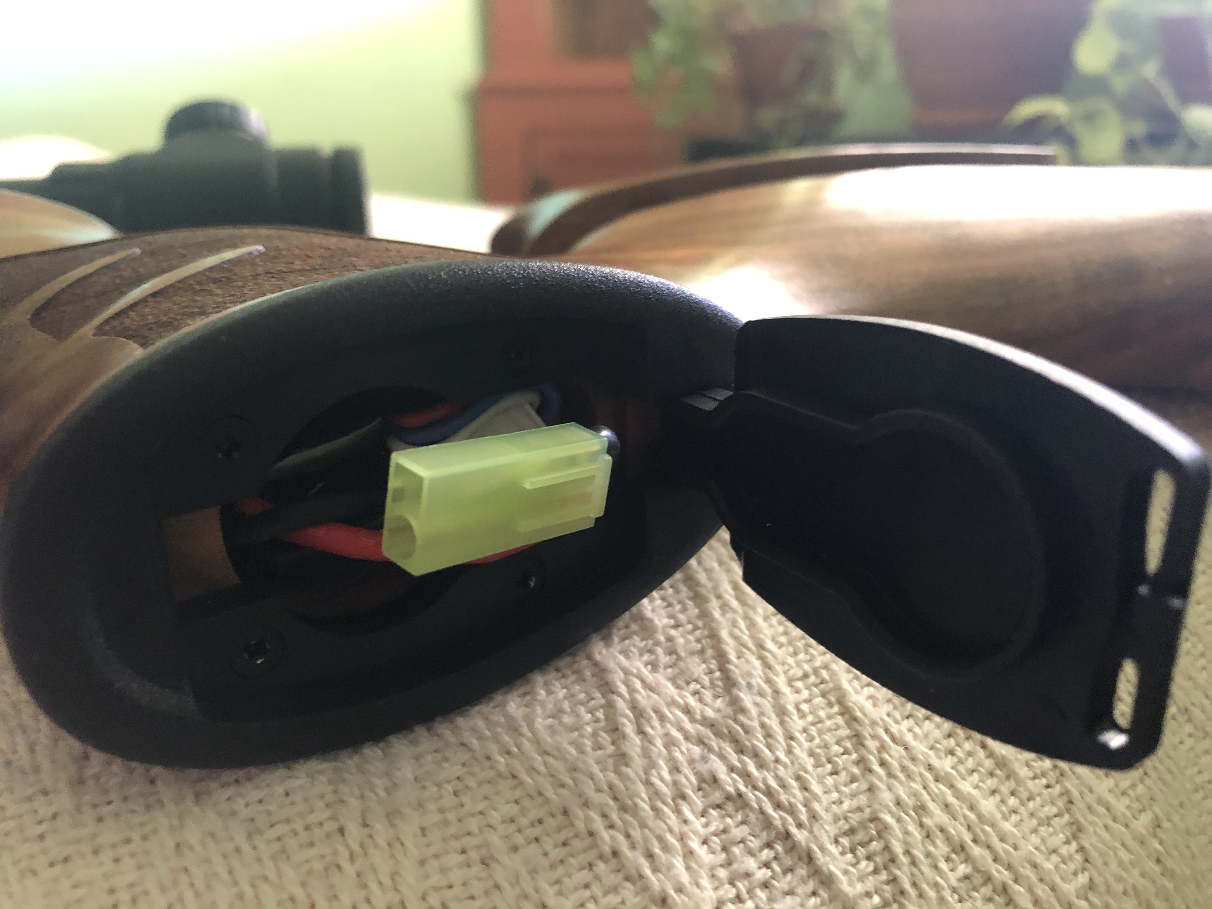

Does anyone know where i could get a little battery wire extension for my Alpha wolf? I have large hands and it's almost impossible to remove the little battery plug. I know better than to just pull on the wires.
That’s easy! Those connectors are called JST-XH. all Chinese R/C site has it… search “JST-XH 3S extension” and BANG!

Thanks @Arzrover luckily the battery fit it is 105mm+ but it was the 21mm width that made it snug fit. I could press it in with minimal pressure and the pull it out with the heavier connector. I saw no indications of rubbing on the sides of the battery, it is bit thinner. I may take the stock off and widen the opening, won’t take much at all.

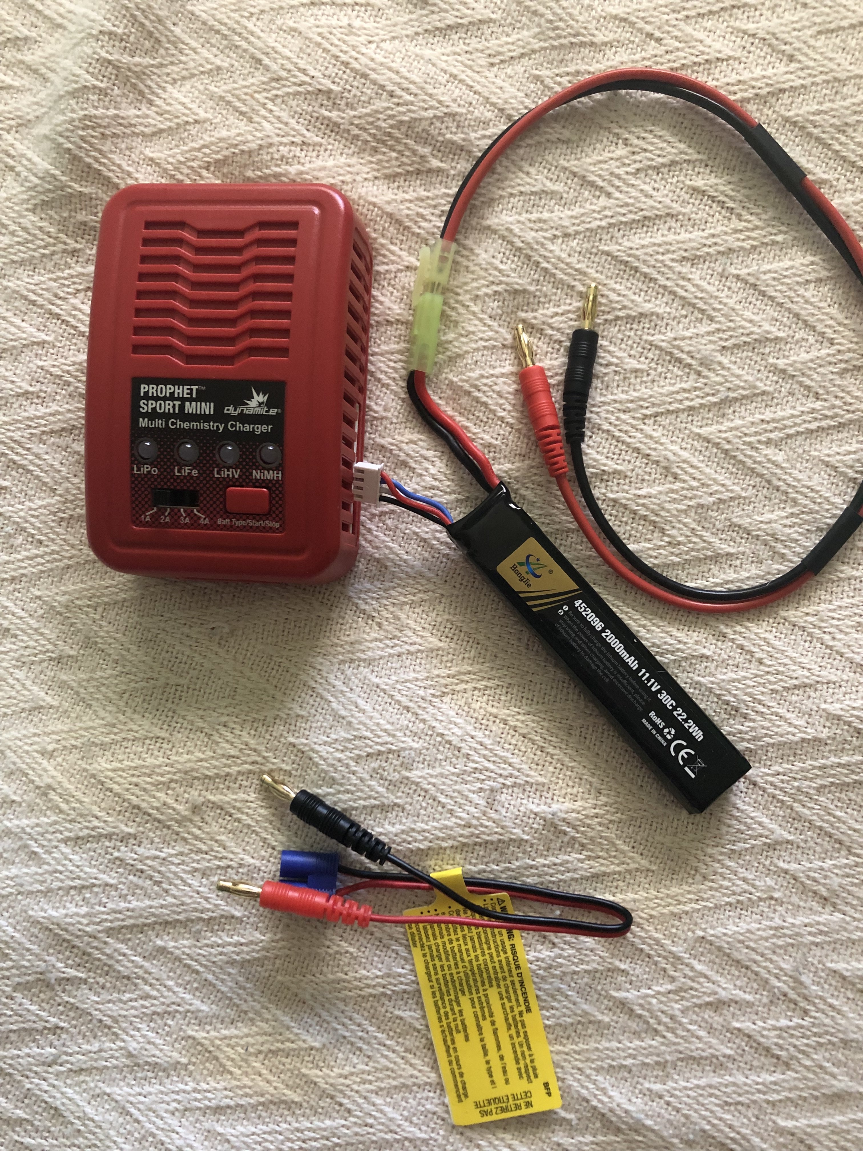

@Martin3528 I did leave the leads on and purchased a charger. I wasn’t sure which way I was going to go until your comment, thanks.
Now I just need to find a premade wire set that will allow me to charge the Daystate OEM battery with the single JST XH connector With the new charger.

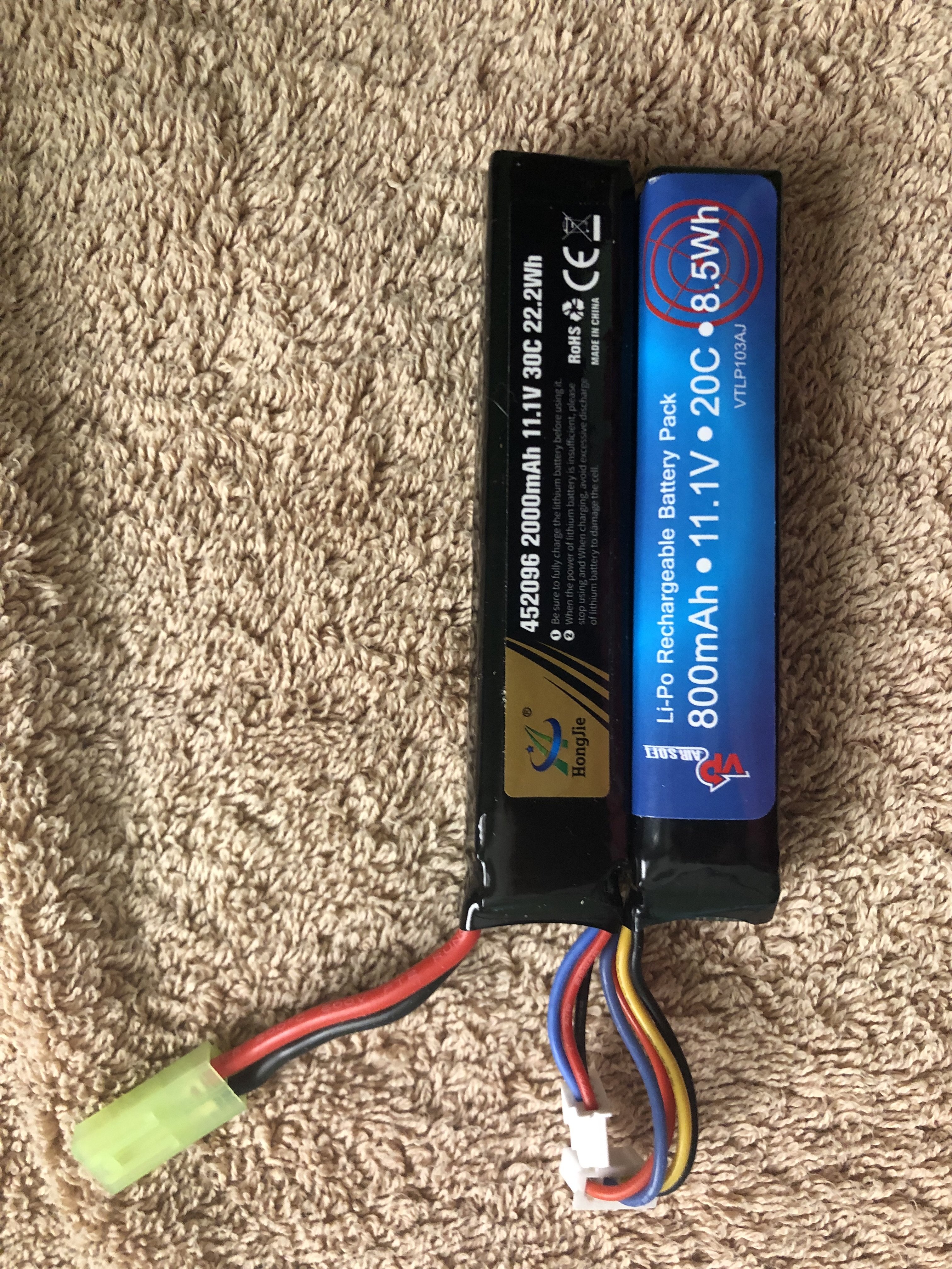

Cool that it fits...
I acknowledge that there are design tradeoffs that may allow for a little higher density but 800 and 2000 mAh being the same essential size is a bit comical to me. If your charger would also discharge, you could measure the ACTUAL capacity. Is it really important... probably not...
A real concern here is that these batteries swell a little under normal charge/discharge cycles. A tight fit COULD be an issue down the road.
Anyway... glad it fits. I've purchased 9 so far and didn't pay close attention to the dimensions or they lied so I have 3 that won't fit. They're not worth sending back... maybe I can find another use for them. Delta Wolf is very critical for fit... the Red Wolf is a bit more forgiving.

Yep got the balanced charger, would like to find a pre wired set so I could use the new charger with the OEM battery.
More CAPACITY ... 2000 mah / 3s / 30c rating verses the factory 800 mah / 3s / 20c ;)
