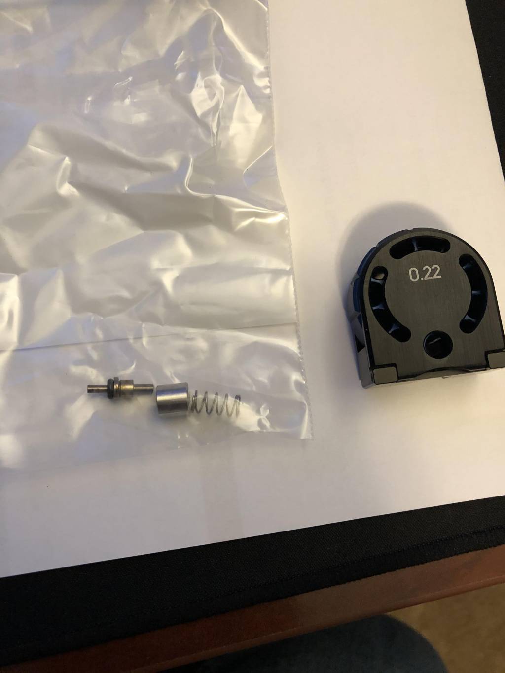

Actually, for owners with the old style actuator pin in their rifles, the new magazines are interchangeable. The reverse is not true; if you have the pin/plug in your action, the old style magazine will not advance. For those wishing to use the new magazine exclusively, installing the pin/plug makes sense, as the pin is point of possible failure, prone to eventual breakage.
Take care when using the new mag with the old gun, there have been a few where the pin has jammed in the upward position and the mag cannot be removed, gentle tapping with a mallet has cured this in some instances but not all, requiring the gun to be sent back.
Or do what real shooters do and just use the single shot tray LOL!
Best I can determine, there is no greater risk of the pin breaking (causing a jam) with the new style magazine. There have been cases of this happening with the old mag as well. I see one practical difference. Both the new Daystate mag, as well as the CARM, exposes the rotating pellet cylinder in the bottom recess of the mag. If a piece of the broken pin gets stuck as the cylinder rotates, the resulting jam might be a bit nastier. What AOA recommends, and it makes sense, since you don't need the pin with the new magazine, might as well replace it with the plug and avoid a potential problem.

But seriously, AoA must have converted my rifle in their shop to the new style mag because they included an indexing pin assembly in the box. Did you get anything like this?

Do you really have to swap out the Index pin to use the newest magazine design on a rifle with the last generation indexing system? I have been running the new magazines in my Wolverine with no apparent issues. There is a relief in the bottom of the new magazines that seems to allow the rifle's indexing pin to cycle without contacting the magazine. Is there something I should be concerned about?

No, you are fine. That recess, like the one in the bottom of the single shot tray, offers sufficient clearance for the old style index pin. The issue is metal fatigue in the pin, and using it with the new mags, or the CARM, is placing it that much closer to failure. But, if I wanted to continue using both style mags, I would do as you, rather than switching out the pin or plug for one type of magazine or the other. It's not a big deal, but it's not something I want to do on a daily basis. Just have a spare pin on hand in case you need it. Something to remember, occasionally when the pin breaks, it jams up the magazine in a manner that makes it difficult to remove. If the pin is jammed hard between the magazine and breech block, I'm not sure how they get it out. Assuming the probe can be pulled out of the way, I suppose the mag could be tapped out from the side, but it seems like something is likely to be damaged in that process.
