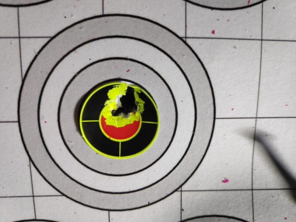

Here am I, back from my tests. I finally received some JSB Monster redesigned. I shot the first pellet down range and it went directly to the aimpoint. The next four pellets just followed the same way. Five groups of five in an 1/2 inch at 60 meters (the small target is 1 inch). Just fine, exactly what you expect from that kind of gun.
