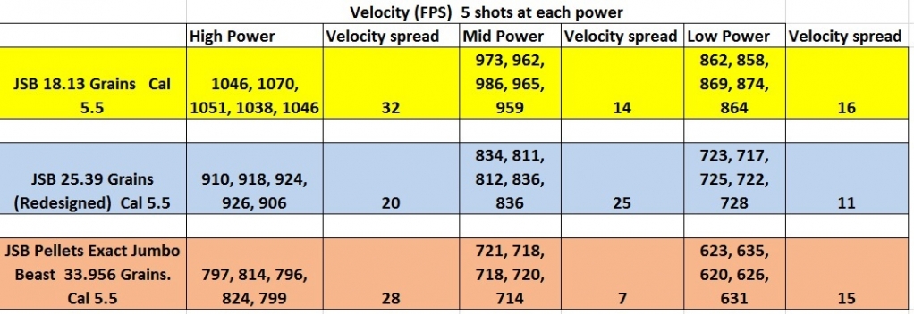

 I was super excited to receive the Daystate Redwolf .22 HP last Friday from AoA. I cleaned the barrel and recharged the battery. I started to test the gun Saturday. My test target is indoor 14 yards. The following is the results using different pellets.
Target circle 63: JSB beast 34g, Hi power, avg 870 FPS, 5 shots
Target circle 67: JSB monster 25g, Mid power, avg 930 FPS, 5 shots
Target circle 25: JSB heavy 18g, Low power, avg 1030 FPS, 10 shots
The JSB 34g and 25g shot okay but not great. I’ve various air guns ( Daystate Airwolf .22, FX Impact.22 .25, Fx Crown.25, Thomas .177, RAW .25. RWS .22, Taipan Veteran.22). They all shot one hole group from this short 14 yards distance.
The JSB 18g really baffled me, over 1 inch group at 14 yards! I tried to shoot below 110 bar, 900 FPS the 18g just wouldn’t group. I checked the barrel and breech o-rings, they are intact.
I’m disappointed from the shooting results. Did I missed anything? How do I tighten my shooting groups especially with the JSB 18g. Fellow Redwolf owners, please comment on your experience and share your tips...

I tried all 3 power settings using 18g which of course resulting 1000+ FPS, I shot the tank below 110bar which making the shots under 900 FPS. But the 18g still shoots like a shotgun. Interestingly, I tried JSB 15.89g, 14.3g ,13.43g, Crosman 14.3, And H&N 21.14 they all grouped well even over 1000+ FPS. I just don’t understand why the 18g wouldn’t group. All my other Airgun favorite the 18g. Yes I did try a different tin, the same thing.

It’s the lot# of jsb 18.1’ they are all over the place in head dia. Weight, skirt dia. Also look at outside edge of skirt if you see a fissure or looks like a crack or thin line going around circumference of skirt? Then that portion of skirt will tear off in choke causing unbelievably bad accuracy! Trust me I know! Mine absolutely loves 18.1’s at 890fps on low power, shoots 25.39’s at 930+ On hi power excellent accuracy! Not as fussy from lot to lot?, forget the 34’s on high, will destabilize after about 75yds! I love my Red Wolf you will to trust me... also give time to season the barrel? Mine shoots best after about 25 pellets down bore after cleaning! These are my observations for my gun! Also never changed any settings from factory specs.! One more thing that caught my eye in your graph of velocity’s is 18.1’s shouldn’t be @ 1030fps on low power? That’s what mine shoots on mid. Power not low?
