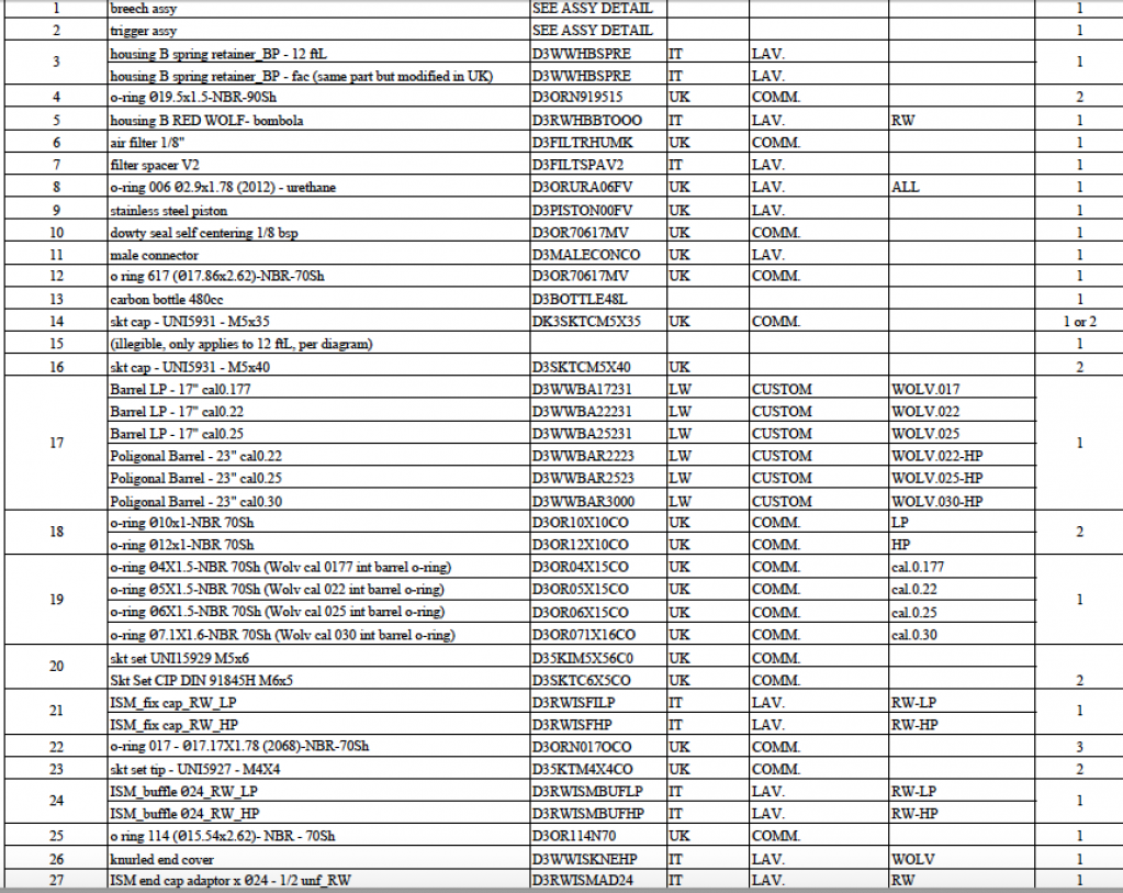

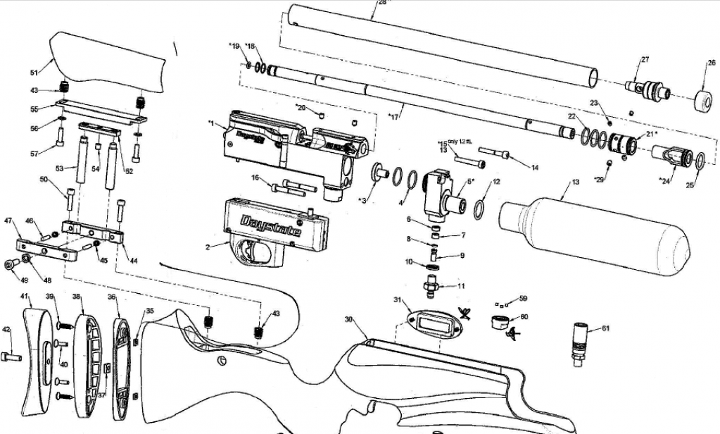

hopefully this diagram provides what you need. I have not been able to source the O-ring (urethane) or dowty seal, so if you find a source please post here. Thanks
It was inside the fill nipple. There is a spring loaded shuttle valve inside that allows one-way air flow, and it was on the surface of the little piston. Just have to unscrew the nipple. Neither of those was a Red Wolf, and since there is no reg plenum, I assume you will need to degas the rifle. Not sure if the RW bottle has the standard one way valve that allows you to remove it without losing all the air. Worst case, you would just drain the rifle when you crack the fill nipple seal. You could get some advice on that from AOA, or a tech familiar with the RW. If you loosen the nipple under pressure, then you will likely have to replace that O ring. If it's leaking through the shuttle valve, it will bubble liquid applied to the nipple hole. If the base O ring is leaking, it will bubble there. If neither place bubbles, it's not the problem.
