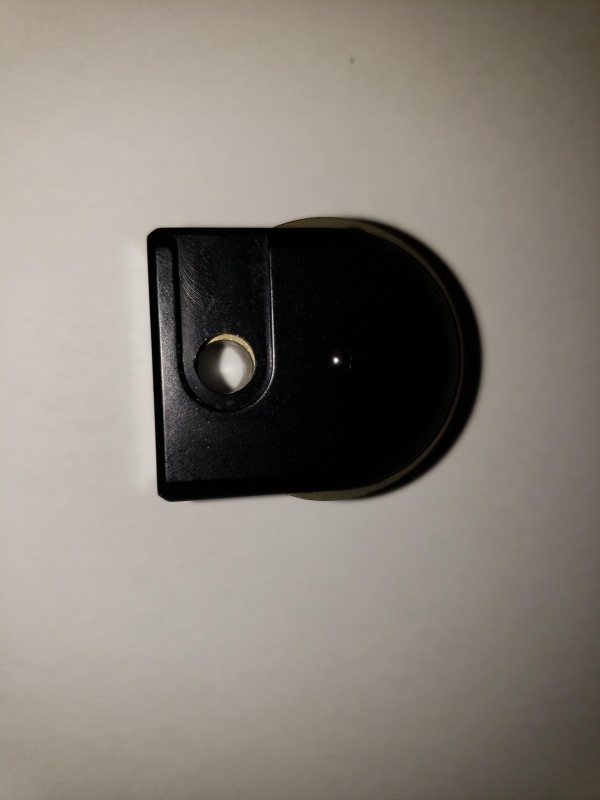

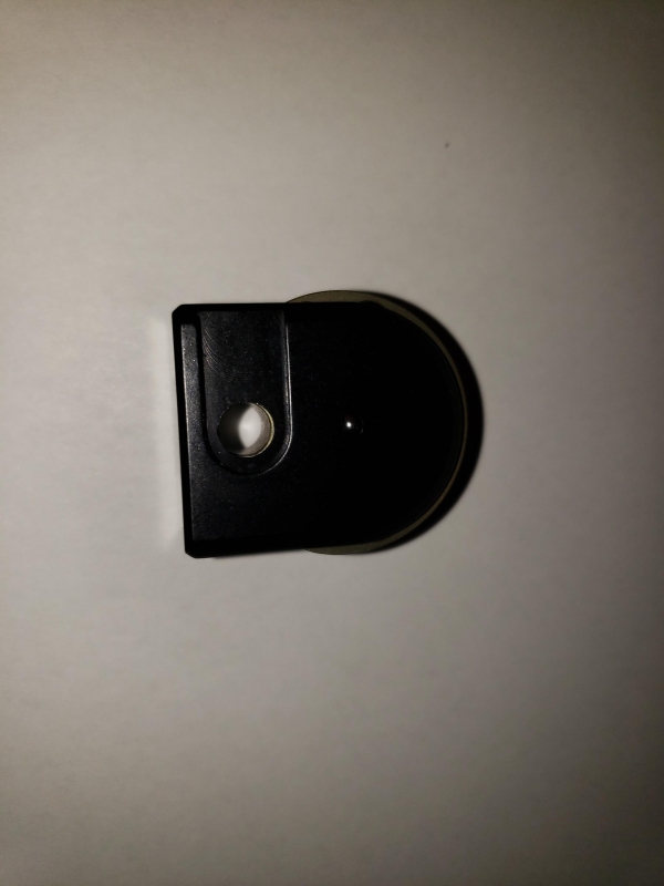

Some of the daystate/brocock magazines have a misalignment issue as see in the photos below, aslo make sure your not using a pellet that's not too long. If the pellet is too long it has a tendency to shave off a but of the nose or tail of the pellet. The bit of gold you see is the misaligned magazine.
