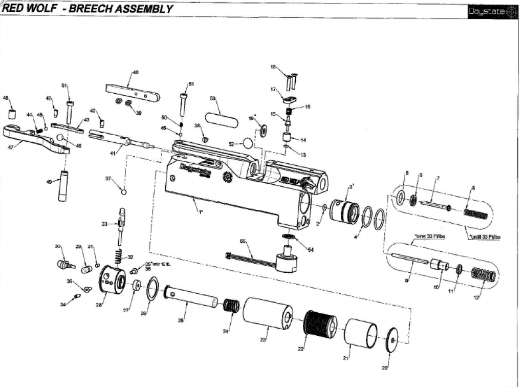

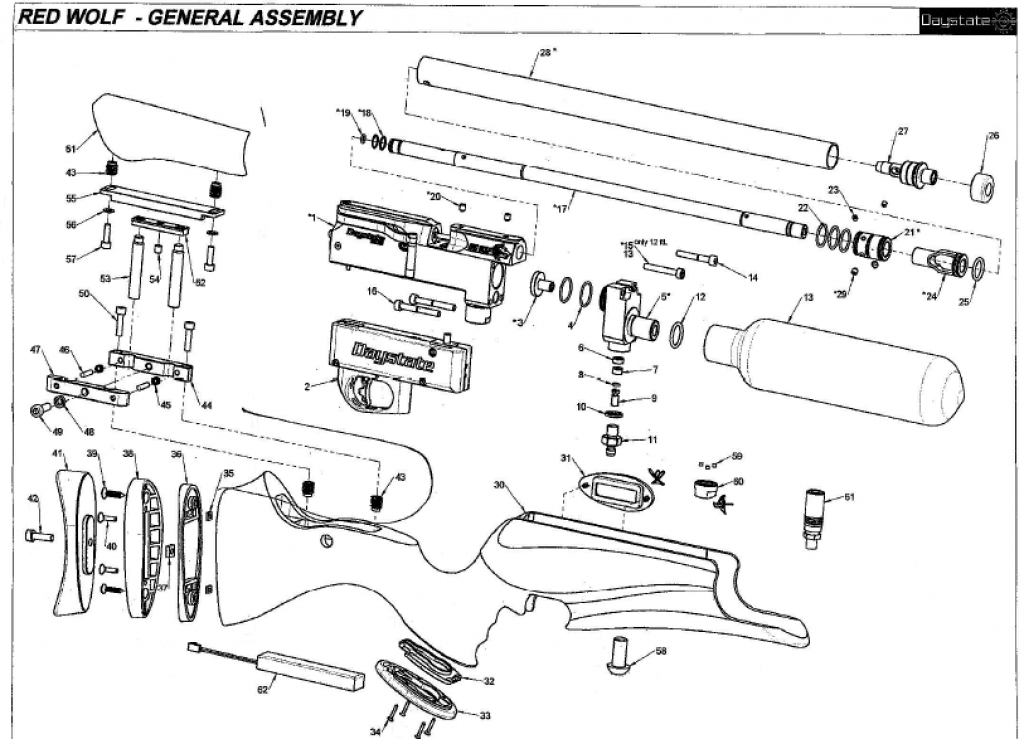

The most common loss of velocity source AFTER the breech oring is the valve stem oring. The chart and drawing don't match from what I see. It's possible to change the valve body and stem orings without removing the rear safety block and trigger block, which I would say are best left to an experienced tech but with care .... is doable. You didn't say what vintage it is but at 16k shots, the valve stem oring seems most likely the culprit. The vintage is somewhat important because DS has made some improvements intended to improve durability in the seals. One other important change was to get rid of the flat spring adjacent to the safety block. I replaced mine early on with an appropriate sized oring to give constant tension, but not be susceptible to breaking as the flat spring does. DS has began doing that also, but not sure of the timeline . THAT will also cause a velocity loss..
If you feel confident enough to disassemble it and replace the valve stem oring, pm me and I can get you a description of the the simplest route through that. No special tools are required but great care IS required.

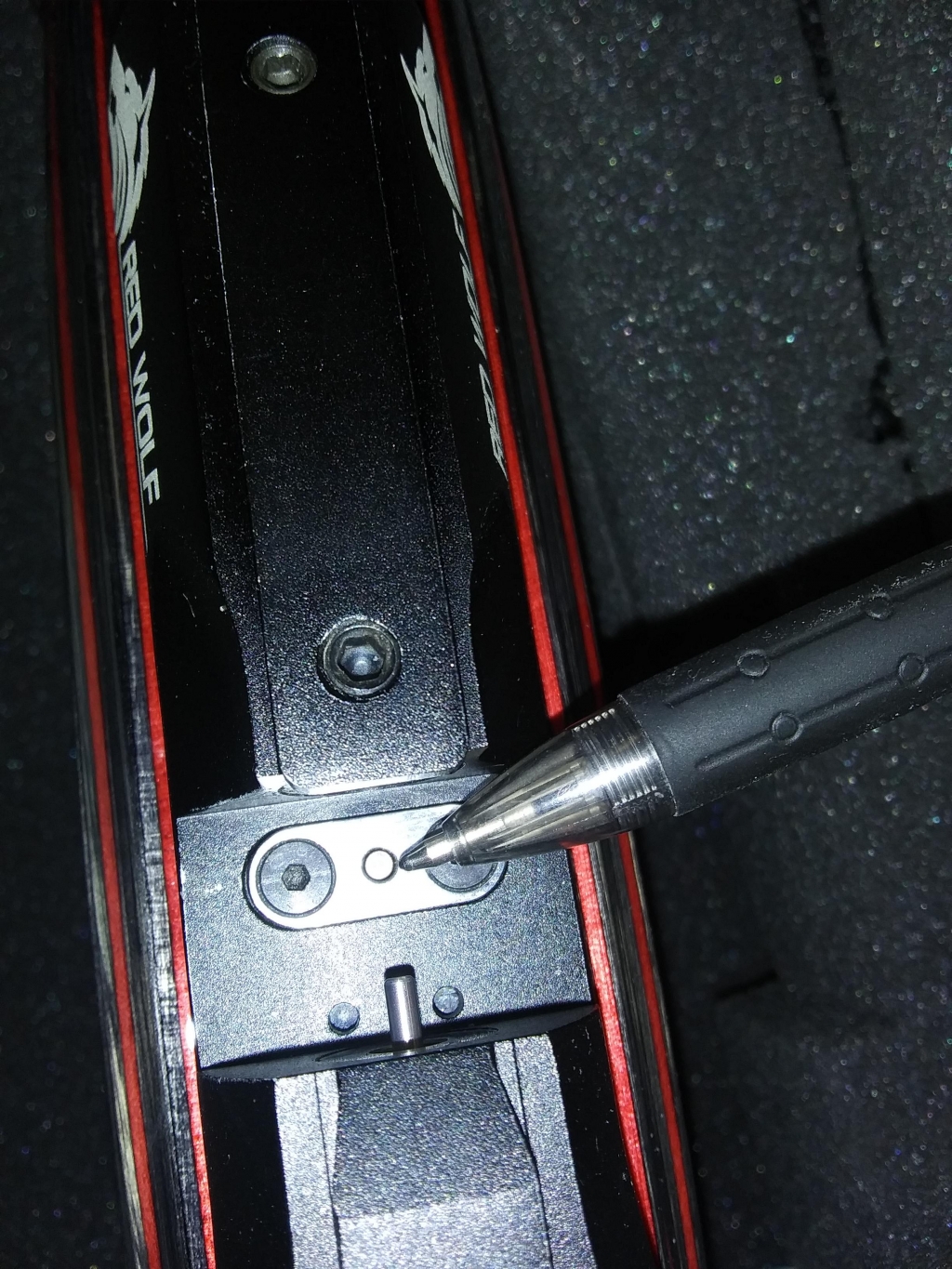

Actually want to clarify my flat spring didn’t actually break, the two machine screws on either side of action below safety block, one actually sheared off the other became loose, causing extreme velocity swings! I will not to get into why, but arzrover will know! When I contacted AoA they told me exactly what to look for, that’s why AoA, Daystate, and the shooters they trust to test and give honest feedback for future improvements etc. are a awesome team to do business with!
