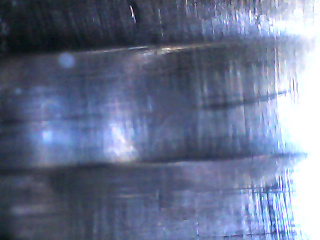

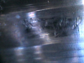

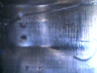

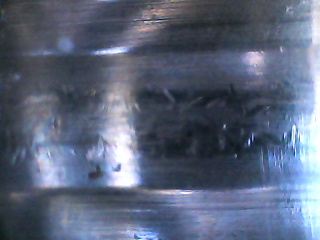

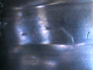

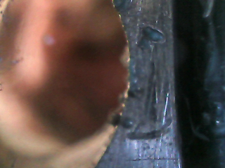

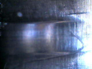

Update. Got it back from AOA last week. All they did was polish with JB borepaste. Did nothing at all. Sent targets shot a 20 yards. Said was one of better RedWolfs have seen. Pictures are the same as the ones above. Did manage 1 group at 50 yds that was.898 ctcs. Not good enough. Have contacted Daystate UK. Email this morning said was calling AOA today. See what happens now.What pellet was the program set for from the factory? There seems to be an assumption that it is the 25.39 redesign. Mine came set for the Monster Beast 33.95. I didn't look until I couldn't get a decent group at 50 yards. The card that came from Daystate had 33.95 Beast at 925 fps. I obtained a tin and had the advertised velocity. Still wouldn't group better than 1 1/4 to 1 1/2 at 50 yards. I pulled the barrel and inspected the barrel. Transfer port seemed to have burrs. The breech area had chatter marks and and scoring in several places. Two of the grooves had severe distortion. My conclusion is that I didn't win the barrel lottery. Sent it back to AOA. Still there. Heard that they are trying to work on the barrel. Sorry guys you can not fix a bad barrel. I have pictures of the inside.
