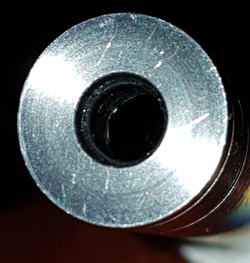

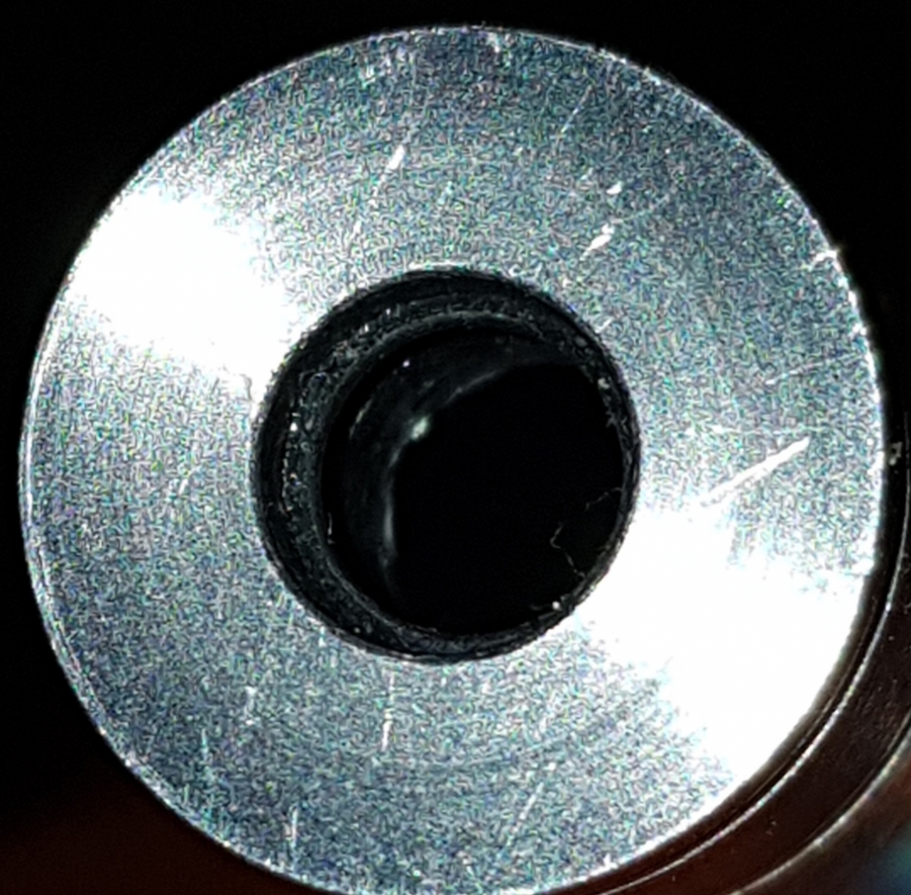

I am assuming the targets were shot at 50 yards/meters. I suggest you do all remaining set up using only the HP setting, and the 25 gr redesigned pellet. That will eliminate variables, and it's almost certain to be the best pellet anyway. I think there may be an O ring or electronic issue that is causing a 30 fps ES. But, I believe the most common fault is with the barrel, and I would concentrate on that first, try to eliminate it as a variable. A fouled barrel can cause enormous accuracy problems, and these poly barrels and high velocity are noted for it. Remove the barrel and breech O ring, and then scrub the barrel well with a brush and some type lead solvent, Ballistol should work. Scrub from the breech to aoid any damage to the crown. While the barrel is off, look closely at the muzzle crown and the air port at the breech, both should be smooth. The original barrel on my RW had a small burr at the port that was causing pellet damage and accuracy problems.

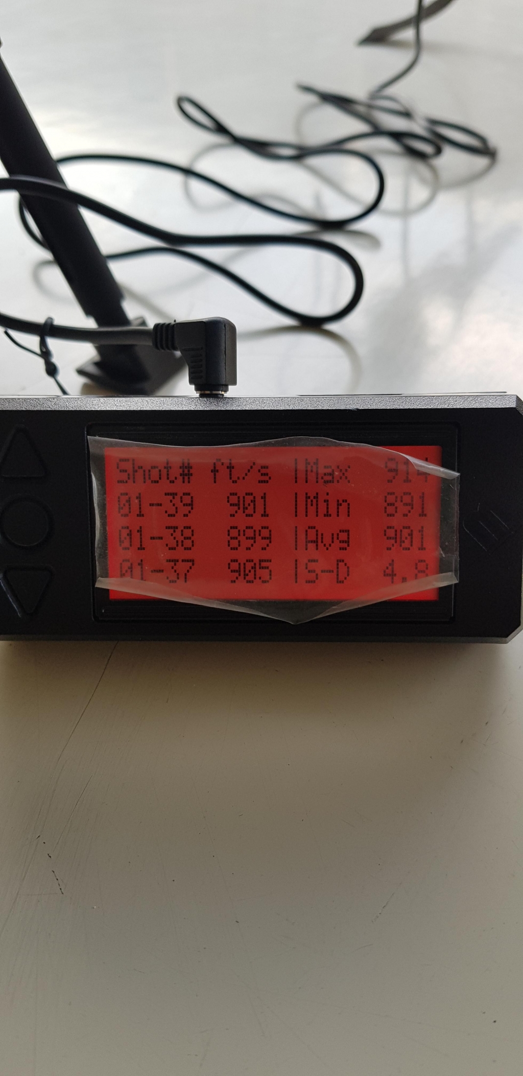

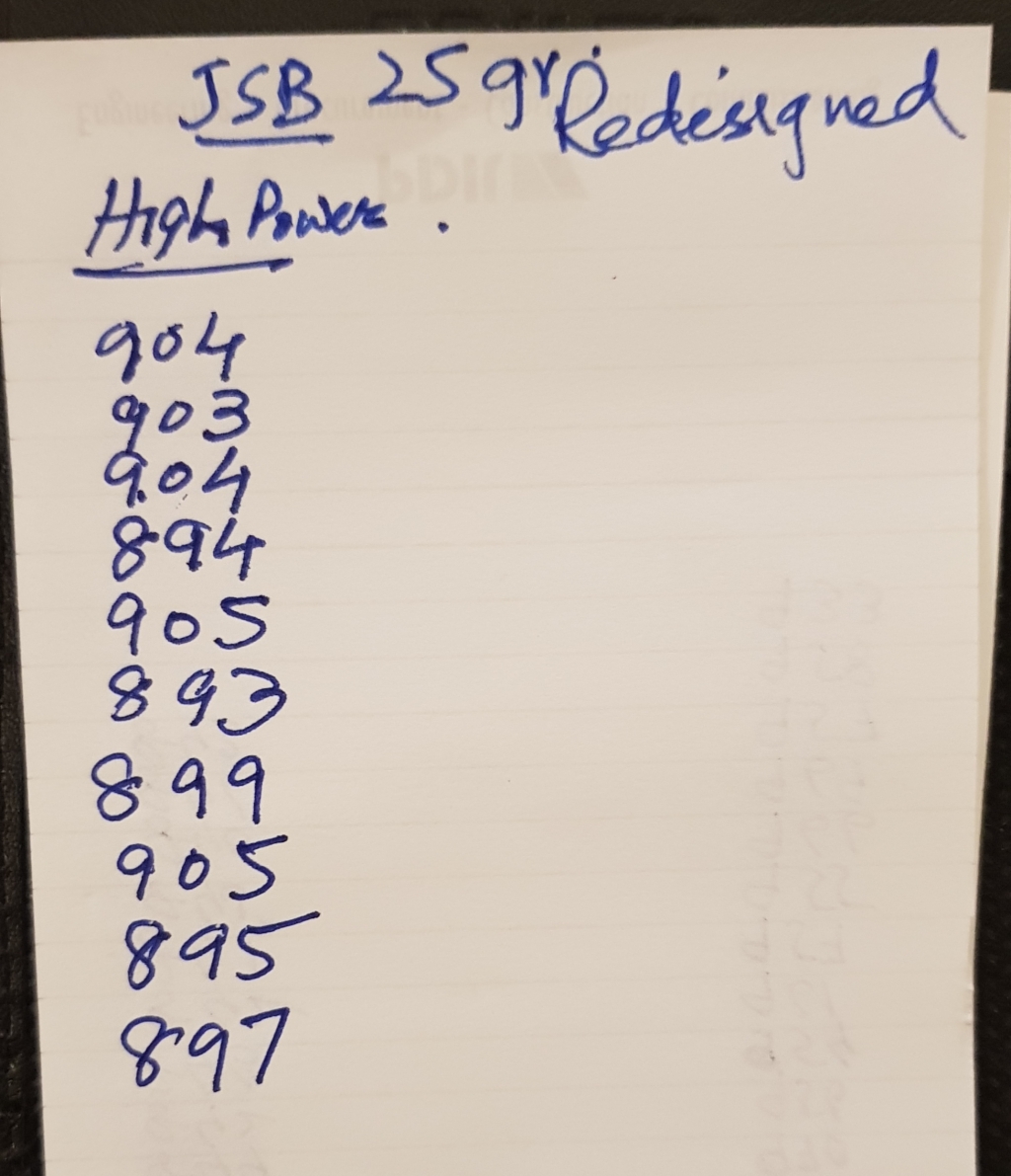

Attached are my two targets and velocity data with JSB pellets 5.5mm using25 grains redesigned at 50 meters using new barrel which was sent by Daystate.
Using at hi power maximum velocity was 914 fps and minimum was 891 fps in 40 rounds. Can this gun be further tunned or pellets need to be replaced.
Do you suggest Heliboard can further increase accuracy
