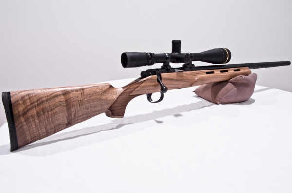

It is FAR FAR less effected by wind and drag. On a calm day the airgun has a good chance of equaling or exceeding the accuracy of the rimfire at 50 and inside 50. The further out you go the Rimfire will likely take over depending on the gun itself and shooters skill. Now all of this depends on the Rimfire and its capabilities. For instance, the Rimfire pictured below ( Cooper Model 57M) will group .25 of an inch at 50 yards with Wolf target ammo, regularly, even in slight wind. It sports a Figured French walnut stock, Heavy fluted barrel, pillar bedded and glassed, with a Jard 2 ounce trigger. It is phenomenal off sand bags or a high end rest and will utterly shred a Daystate Red Wolf or FX Crown to pieces. The gun will set you back about 2600,00. This includes bases but no rings and no Jard Trigger. So you're up to 2800.00 - 2900.00 before optics. On a calm day the Airguns will hold their own and sometimes exceed, albeit splitting hairs. Introduce any variables at all, and the Rimfire will jump ahead by leaps and bounds, exponentially by orders of magnitude. On a good day Top quality airguns are shooting exceptionally well at 100 yards with a group size of 1.25 inches, and sometimes under 1 moa. The gun below,,,,,,,.7's and under, routinely with some exceptional .4' and 5's mixed in on good days and it's still carrying a velocity of about 940 fps and right at 80Foot pounds of energy at 100 yards.
Honestly I'm more into Airguns. No noise. less recoil. They are beautiful, especially the red wolf. I want one too. But as Rimfires go.......THIS. It is outstanding. It would be very hard for an Airgun to compete in overall inherent accuracy.
