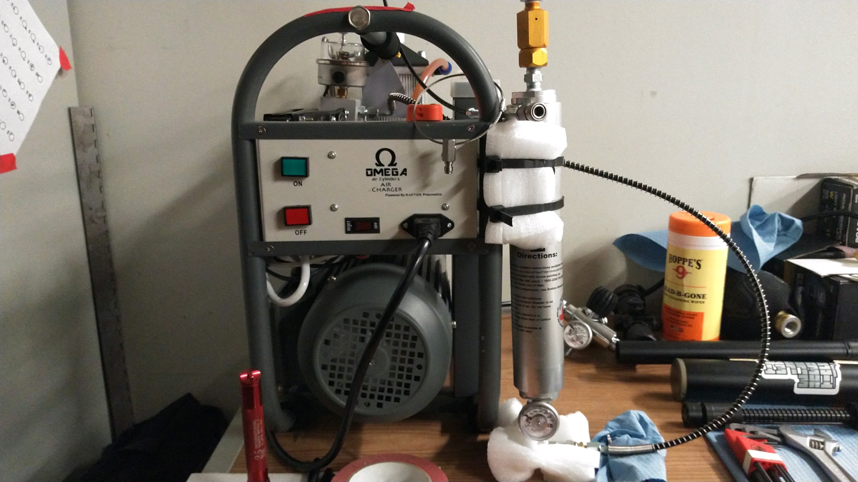

I have the Omega Air Charger also. Over 1 year and going strong. I fill (2) 75cu ft. tanks
about once per week. The tanks go down to 3000psi and it takes 20 min. to fill back to 4300psi
No problems but I also baby my stuff. Always run with a Joe B. filter.
No problems but I also baby my stuff. Always run with a Joe B. filter.View attachment 310003
