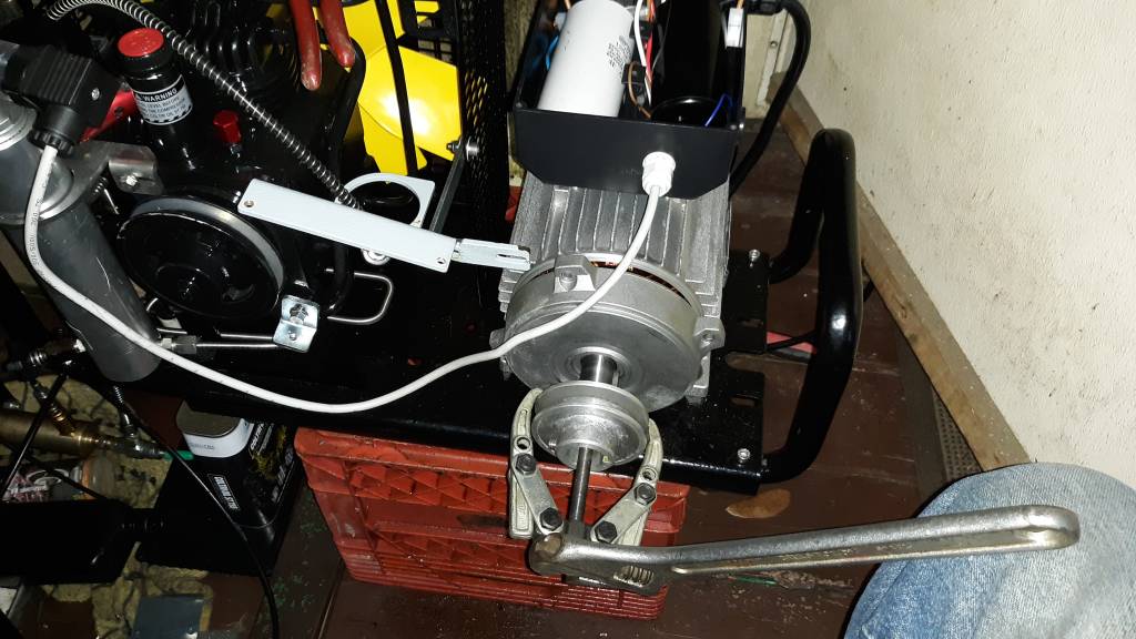

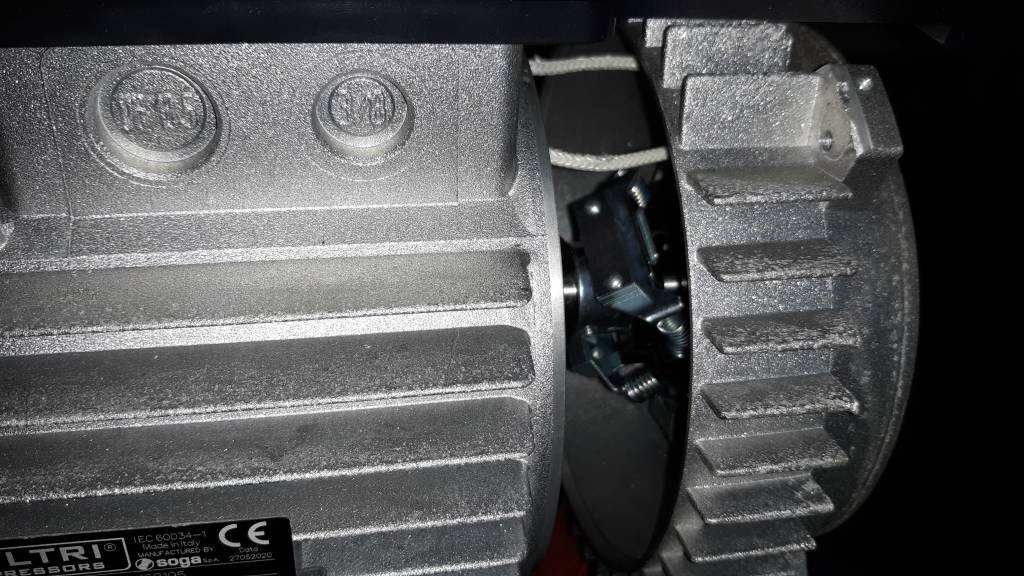

UPDATE !!!! So the motor failed on my LC110. Was running fine, then on one start, hummed bad, still ran, but quickly blew a 15 amp breaker. After much reading, and testing, I sorted it out to the "START" circuit. When I disconnected the "START" capacitor, the motor would start, and run, even under load, and only draw 14.5 amps. This cold morning in SW Florida, I fired it up, just to warm it up some, and when I shut it off, I heard the "CLICK" that the starter circuit centrifugal switch makes. It had NOT been making that noise after the failure. Soooo I re-connected the START capacitor, and she's back to like new. I assume the START switch was stuck closed, which was my original suspicion. So this motor does have the more standard mechanical switch for the START circuit. And once again, I'm a happy boy.😂

At the moment, I'm in the slow process of tearing the defective motor down, just to see what's what. Upon opening one end cap, I got the dreaded burnt wire smell. So it's now more or less an "autopsy" Ha! Just for giggles, I'll post some pics, if/when I find the problem. New motor waiting to mount up. Cost $99, so cheaper than shipping for warranty, and much less hassle.

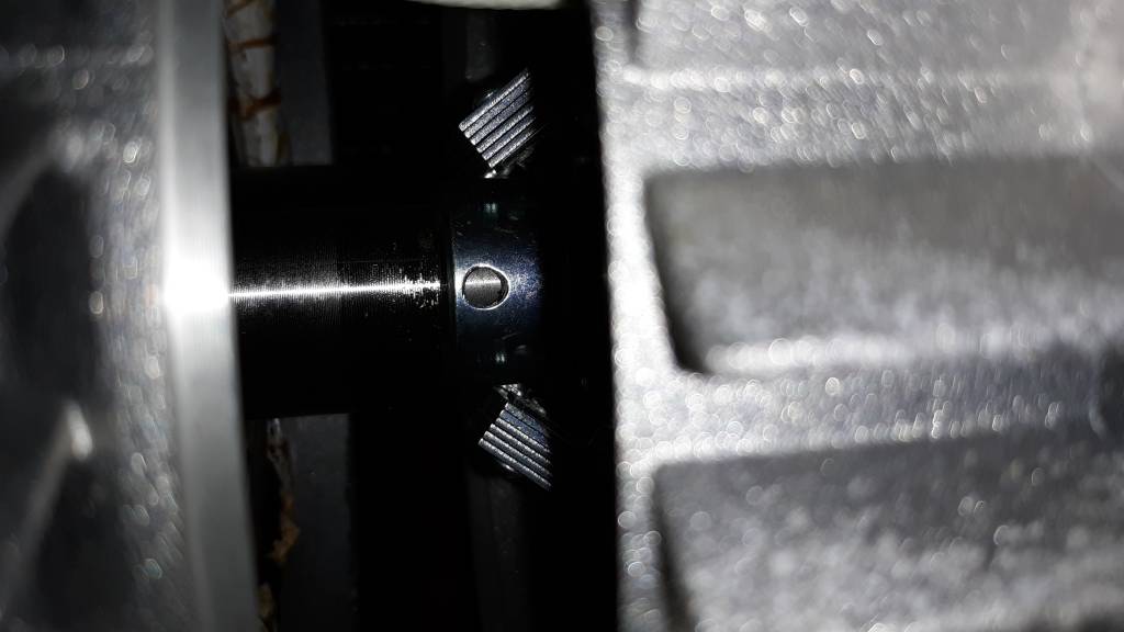

Update !!! Tore the stock motor down. Found a set screw that holds the centrifugal weights ( what opens and closes the start circuit) to the armature, had fallen out. Reinstalled, assembled motor, and all is well. It did get a little hot from trying to run with both the start and run circuits going at the same time, but I don't think it hurt it. Pulls only 4 amp unloaded, and 11.5 - 14 full load 4500psi So, I learnt me something today!
