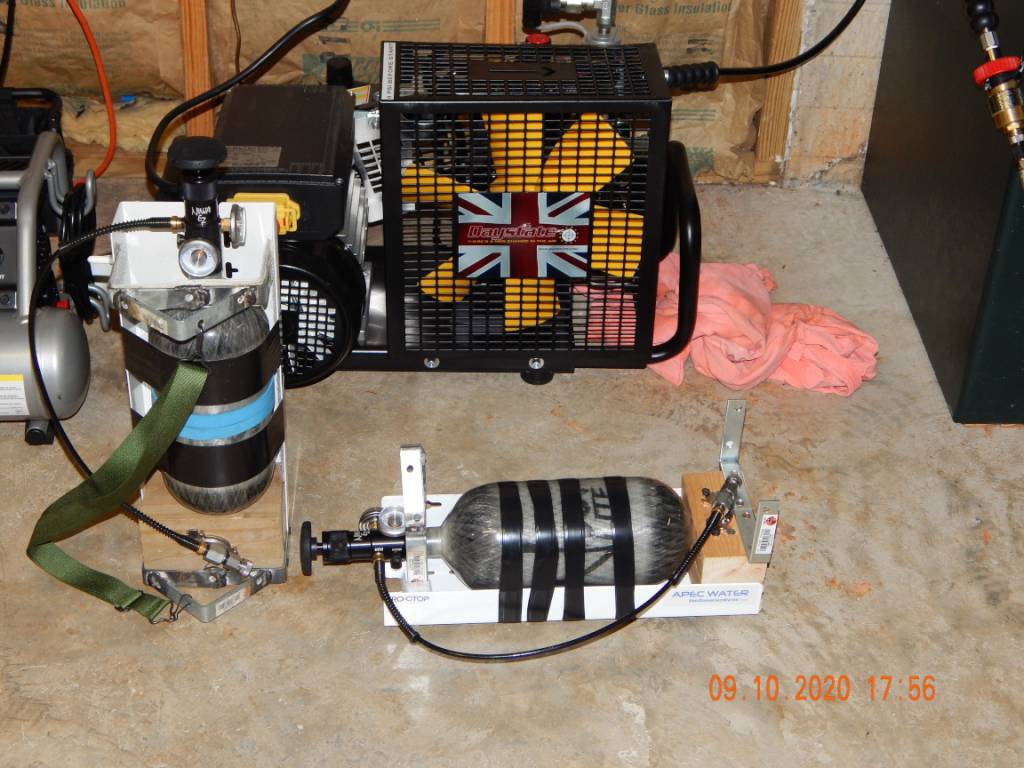

Hi all, not sure there is any significance, but I at least wanted to share. This is how my condensate/coalescing tower looks after 12 hours of use. My use is 2 minutes of run time, 5 minutes or less of top-off of a 90cu-in tank, 2 minutes cool down. The following day the compressor is run for 2 minutes to blow out any collected moisture. Oil was changed at 5 hours and will be changed again at 15 hours. I have/will only use Coltri CE-750. What looks like "particles" is actually bubbles both large and small because the compressor was ran before this image was taken.
The setup, in my conditioned basement, on the unfinished side -- I gave my father one of the Ninja 90 cu-in tanks (the one laying flat):
