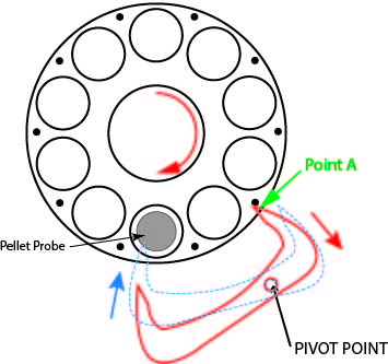

Below is a diagram I made to demonstrate what is occurring with the magazine:
Bottom line, check your pellet probe for damage while in warranty.

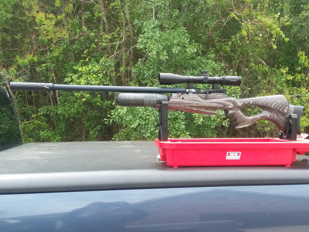

So my first outing with the Wolverine was today. Nice weather except for more wind than I like for shooting a pellet gun. Anyway I leveled the gun, then leveled the scope and tightened everything down. The Bushnell Engage 4-16X44 is very crisp and clear. I used UTG high ring mounts and like those as well. 2 shots and I'm bullseye at 25. (Got Lucky) I then move over to the 50 yard range which is more open to the wind. The gun is accurate but I honestly believe it will do better with no wind. I only have one brand pellet- JSB Diabolo Exact 25.39. I did not measure groups but I could bing a squirrel in the head at 50 yards.
