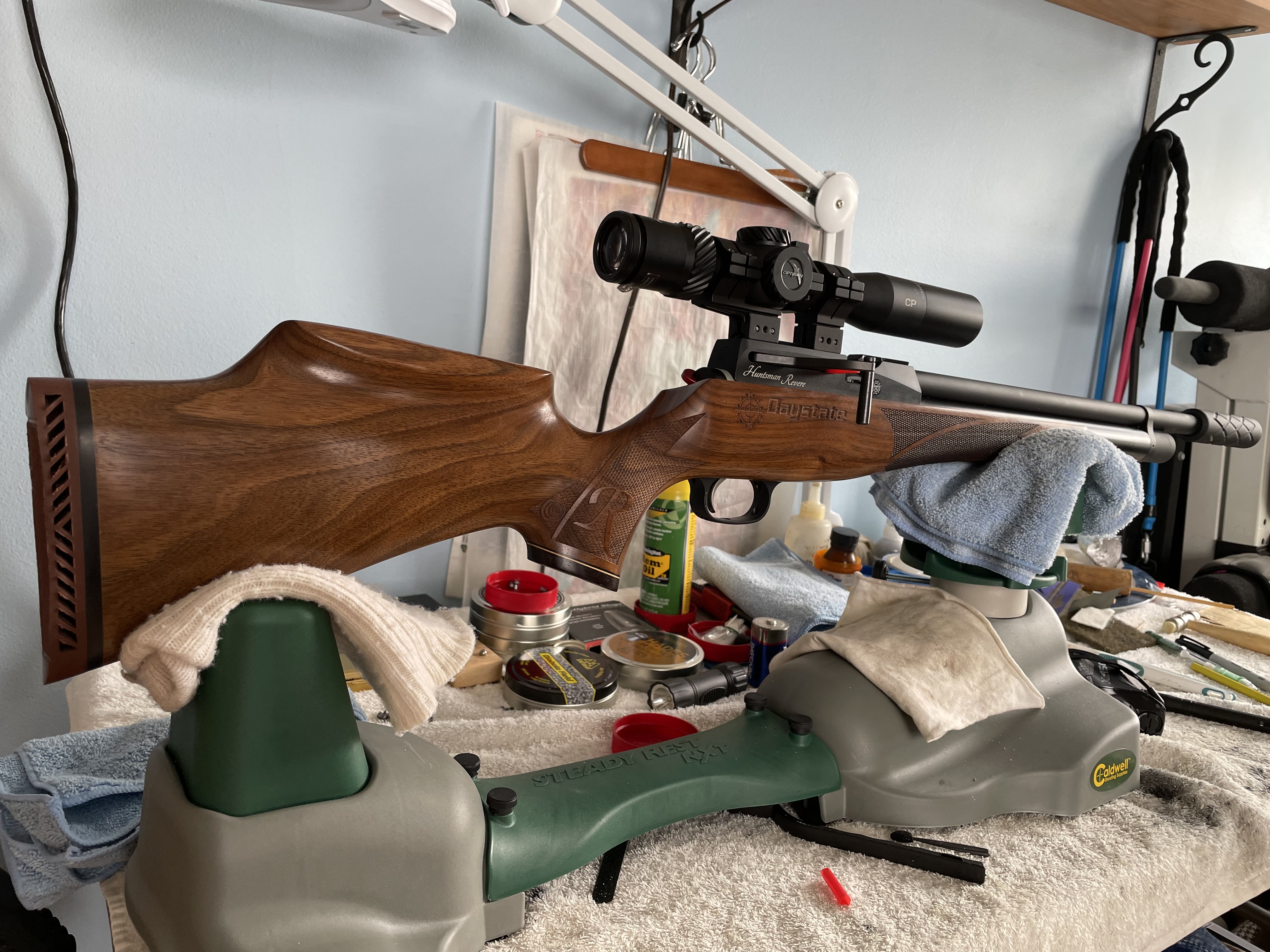

After getting my 22 Revere a few months ago I’ve hand-rubber etc five coats of Parker Hale walnut oil to bring out the wood’s color and detail, then applied two coats of carnauba wax to seal it up.
No white residue, although I took care to keep both the oil and wax out of the magnificent checkering. Tedious work with slight errors removed with a toothbrush as I went. I used Lundmark Clear, almost pure carnauba wax that only left “white residue “ in the tiniest of nooks that was easily removed with the toothbrush. It’s beautiful to me with the look now preserved and all protected from the elements.
There was more I did to refine the fine details to finish the perfection of Daystat’s work, which I’ve not read of anywhere so it’s just my OCD at work.
