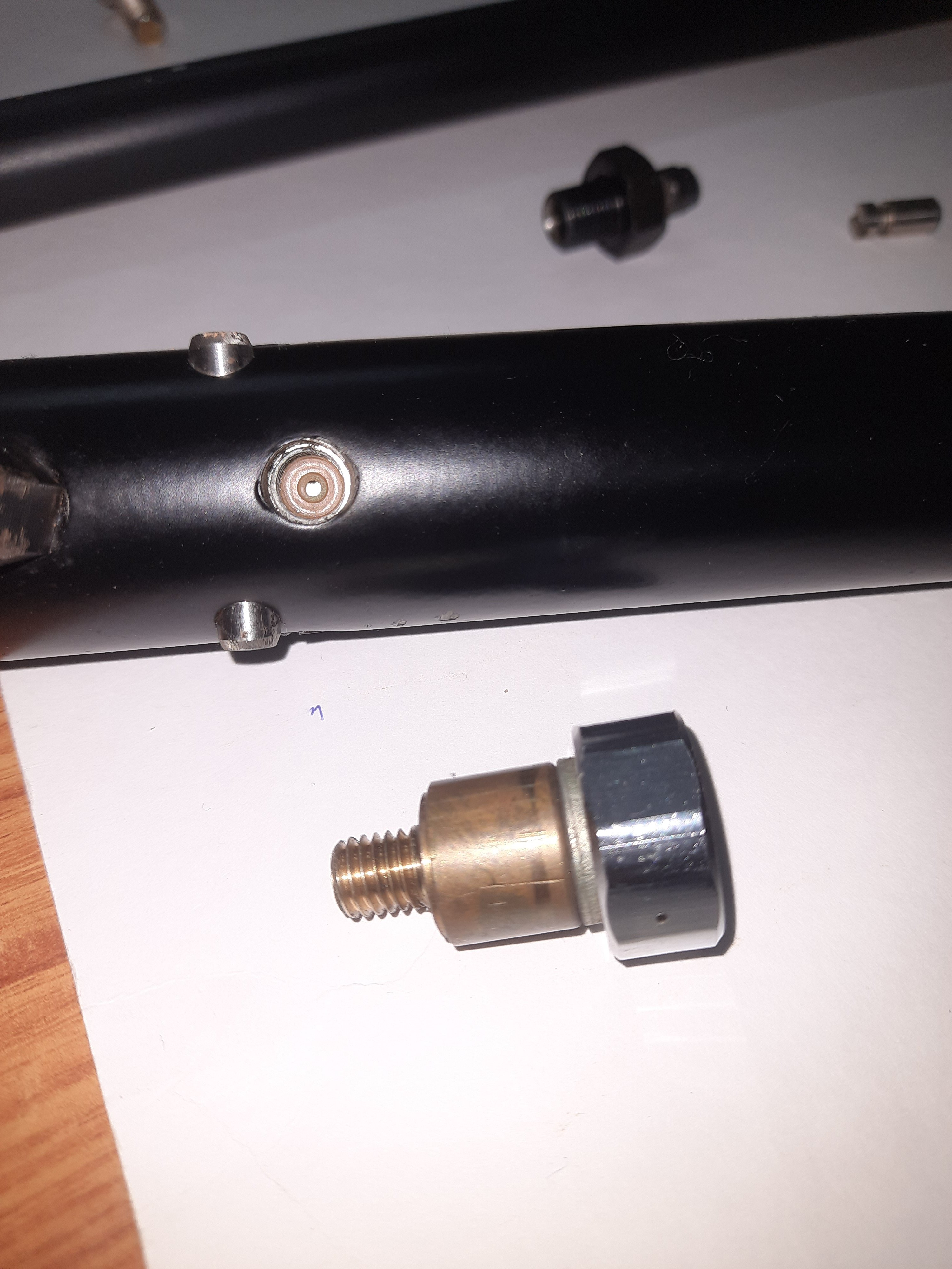

Do i have to remove the top body cover to merely the barrel support bands to finally free the fill probe or valve and then check IT for any o ring damage etc.my pcp is leaking from the fill probe only

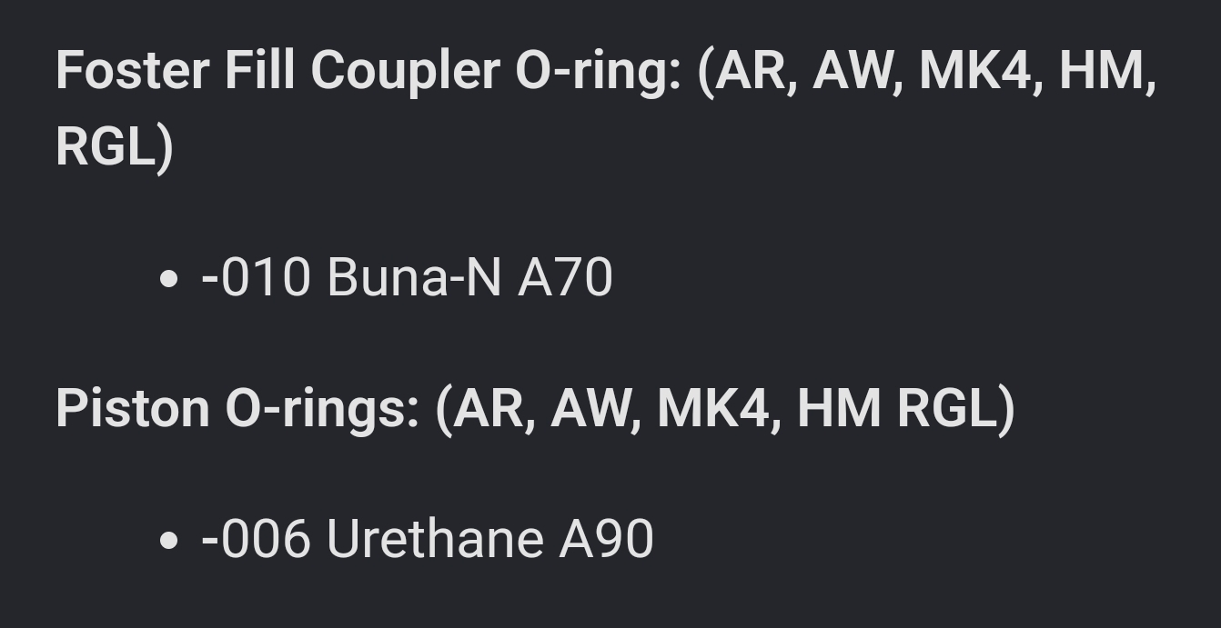

There might be 3 sizes of o-rings which might be damaged. I would just get all three or better yet, just get the repair kit because they have the dowty seals.1.Foster Fill Coupler O-ring: (AR, AW, MK4, HM, RGL)
- -010 Buna-N A70
2. FAC Valve Stem O-rings: (AR, AW, MK4, HM, RGL)
- -007 Buna-N A70
Are any of these two o rings refereed above the ones inside that fill port male probe?any idea?MH would mean Huntsman..am i right?

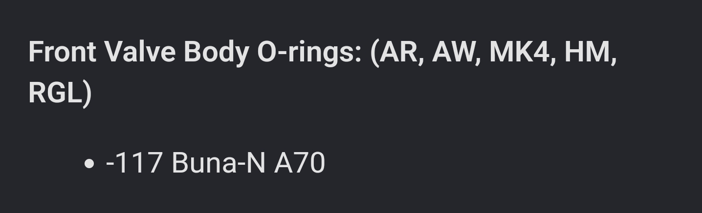

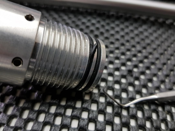

I can only assume those are the correct sizes going off the old o-ring list I posted. O-rings are cheap. It doesn't hurt to pick up a few. Did you try getting a hold of AoA for an o-ring repair kit? You could also try another Daystate dealer in your area.Valve Housing Group Assembly ..the 2 orings shown in this photo(1 of which was bad)..are these size 117?anyone who can confirm

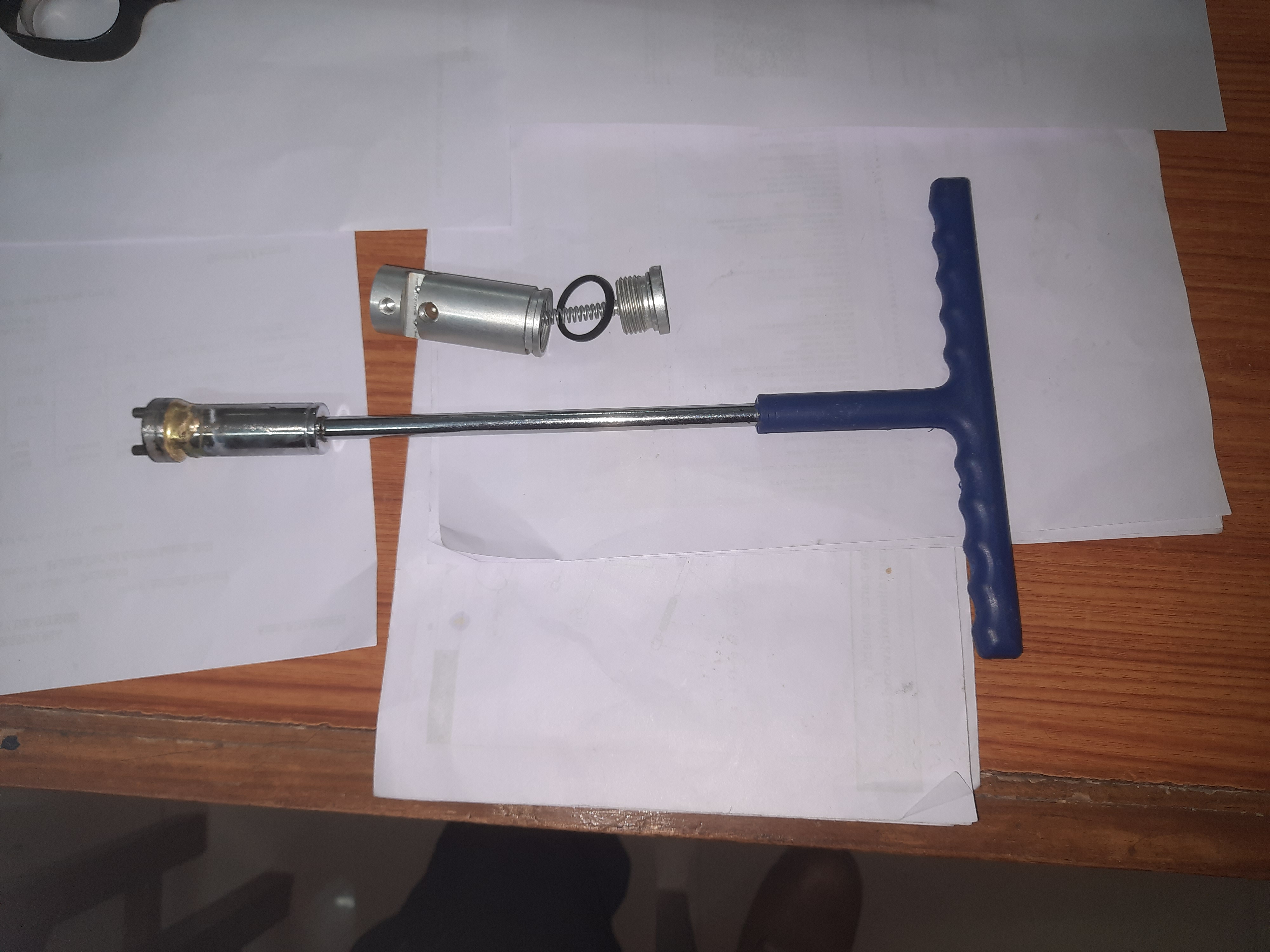

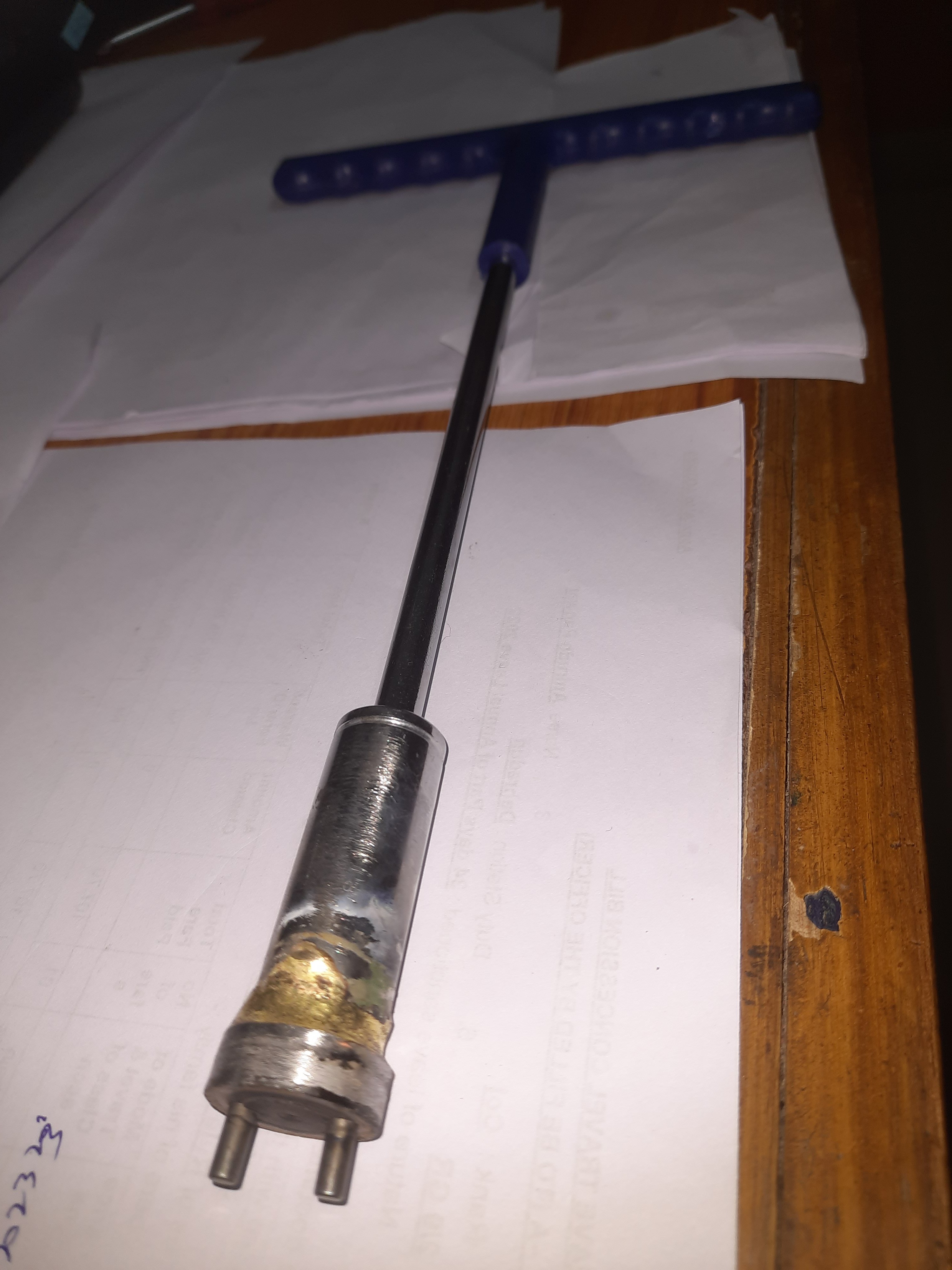

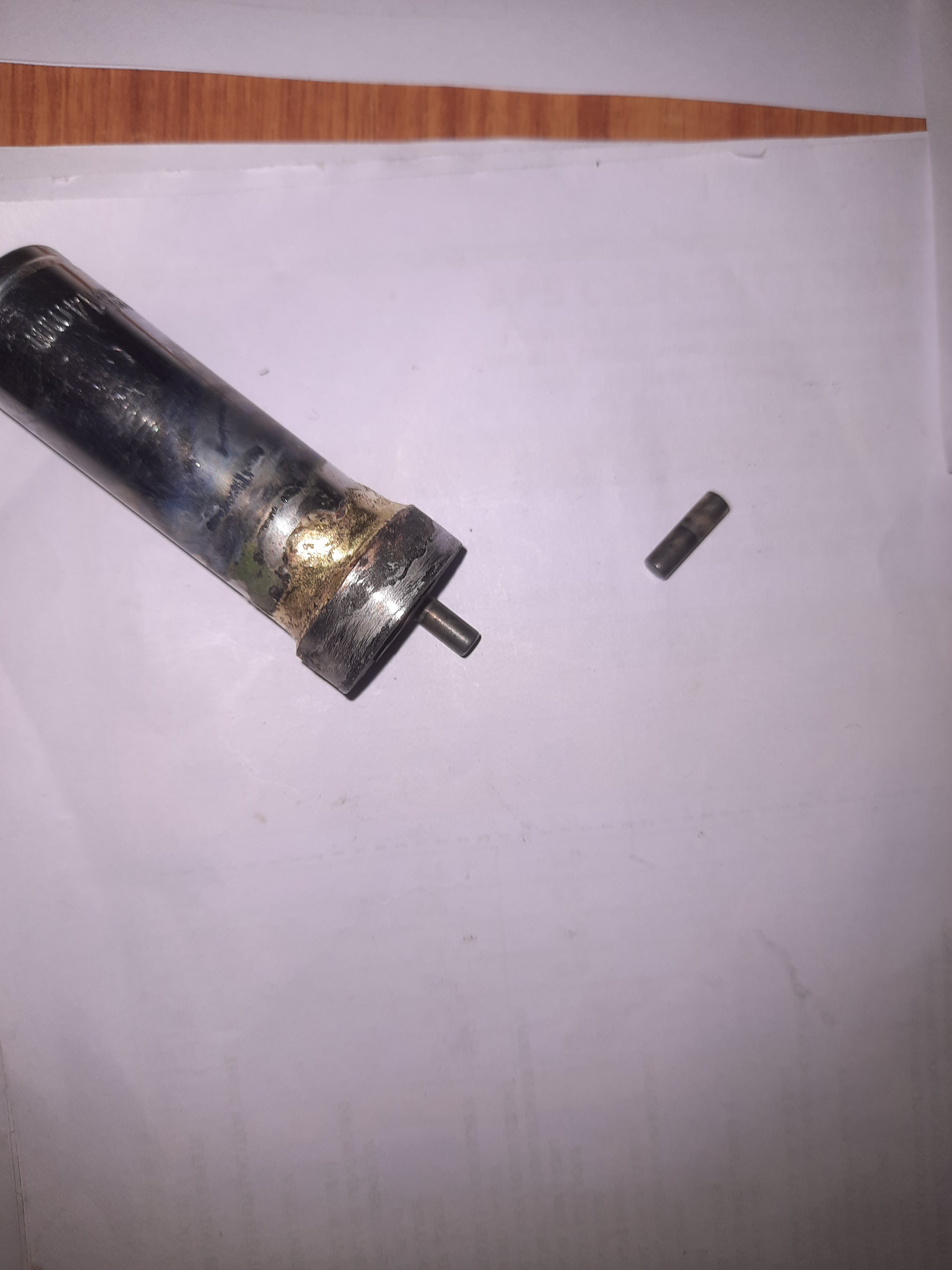

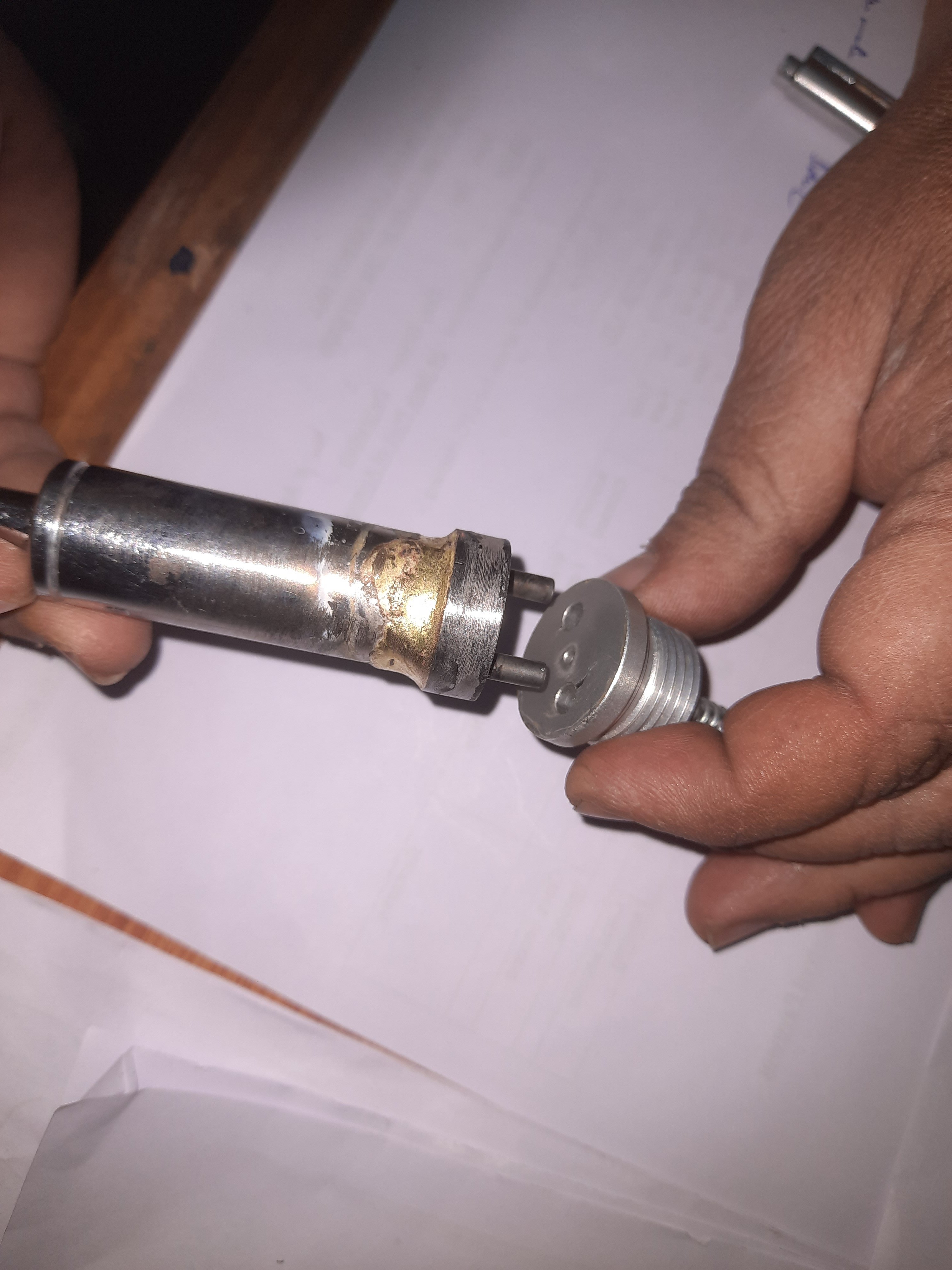

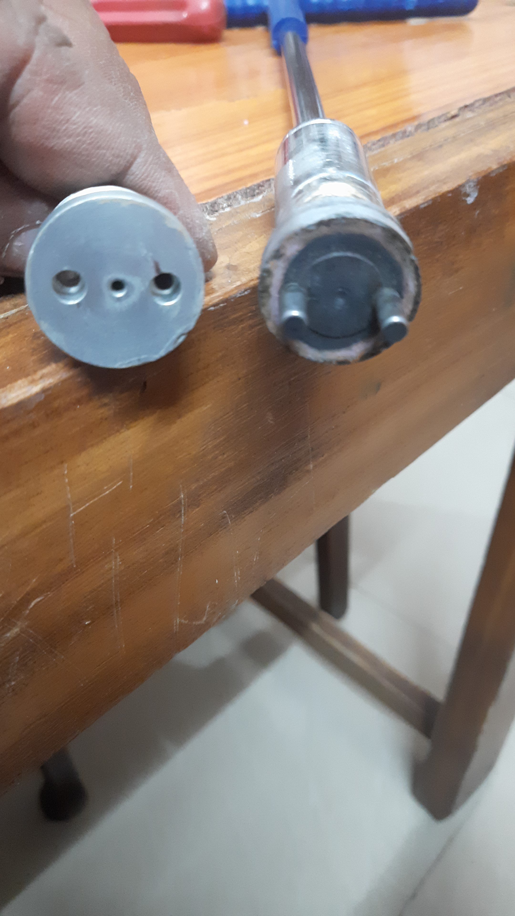

got o rings from some dealers etc...also today only was finally able to remove the internal valve assy using a special tool which i had to get made...both visible in attached photosI can only assume those are the correct sizes going off the old o-ring list I posted. O-rings are cheap. It doesn't hurt to pick up a few. Did you try getting a hold of AoA for an o-ring repair kit? You could also try another Daystate dealer in your area.
