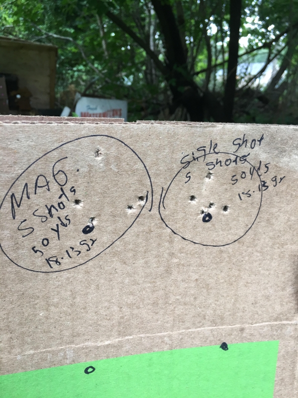

I tried the 18.13 gr at 50 yards with and without magazine and it seems that it only likes the 15.89 s
Was this the first time you tried shooting the 18.13gr? Just because my barrel on my Huntsman likes both 18.13gr and 15.89gr JSBs' almost equally well, it doesn't mean that yours will. That's just the way it is sometimes. Although generally, they should be very close.
Are you cleaning the barrel too often? The only time I would clean the barrel is on a new rifle and if my groups start opening up after I have been shooting the same pellet for awhile without any changes made. You also might want to try different batches of JSB 18.13gr. Try some Air Arms, FX, and Daystate Sovereigns 18gr. They are all rebranded JSBs'.
No, it was shooting both almost the same, but it was shooting at 870s.. Now that it came back from AOA it's shooting 830s and only likes the 15.89. I did clean the barrel but since then I already shoot like 500 rounds..I'm going to remplace the pellet probe o'ring when I get one..maybe that's my problem, also want to use the scope cam and record a few shots in slow motion to see if it's not clipping the pellets..

To me, I think it's fine without a regulator. I haven't given it much thought about installing one because I can live with 30-35 FPS Extreme Spread filling to 210 BAR and shooting down to 135 BAR with JSB 18.13gr at 850 FPS. I've seen other reviews of the Regal Huma Regulated version and in regards to accuracy, my non-regulated Regal can keep up. I get dime size 5 shot groups at 50 yards with mine. I believe with the new Regal HR, you'll get a higher shot count (45-50) but at a lower speed.
