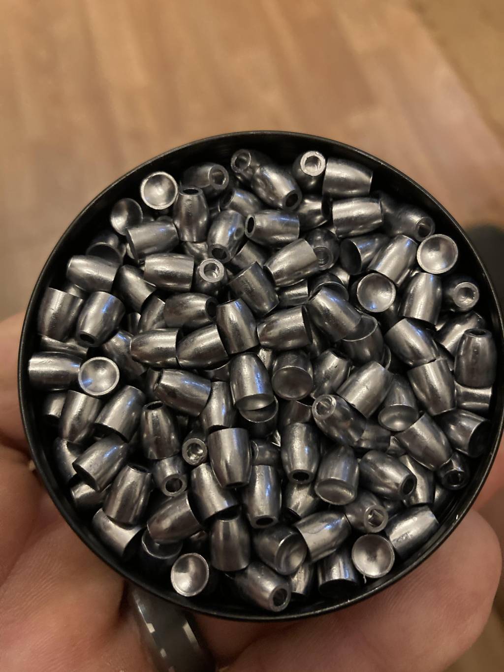

I'm not sure of the difference exactly, but they are ever so slightly heavier, maybe due to a shallower "dish" at the rear, but its hard to tell when side by side. I think @arzrover (Bobby C) may have a much better idea as a part of the Daystate A.R.T. research team... I do know they like speeds from 950 to 1000 FPS , which is all I've tried out of both my Bleu Wolf and EDgun R3 Long. They could like faster or slower, but they group as well as the JSB .217 KOs in the Bleu Wolf, which is inside MOA for five out of six 5 shot groups...
