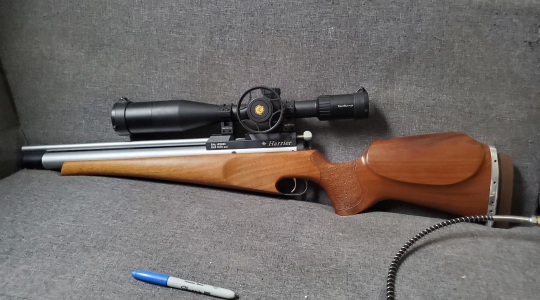

Hi every one, I have a gorgeous Daystate Harrier SE in .177 cal. The question is, can it be regulated? And how? 🤙🤘
