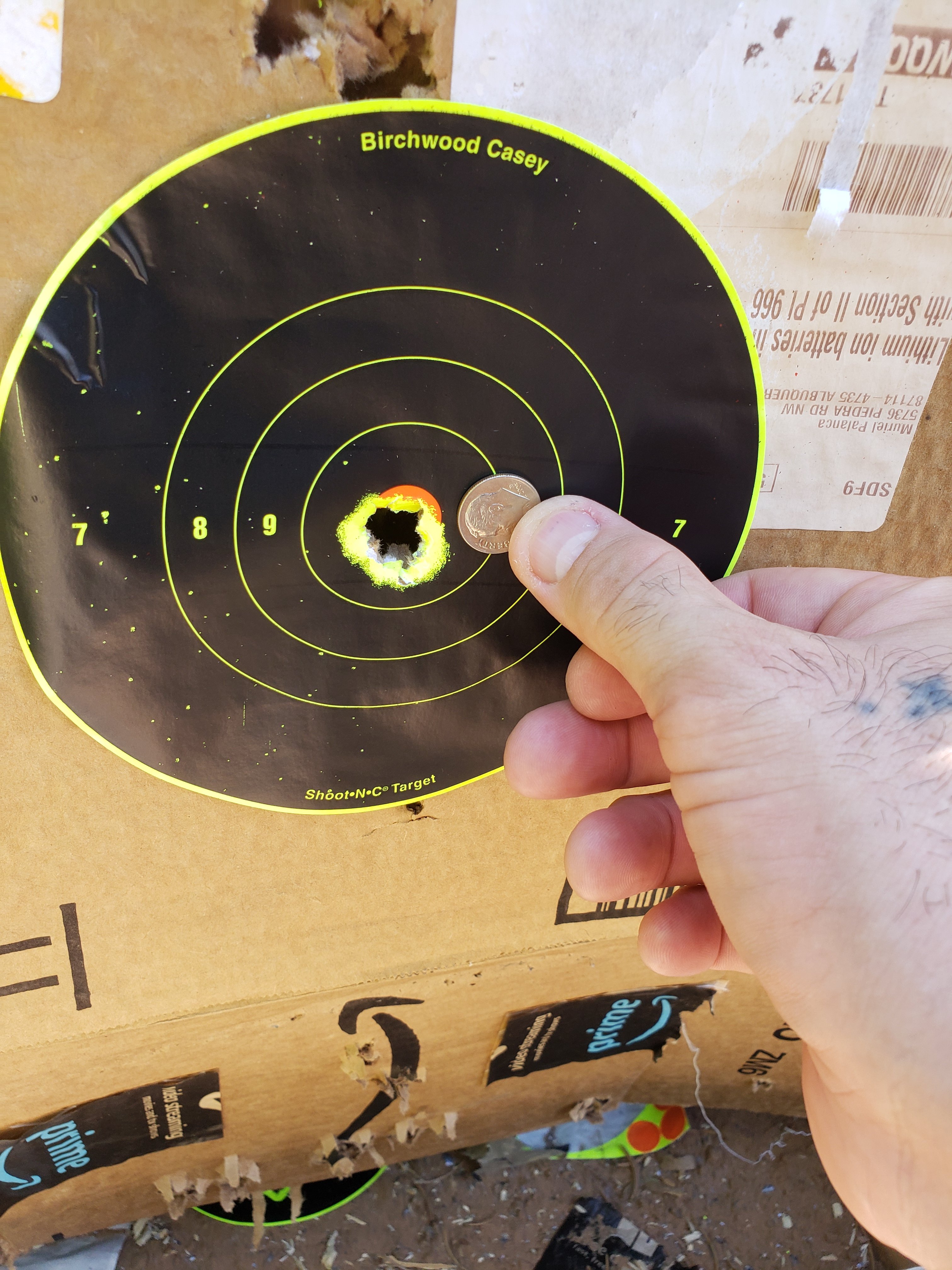

Guys, just so Im not going crazy, what group size would you consider acceptable at 30yds for a quality PCP?
Acceptable accuracy @ 30 yards for even a 300 dollar gun while well supported should be a single hole no wider than 2 pellets for 177 or 22 and 1.5 pellet for larger calibers like 25 or 30 accounting for user input error.

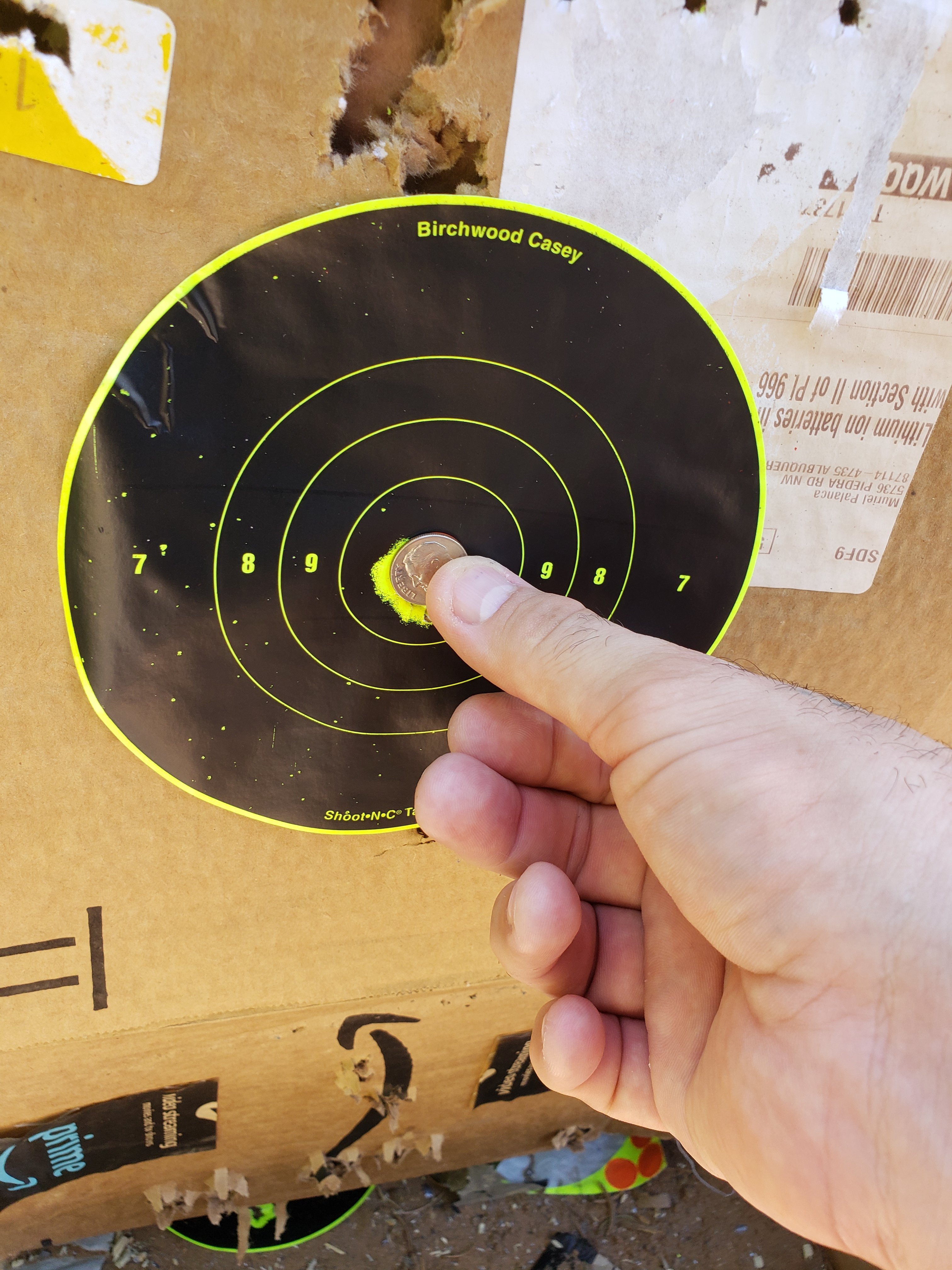

For the price of these higher end PCP's I want boring accuracy out of my 2k+ gun. Here is a 30 yard group from my Impact M3 30 cal from last week. This is a 2 mag group, so 46 shots. I would like to add though, that my M3 was not perfect out of the box either. It was double feeding after 8 shots and so I sent it back to FX, which they fixed and had back to me on the 9th day.
