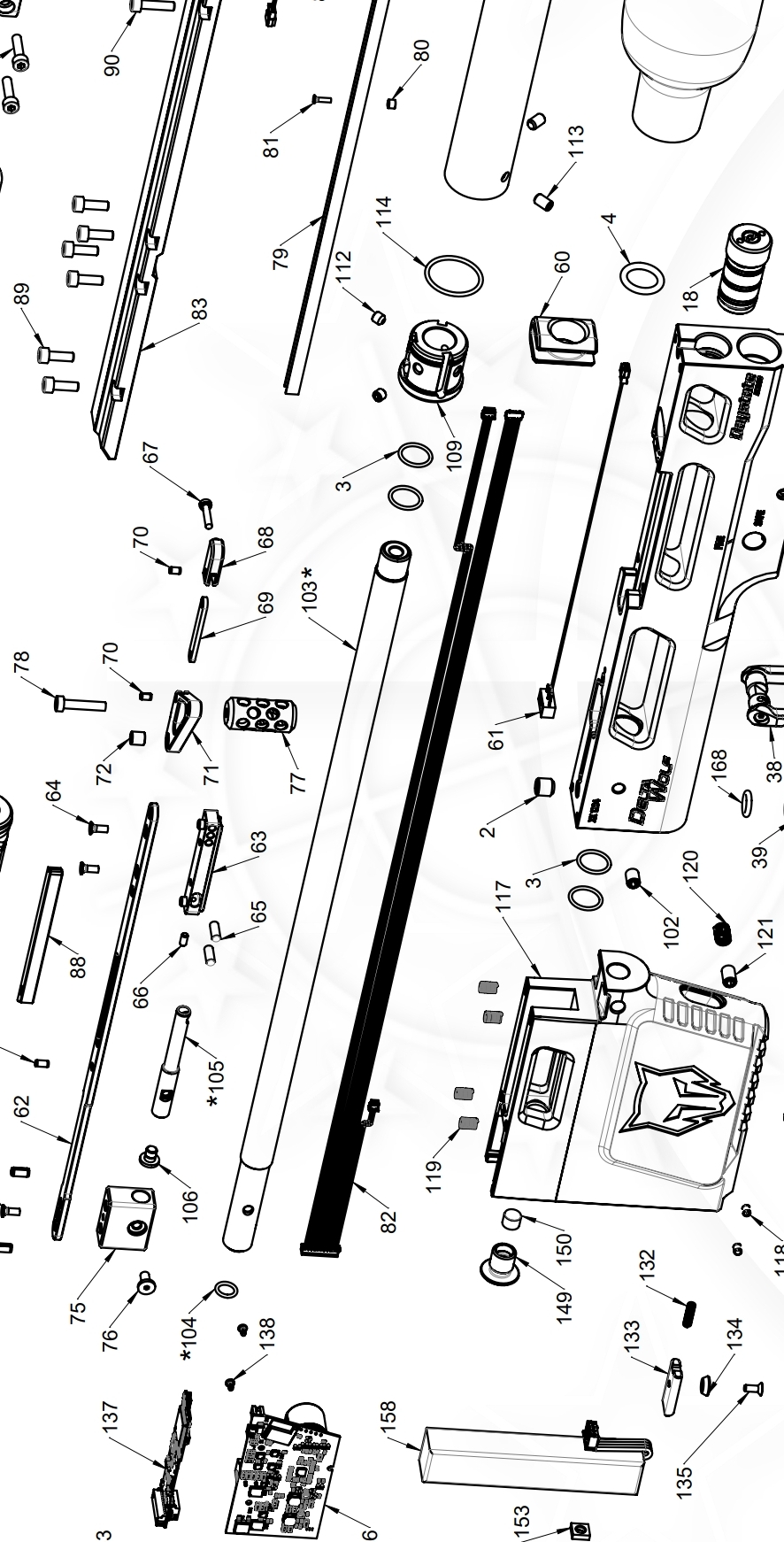

And yet the parts list shows 2 grub screws attaching barrel to shroud. Presumably easy to remove ?
From the schematic it would appear that the shroud and chrono can easily be separated from the barrel for bore cleaning.

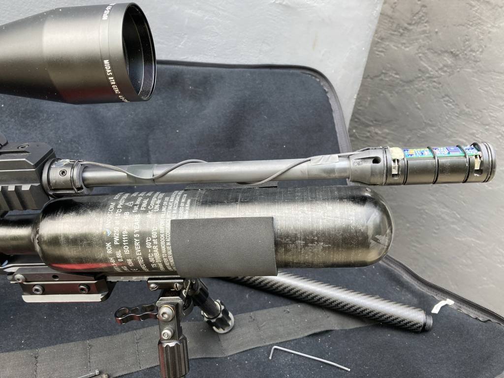

Remove the two grub screws at the back of the shroud.
Slide shroud off.

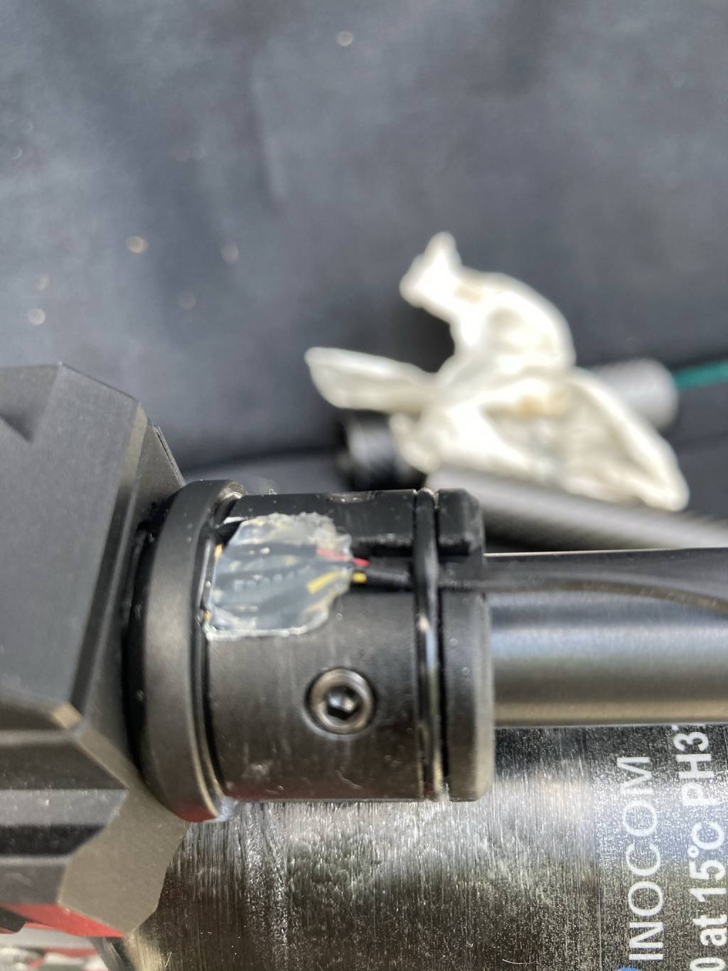

Loosen two grub screws from the shroud ring, the same part that the first screws came out of.

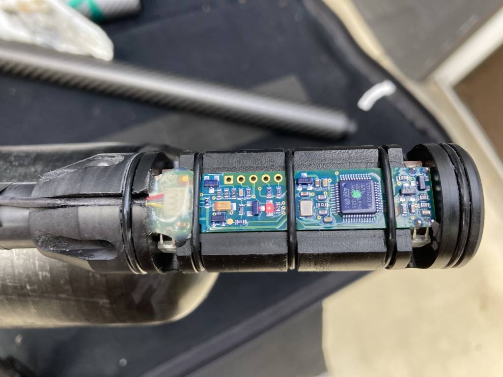

Unscrew the chronograph while at the same time turning the loosened shroud ring as they are connected by a wire.
Reassemble in reverse order but keep a slight space between shroud ring and gun. You will see the electrical connections. The slight gap, just enough to see daylight , will keep prevent the gun from pushing down on the shroud.
Reactions: Stone02
Remove the two grub screws that hold on the shroud. The shroud then pulls off easily. The chrono unit can be removed. The same fitting that holds the shroud screws is held to the barrel with two more grub screws. This is the small connector that has wires running from it to the chrono. Once that small connector is loose you can unscrew the chrono unit and it will come off. Be careful with the wires. They are small gauge. When you reassemble after cleaning make sure you place the connector unit so it makes contact with the connectors on the breech (they are spring loaded) but not pushed tight against. Leave a business card thickness between the two.
