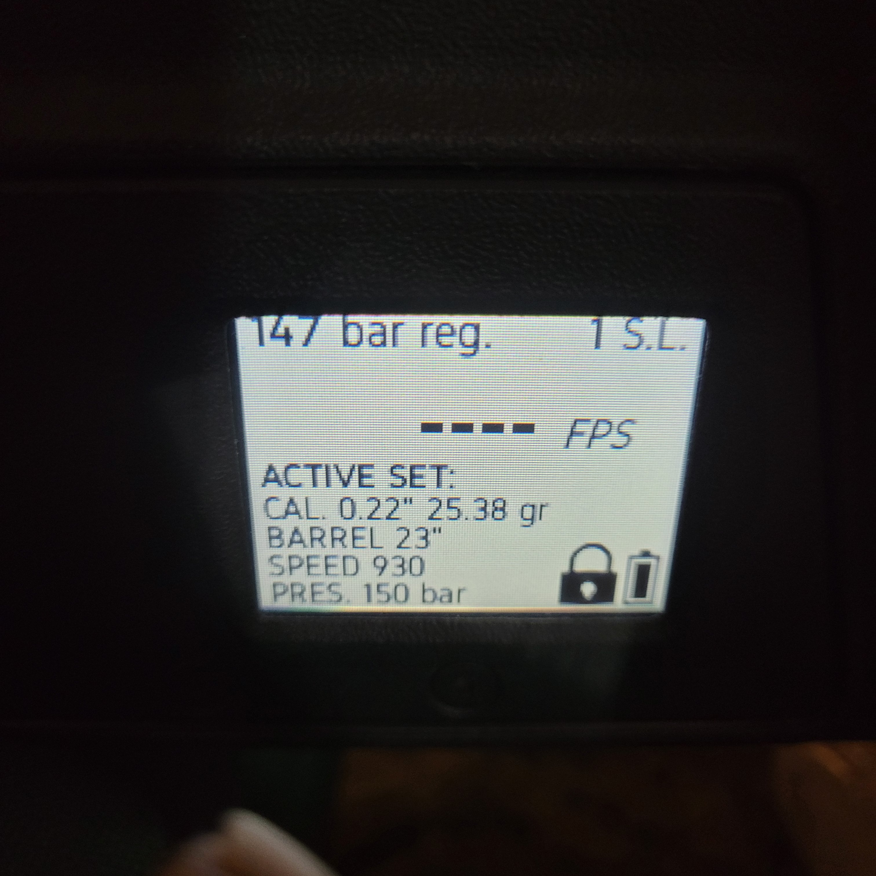

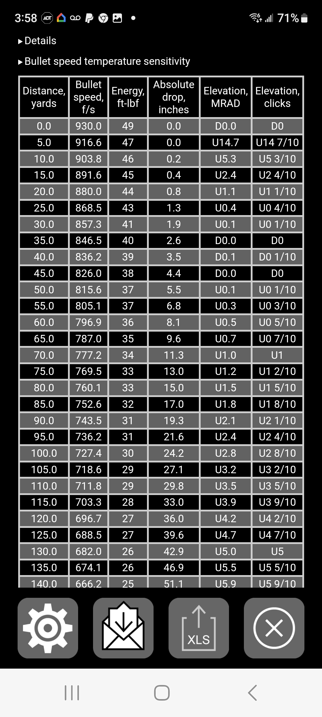

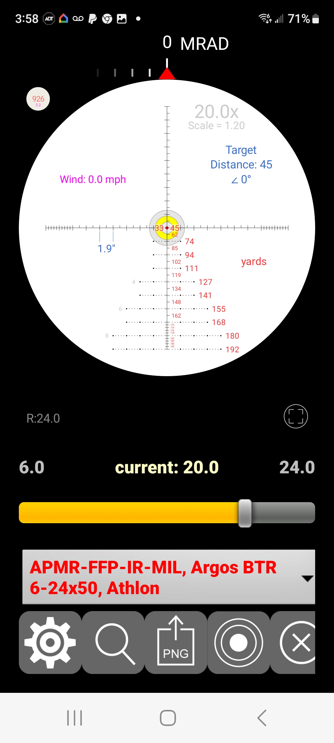

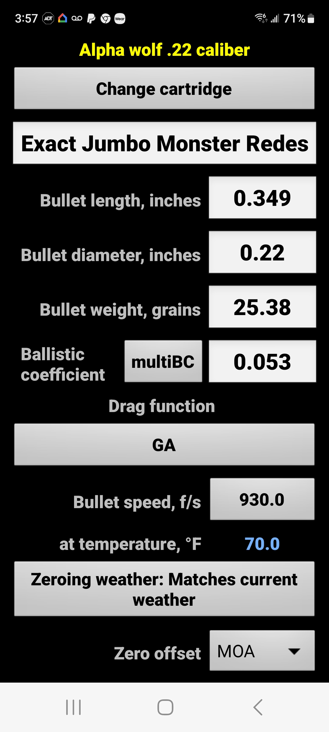

Curious if you tried this. Got factory mode and input your pellet wgt, speed, bbl lgt and set reg to 150/155 and take a few shots. Note reg pressure recommendations. Play with speed until accuracy obtained. Then transfer to advanced mode. Factory mode is fine but reg need to be set 5 bar above minimum pressure to achieve your speed. Do all testing in factory mode.my Alpha 22 tuned to shoot jsb 25.4 @ 930 .

You need more reg pressure. If pressure ie to low gun will search. Try this. Go to factory mode. Input pellet wgt, speed bbl lgt. Set reg to 150 bar or recommendedpressure. Within 5 shots you should have desired speed. Now now degas and lower reg pressure until its 5 bar above minimum pressure to shoot desired speed with accuracy. The gun will remember the last setting after being turned off. Now you can store this in advance mode if you like. This way works for me. Others milage may vary.
