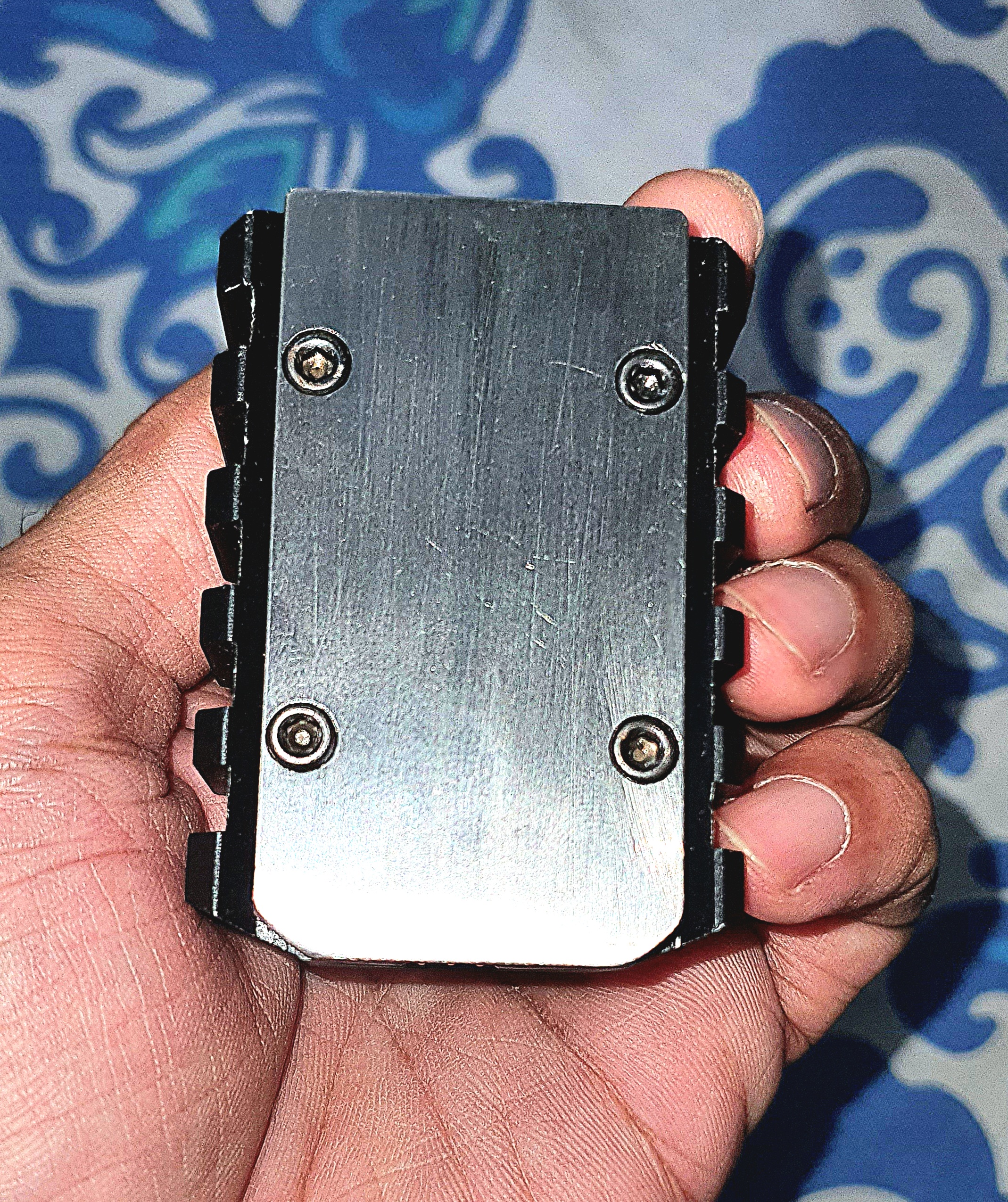

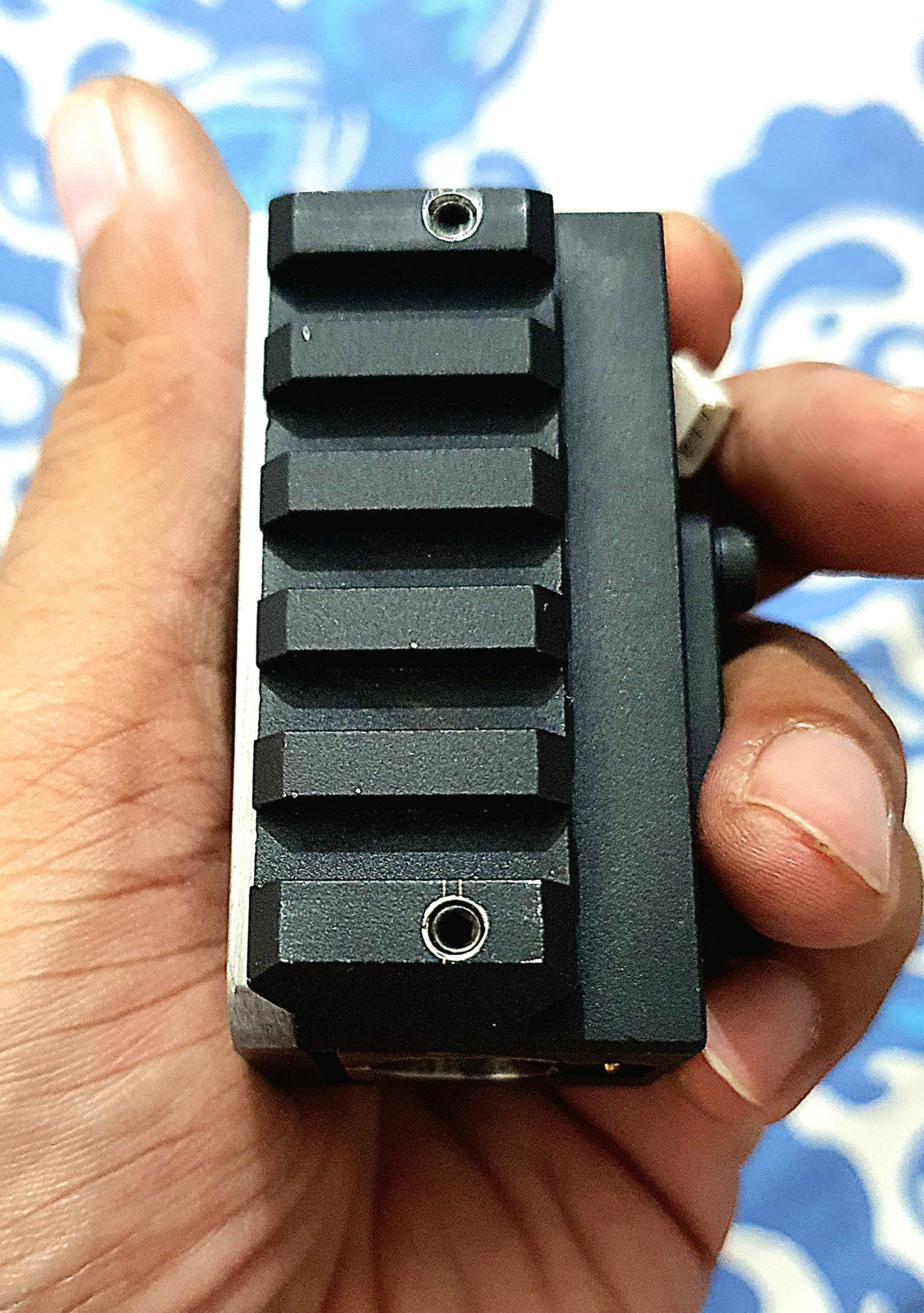

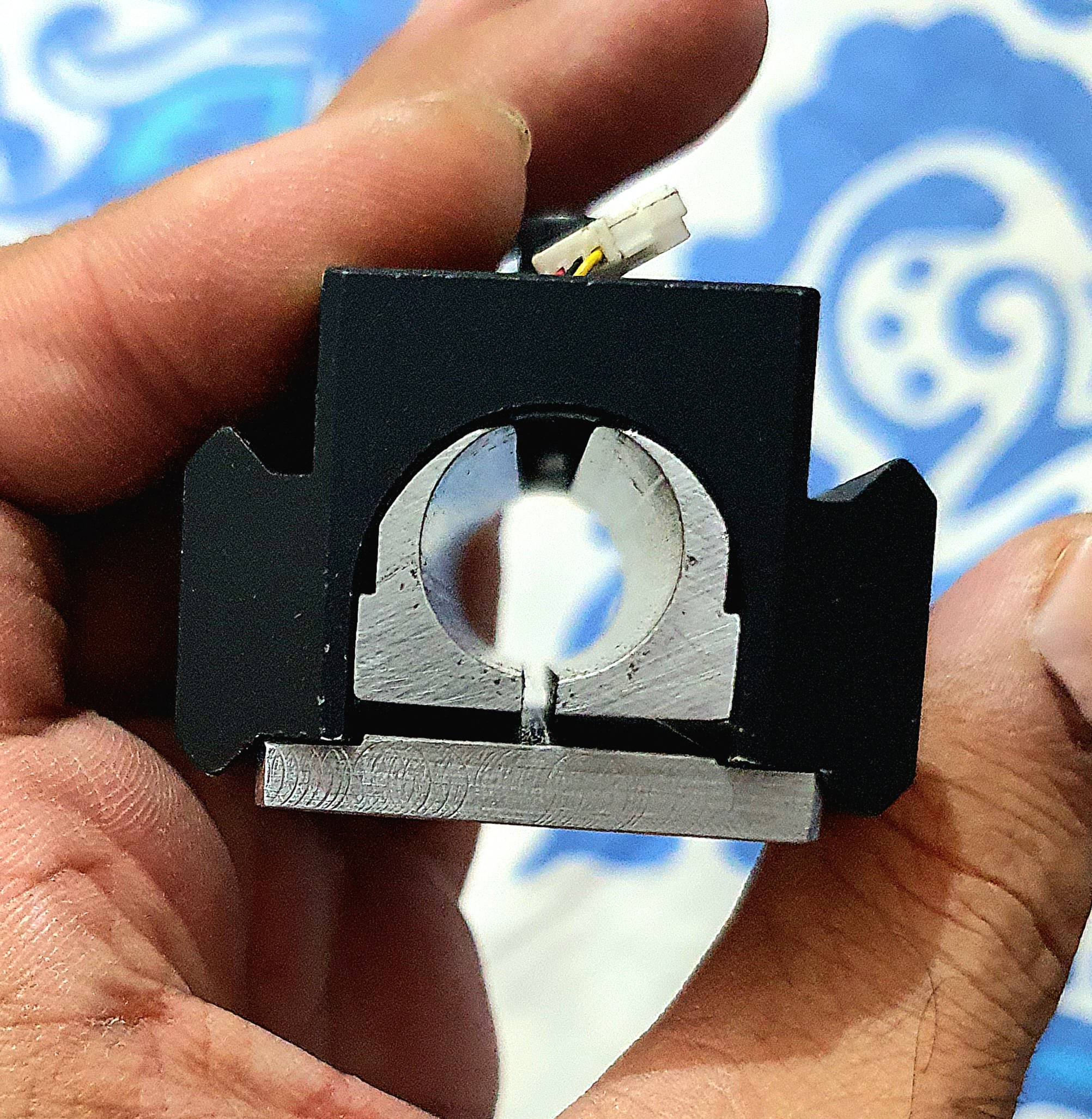

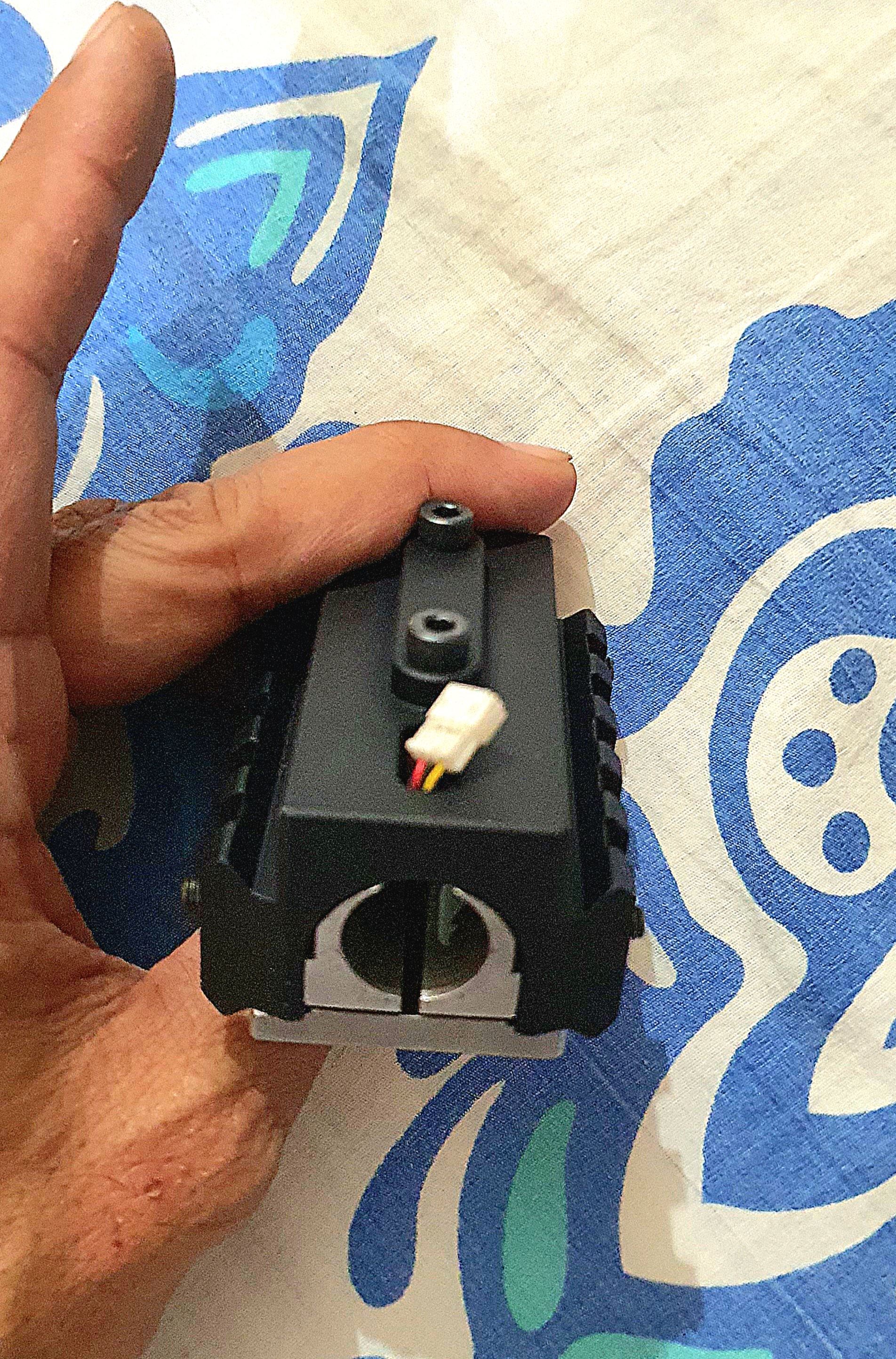

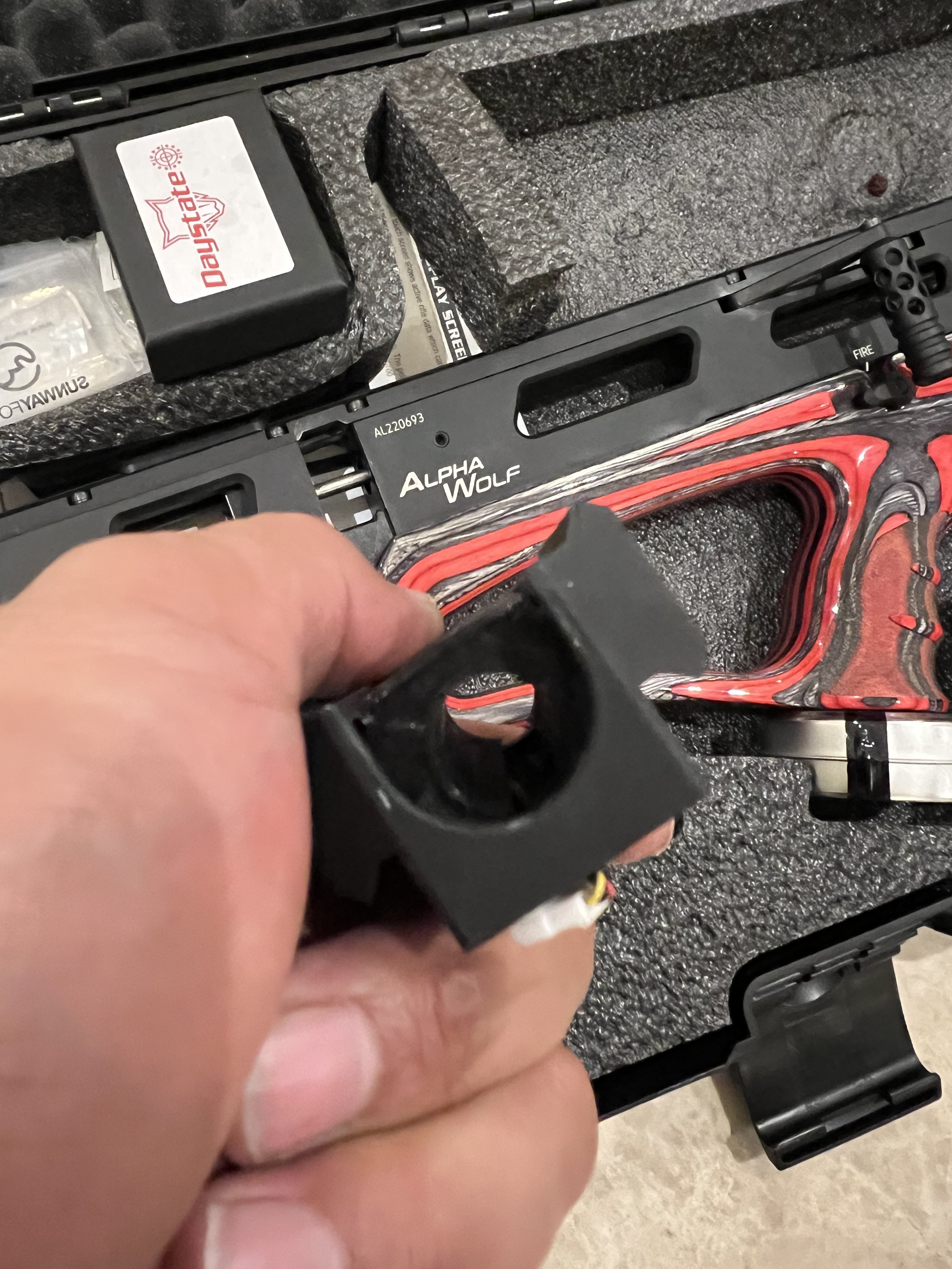

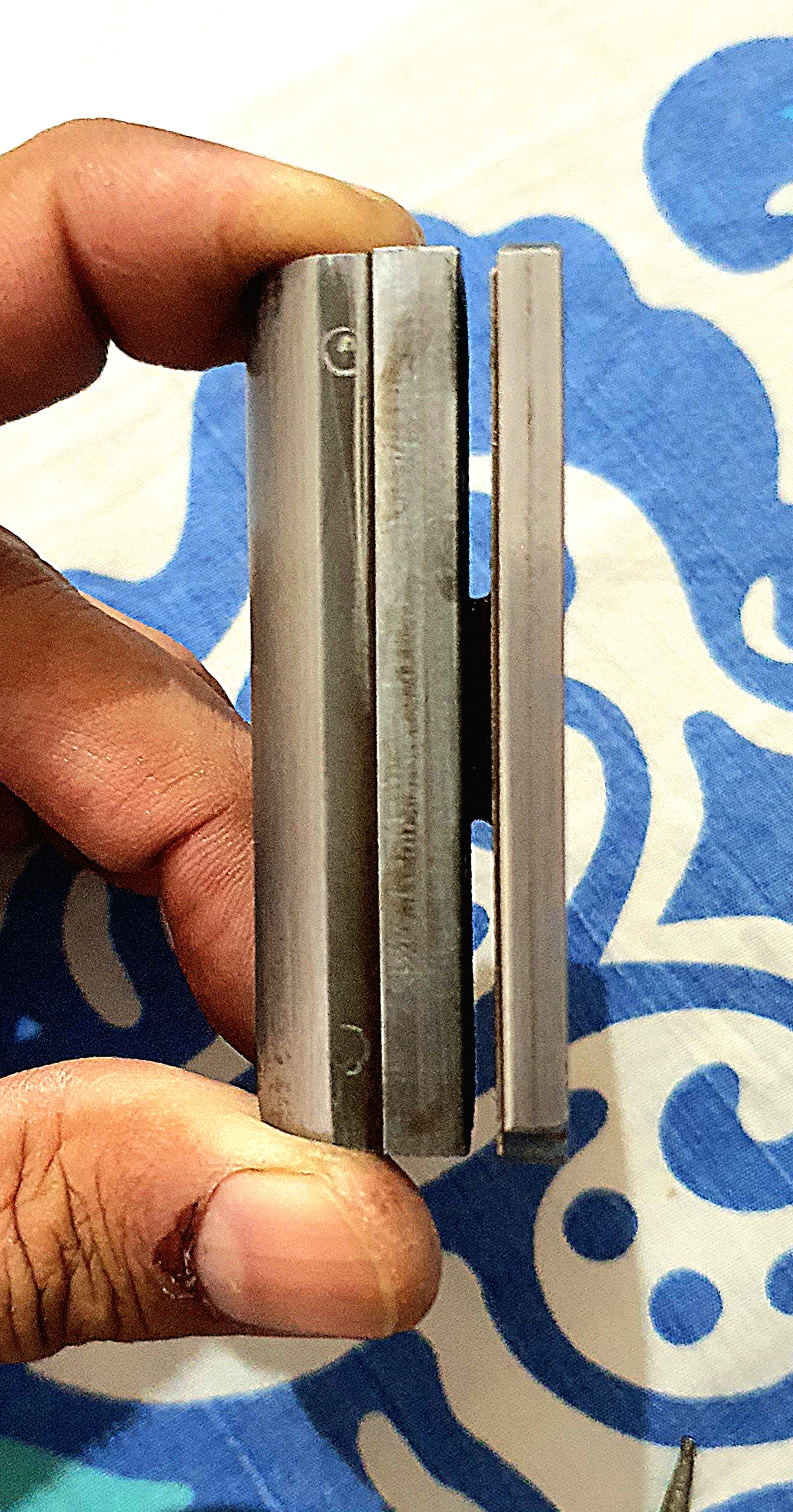

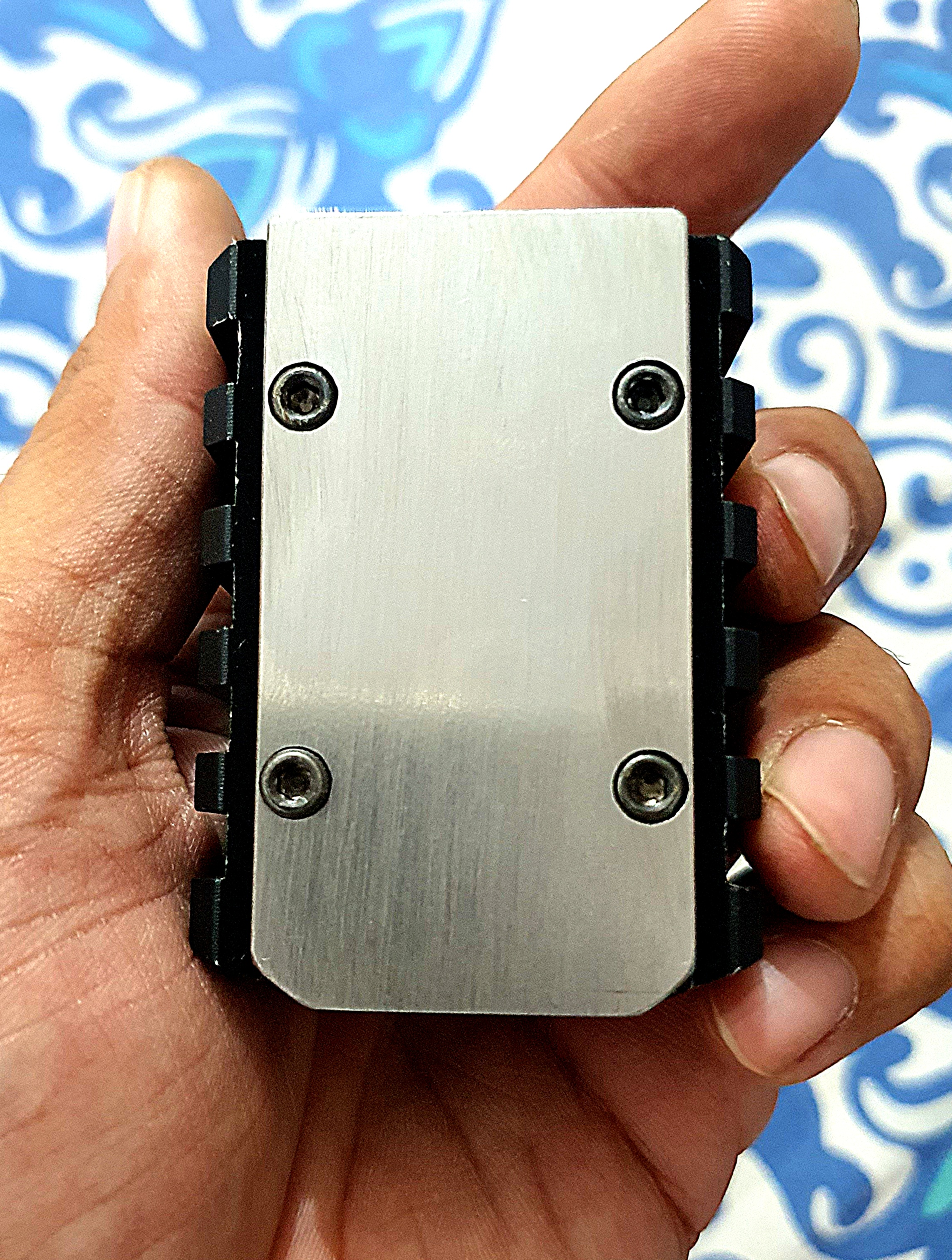

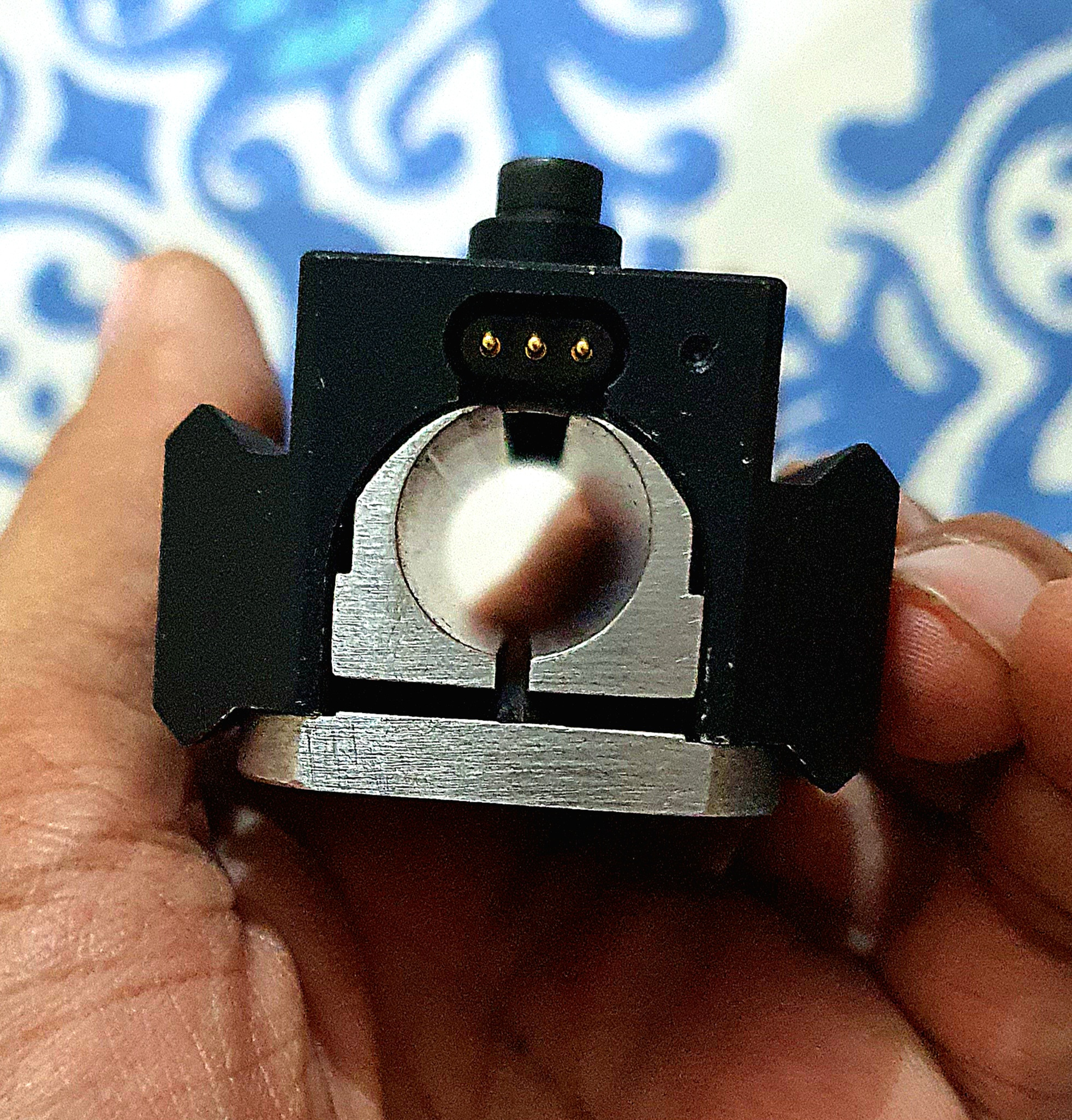

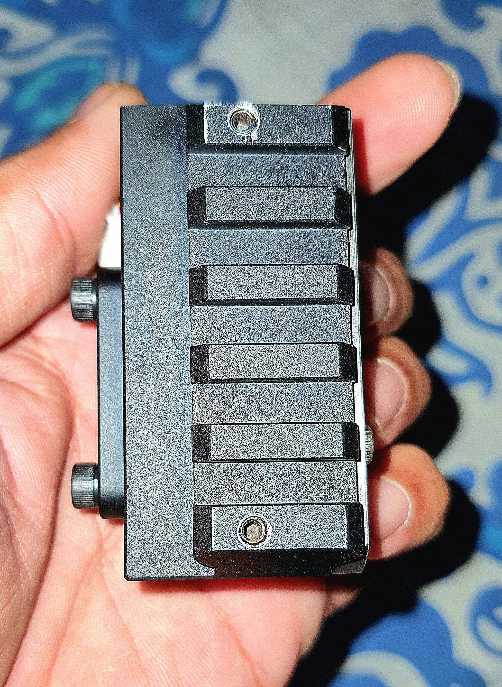

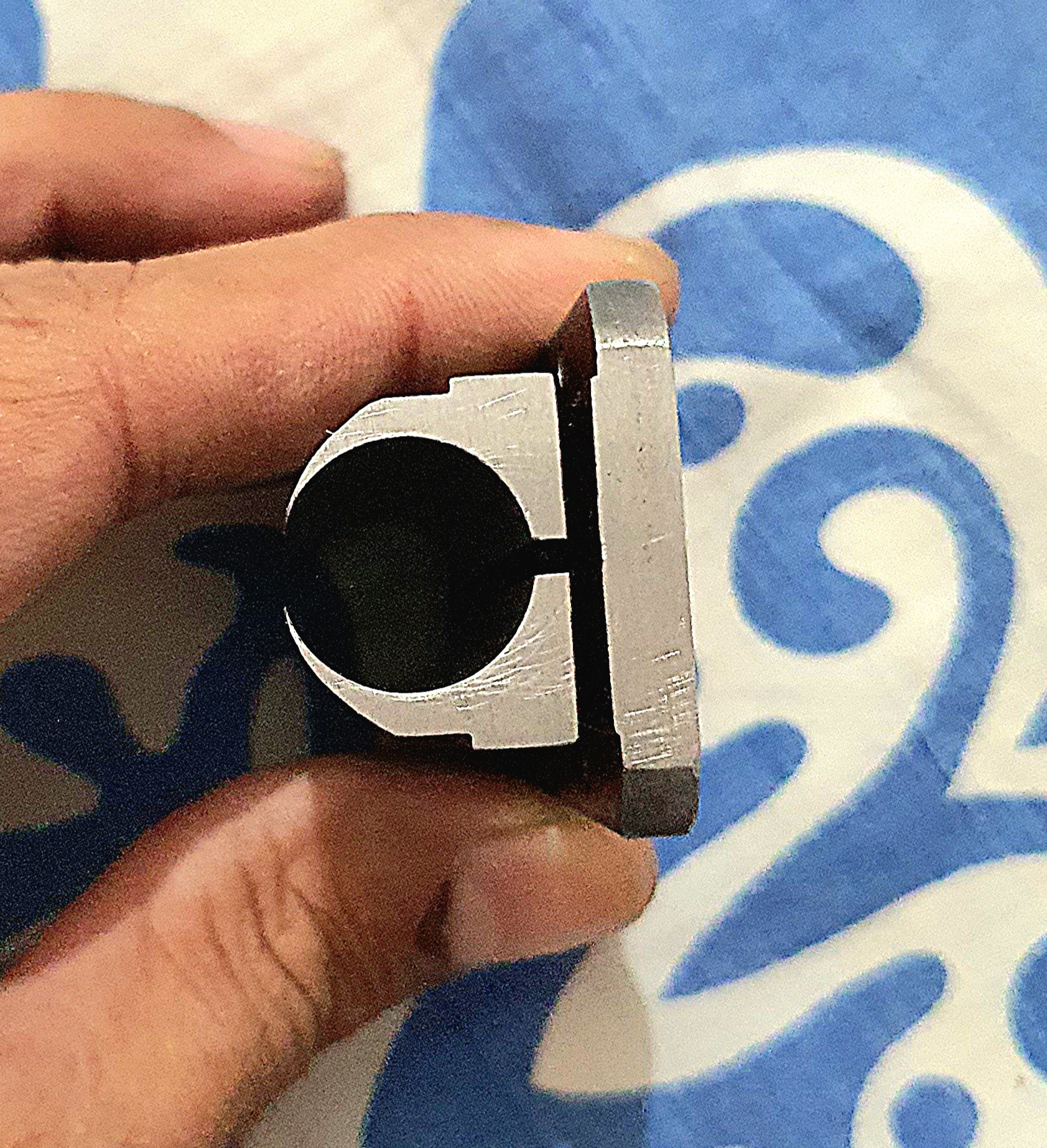

Now as a last resort I understand that I should develop a barrel holder just like one that is now being used by FX IMPACT M3 to also hold the barrel from the point it comes out of the block.
I feel that some kind of strong barrel holder might resolve all the POI shift issues.
Please share your experience regarding DW POI shift and its permanent remedy.

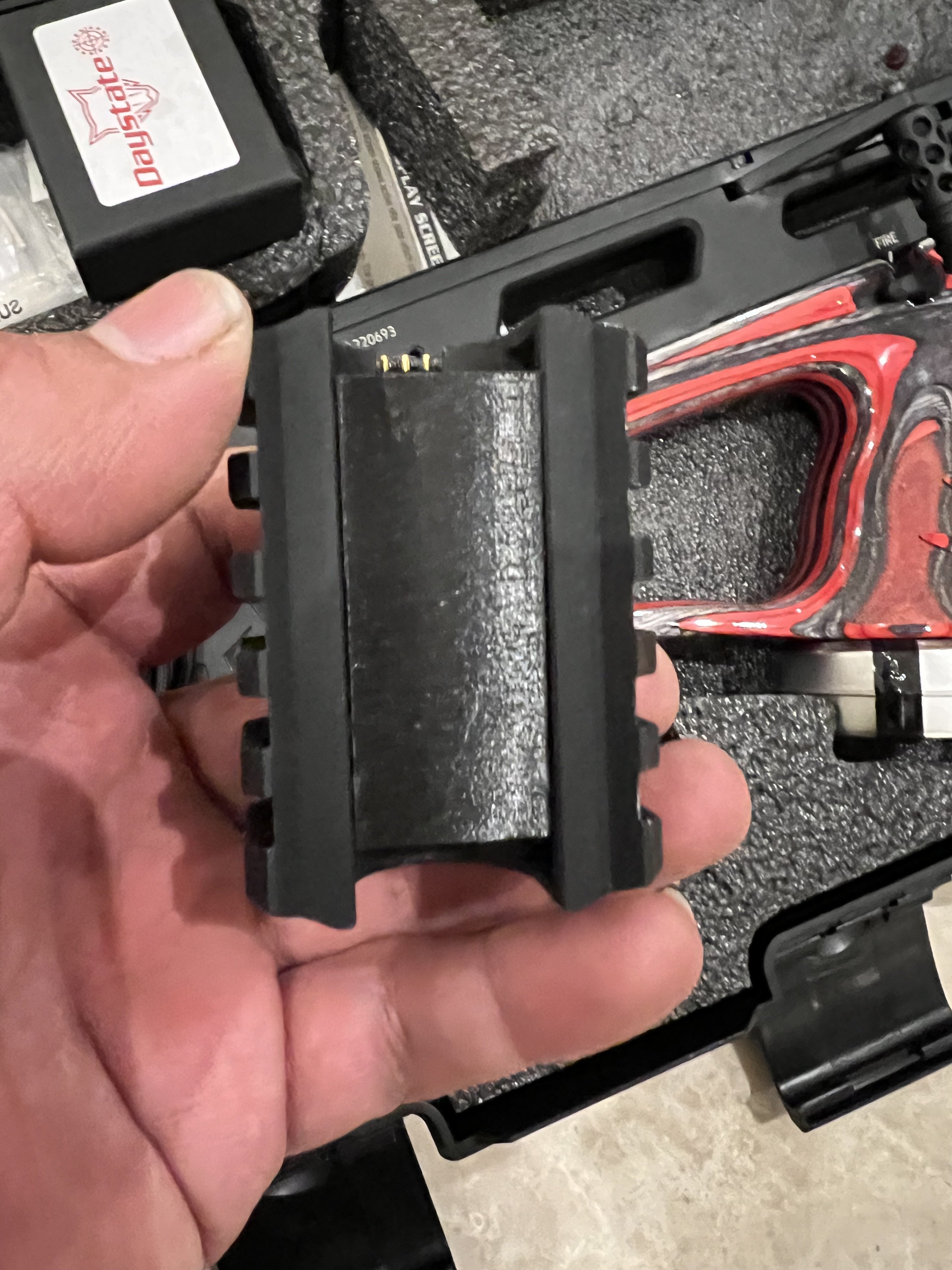

It’s similar to the issues that some have with the FX impact. On the Delta/Alpha Wolf, spacing out the shroud with a credit card can help. It allows the barrel to return to center easier after a bump or pressure.

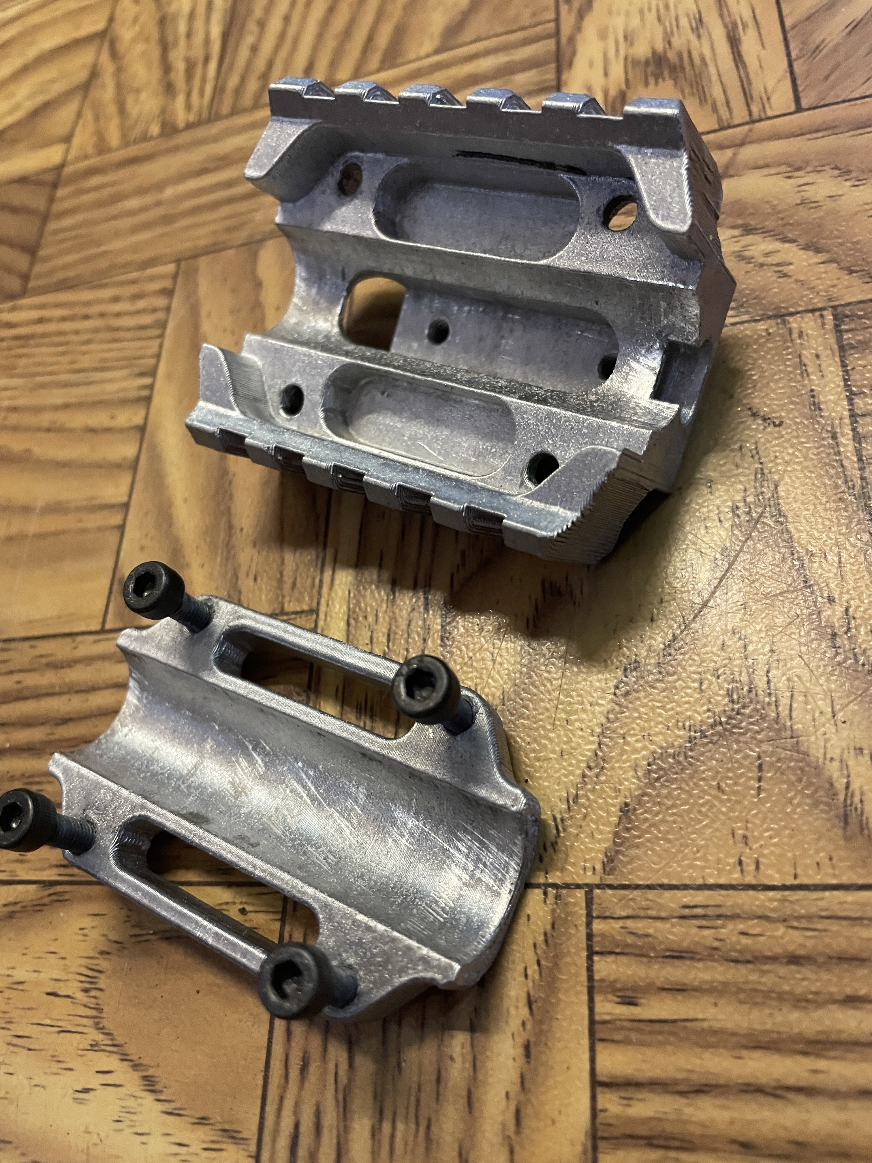

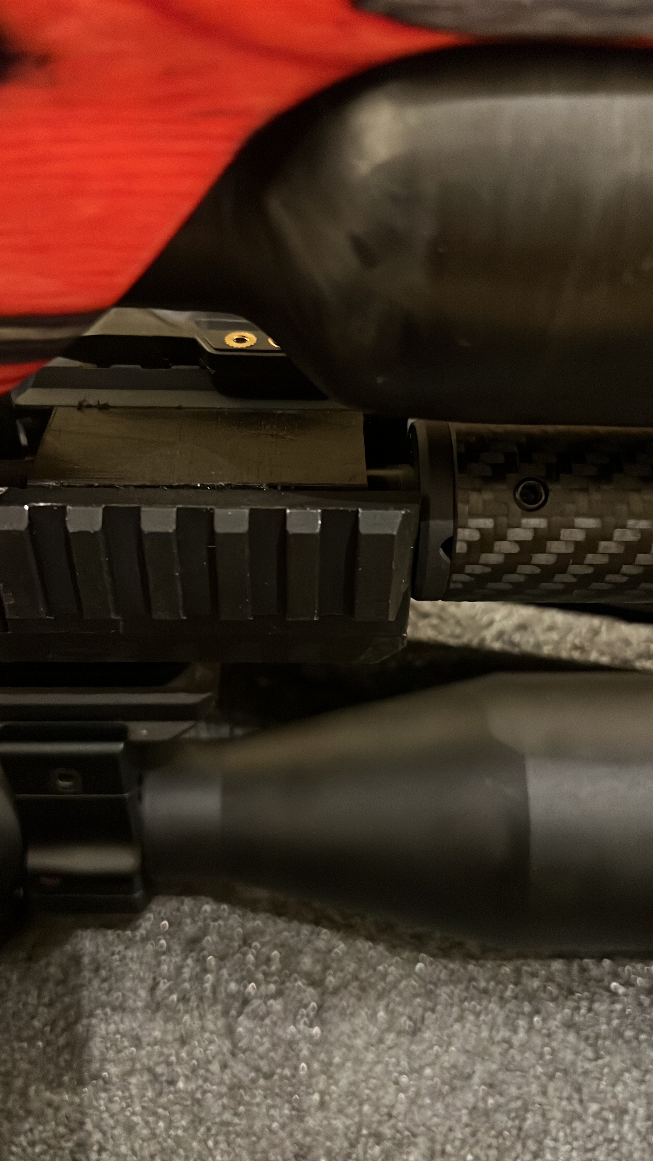

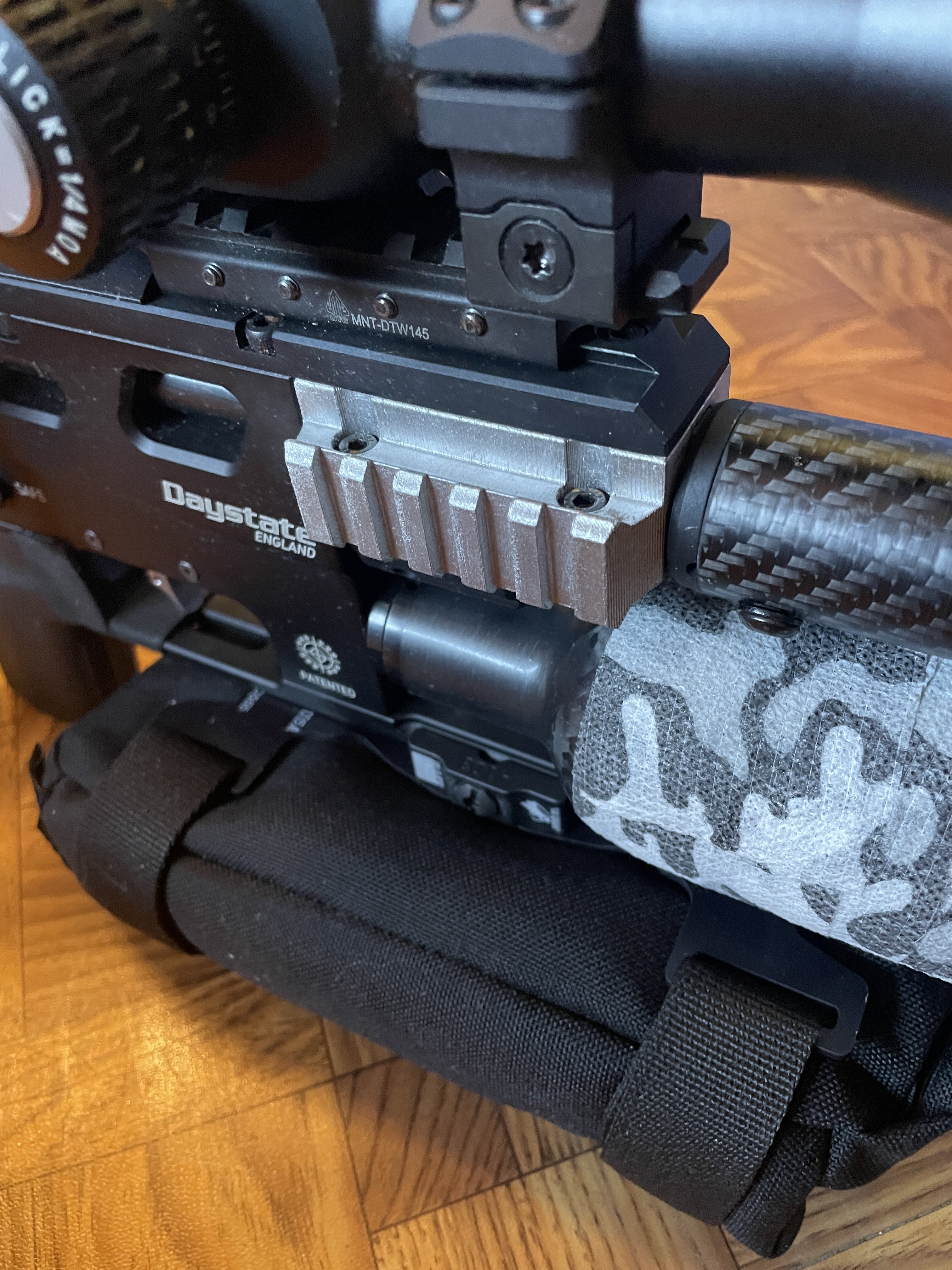

I prefer a very stable POI that is more resistant. So I made a barrel holder/clamp as you described. No more POI issues. I’m surprised some company has yet to offer a barrel clamp for the Daystates.

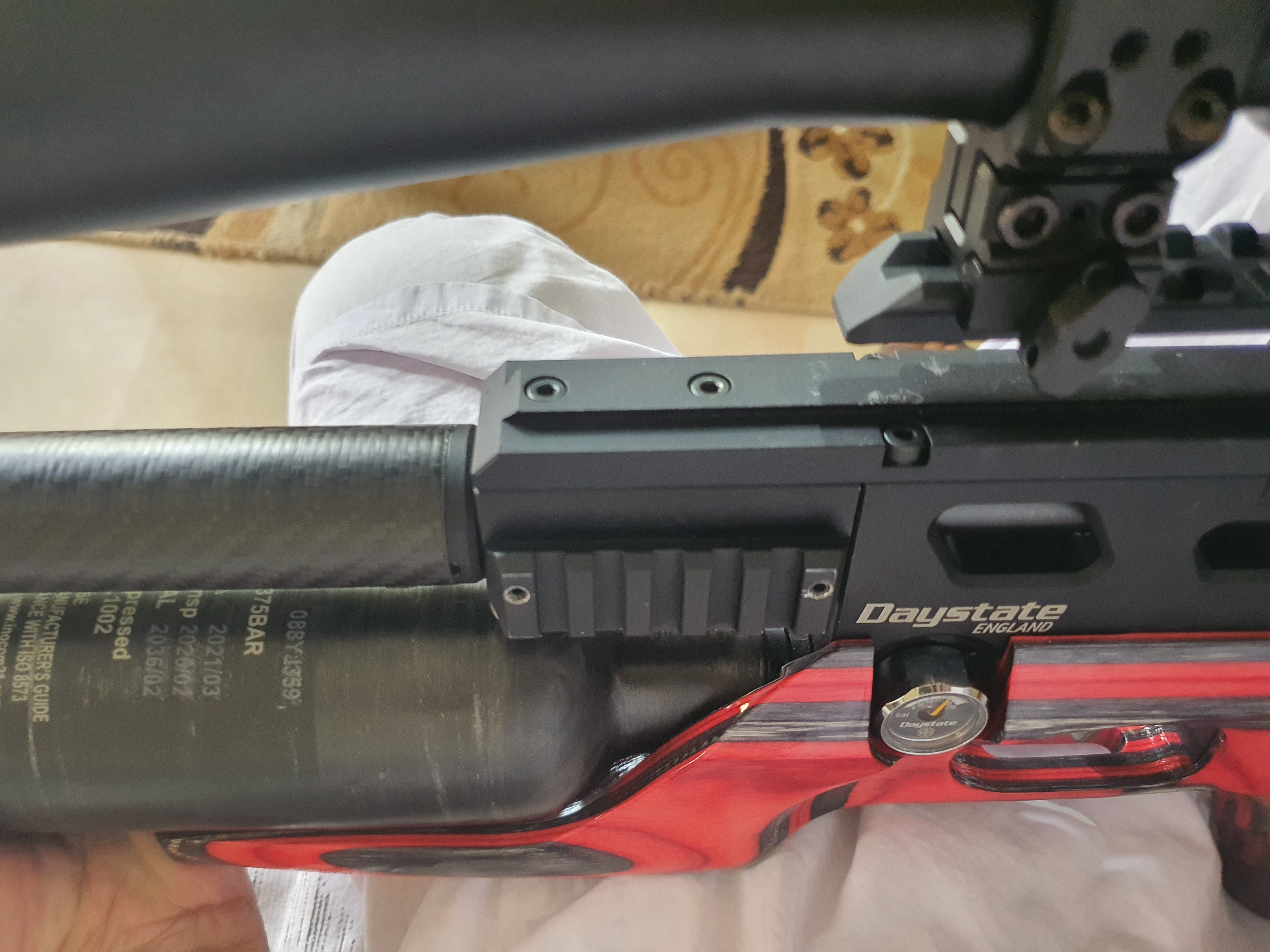

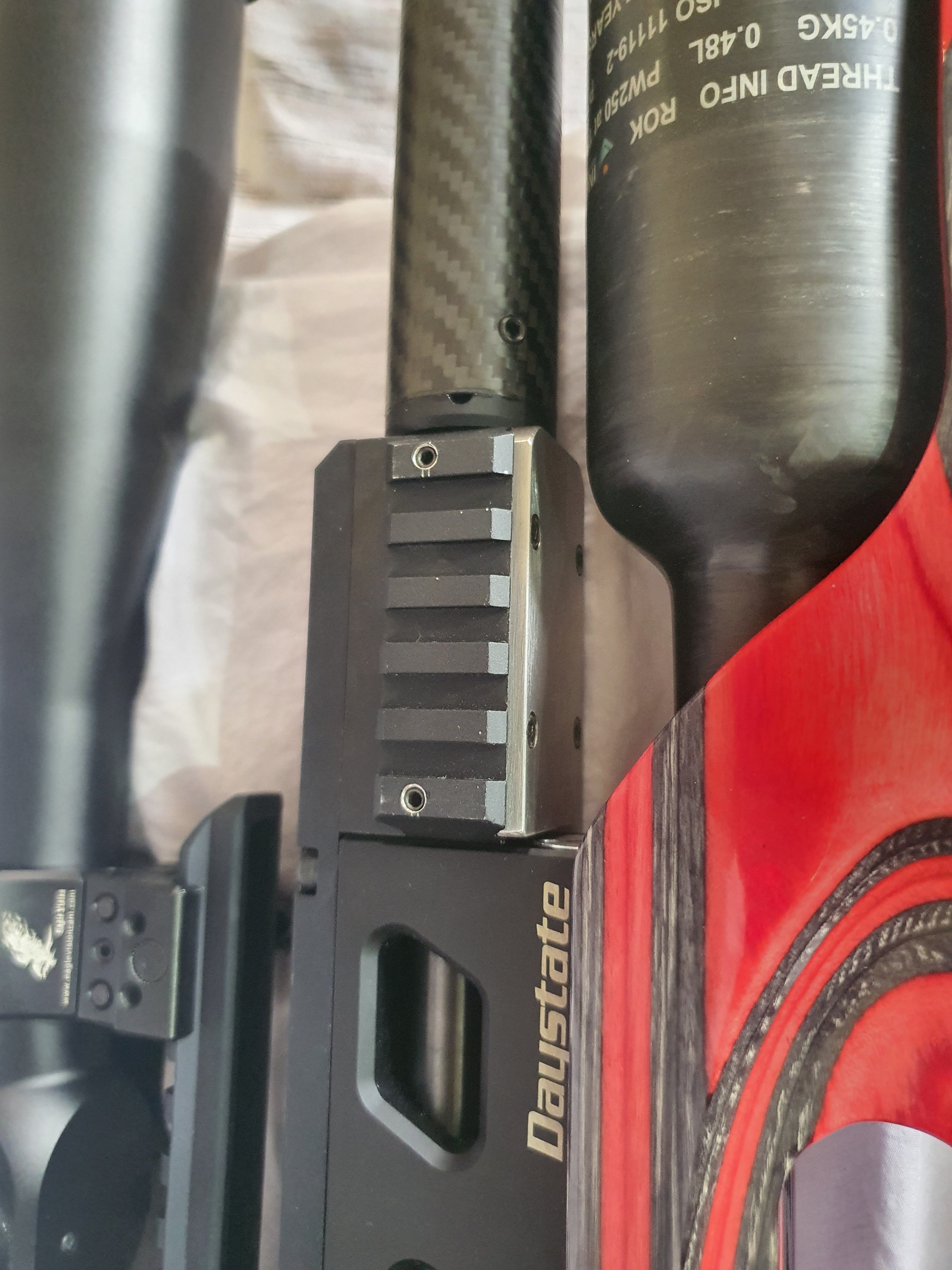

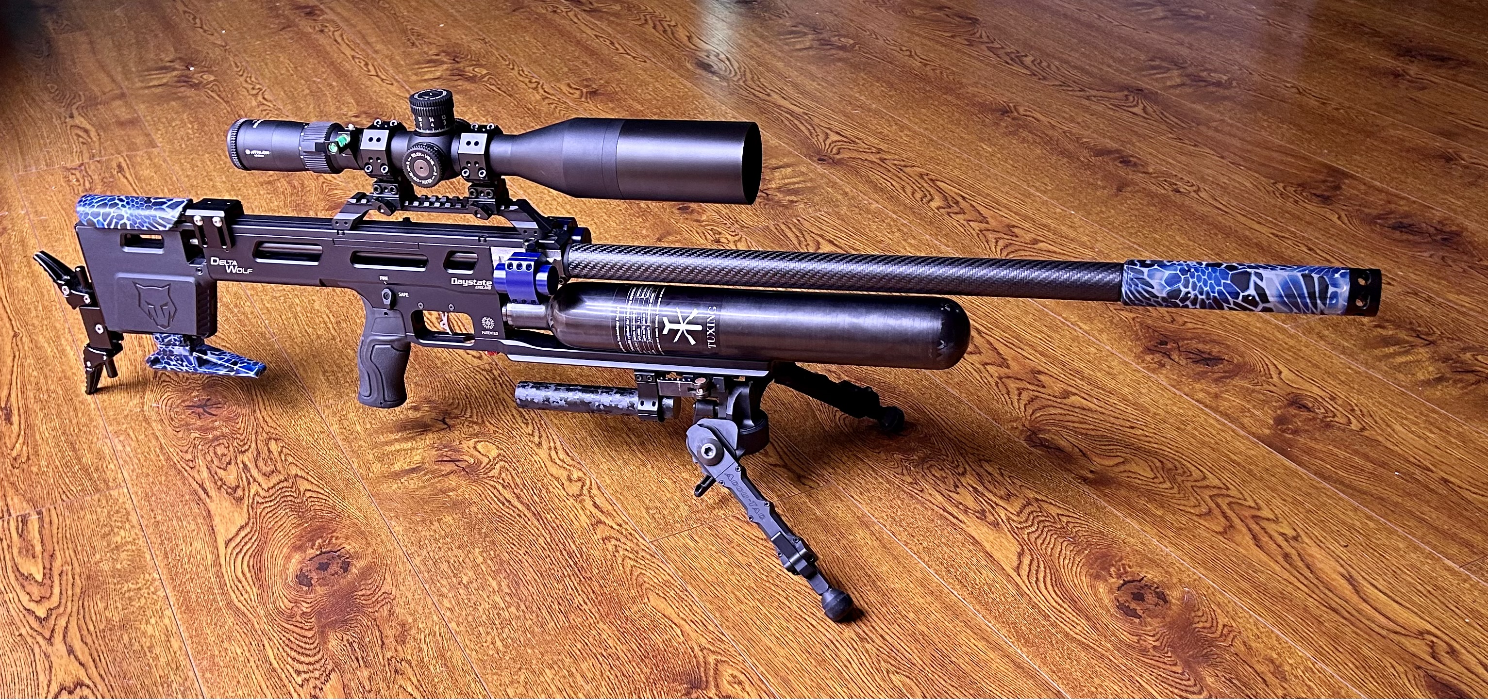

What scope rings are you using?
Have you tried replacing the breech o ring? Also, It is hard to tell from your photo, but it doesn't look like there is any gap where the barrell/shroud meets the rifle. There is supposed to be enough gap to fit a business card, so that the air from the shroud can vent properly.
I'm no expert, just trying to think of anything that could be causing your poi issue.
Yes the breach O ring is fine and there is reasonable gap where it is required.
