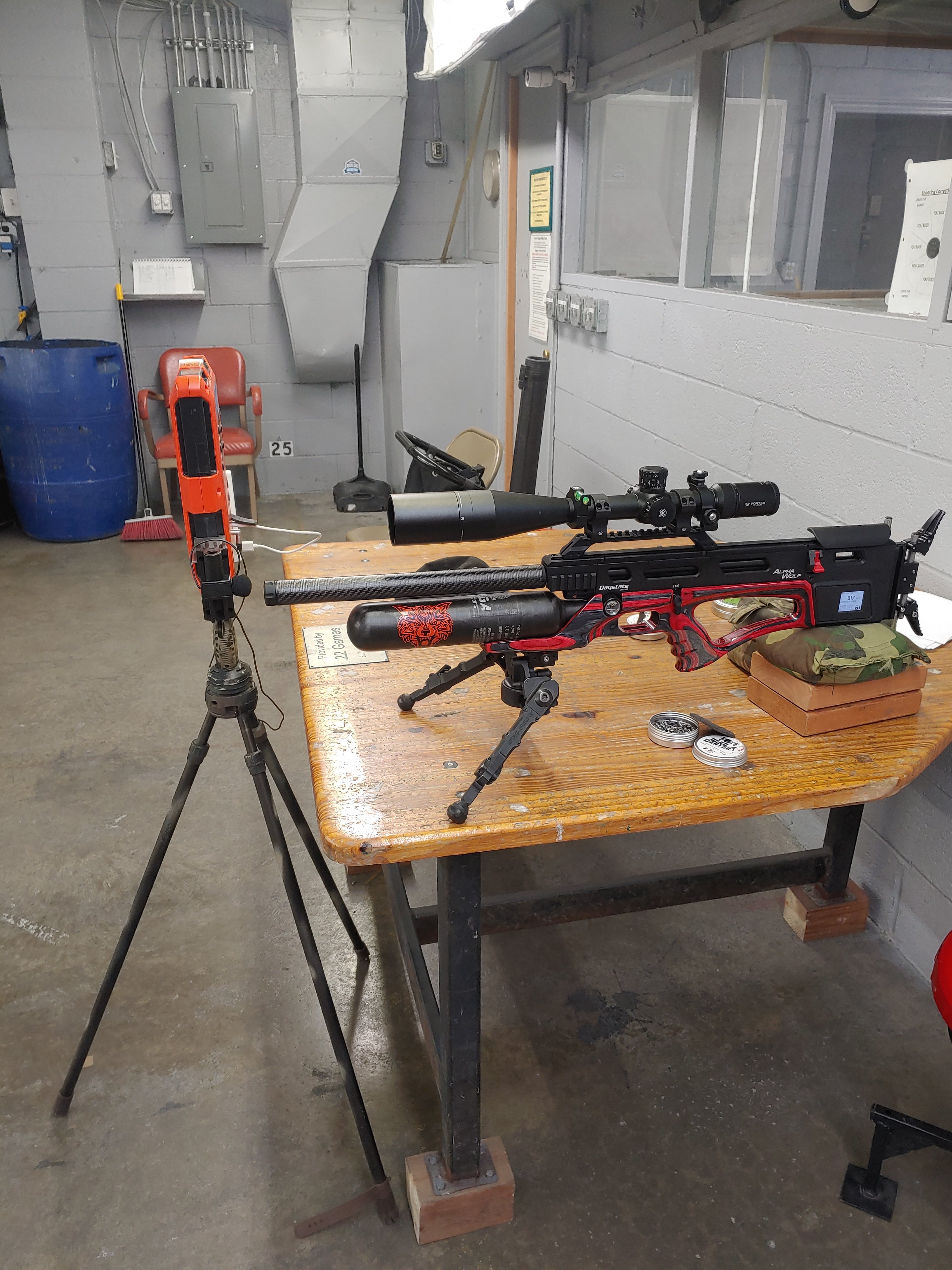

My new Daystate Alpha Wolf Safari arrived today. After initial setup, sighting in, I wanted to compare the results from the built in chronograph vs. my LabRadar.
Very different results in muzzle velocity, but the math works out that the extreme spread and standard deviations are within 1 fps of each other so the rifle is consistent.
What is puzzling is the average difference of 12.45 fps between the two measurements. So which one do I trust? Any ideas on what is causing the difference. I have my Lab radar just in front of the muzzle. Very close.
Here are the results from one mag of .22 JSB 25.39gr Redesigns. Note. This is out of the box. I have not adjusted anything on the rifle.

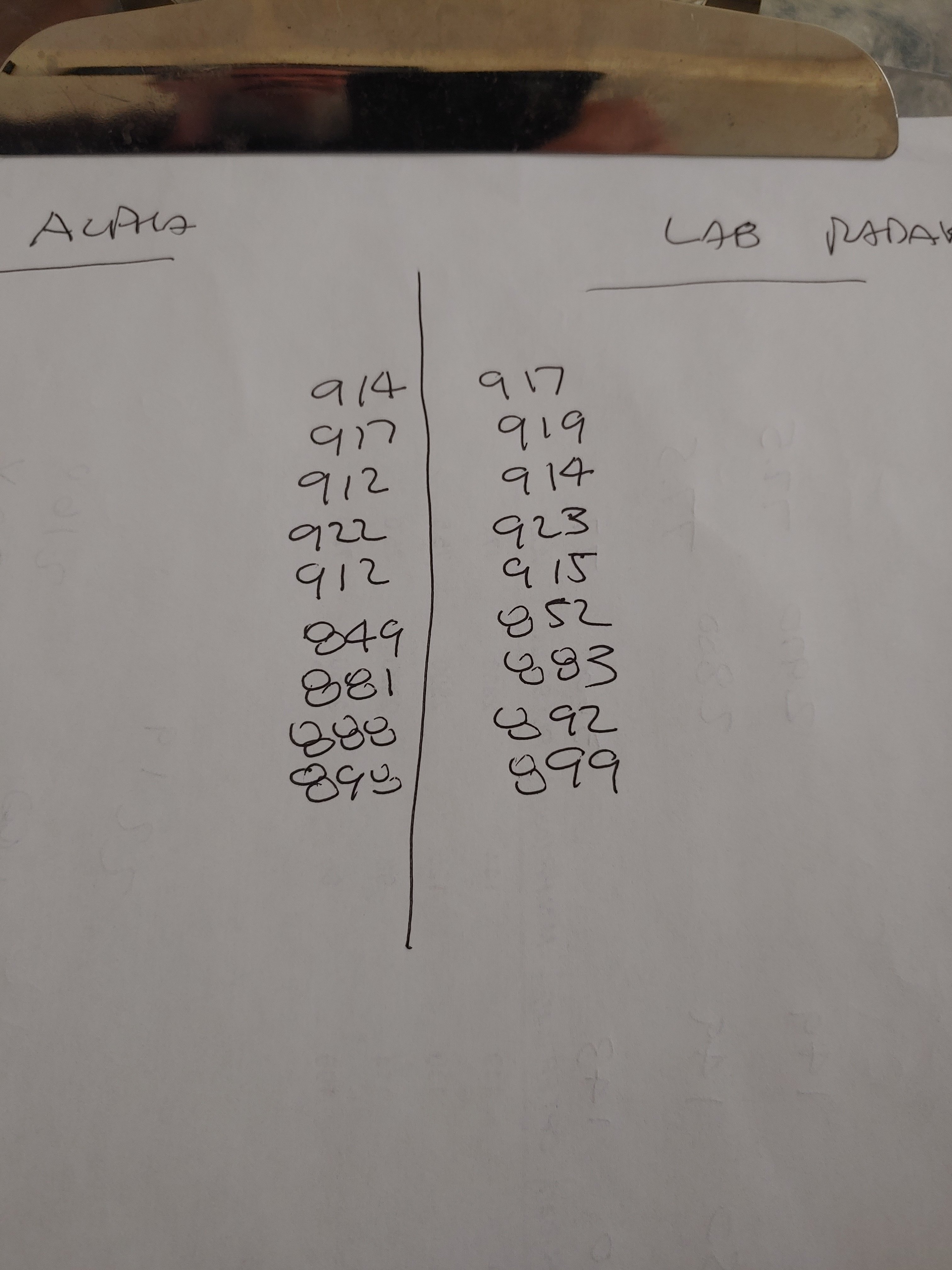

Shot my Alpha today here are some velocity comparisons between mine and my Lab Radar
The Daystate chrono can be calibrated and are usually dependably close from my experience. It's optically derived vs echo from a radar signal on the LR. Setup is important and environment are important with the LR. Even though it has "Lab" in the name, I'm not so convinced of its absolute accuracy. The DS will be more consistent, period, but will depend on the cal number for absolute accuracy.
With all the trials I've had with mine,I trust the Daystate more.
