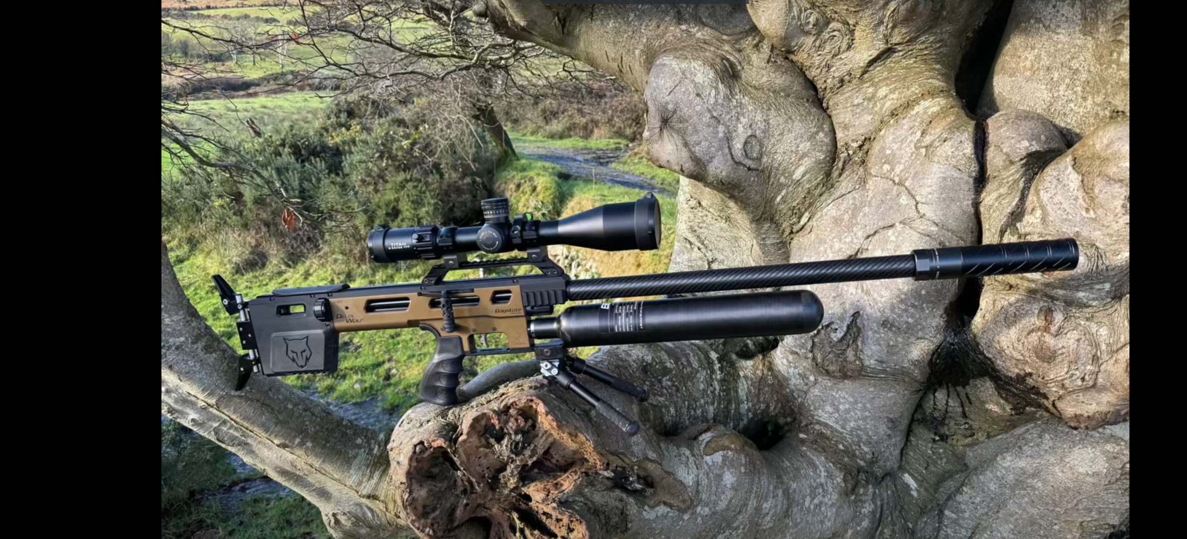

Hello everyone! I want to create a thread where people can place there experience, photos, tunes, photos of groups and other information about there Alpha/Delta Wolf's. As im about to pull the trigger on a Alpha Wolf Safari hp with the new 28' slug barrel, I've come through loads of bad post about this airgun. I know the Alpha/Delta is a very capable platform nowadays and i think its deserves a bit more positive attention. After reading this thread about the Red Wolf: https://www.airgunnation.com/threads/post-your-daystate-red-wolf-shot-groups-here.715008/post-715650 , I thought lets do the same for the Alpha and Delta🙂.
So feel free to share your best groups, tunes, photos, projectiles, speeds etc... ! For everyone that's looking for information about this airgun.
A photo of a Delta Wolf with the 28' slug barrel and a 700cc bottle that i've come across online.

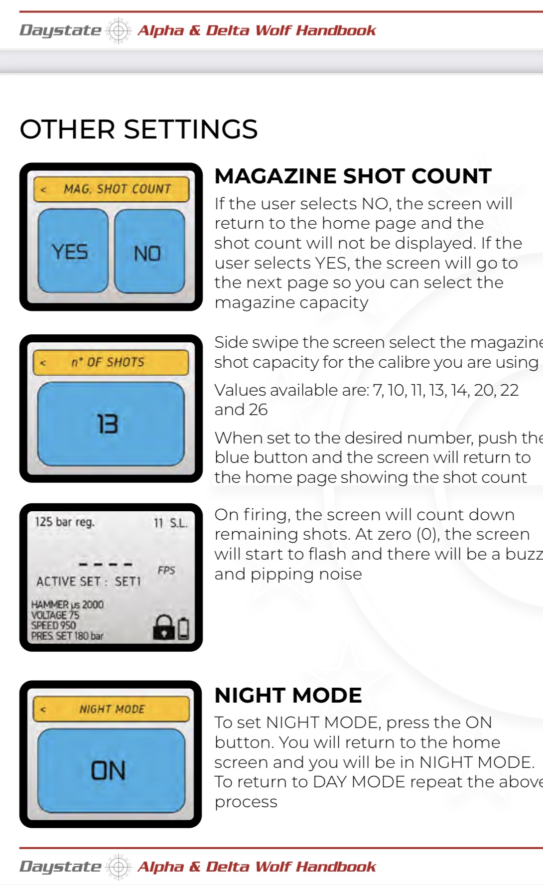

Early days for me with this gun but there is a few things I don't like. At first I had to use the magazine counter because it was hard to know when you fired the last shot but it does not activate until you pull the trigger on a empty magazine but the Redwolf alerts you after you fire your last shot.

Have you checked to make sure it is set for the correct magazine capacity?
Im new here btw 👋.
Daam, Expensive picture to show- Now my Delta Wolf also needs long ones too :)
