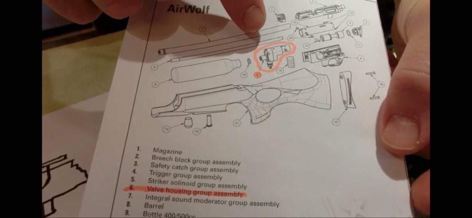

I have this rifle for like 7 years I passed it to my nephew to use it, it started to leak air from the barrel, IT doesn’t hold air any more.. I already check fill port and any other places for possible leaks. Everything is fine except for the barrel leaking. Does anybody know how to fix it?? I know the problem is in the valve housing group but I don’t want to mess it up more lol..

In recent years ALL the Daystates I've been into are using similar Poppet / Seat architecture. They are utilizing a one piece STEEL poppet that passes threw a "Frisbee disk" seat made from PEEK. Around the O.D. of this seat disk is a POLY o-ring. The disk by design is free floating radially against the throat side of valve housing. When this o-ring hardens and takes a set over time it can no longer seal & must be replaced.
This would be IMO the ONLY way in these rifles one could have an air leak out the barrel.
This would be IMO the ONLY way in these rifles one could have an air leak out the barrel. Do you know where I can buy that o’ring ? And do I need special tools to take the valve housing apart? Thank you for you help

Biggest issue typically with any BOTTLE gun is getting the bottle off. On Air Wolfs the bottle must come off to access the screws of housing getting access to internals of the valve housing.
Sadly don't now the o-rings size specs .... Having 1000's of o-rings on hand I simply match-em-up when replacing. It is a METRIC o-ring and is Urethane ( Tho Buna-n will work, just won't last as long )

Thank you I got the bottle off years ago when I traveled and then put it together..I’m just concerned about the valve housing itself because somebody says that special tool is needed to take it apart.. for the o’ring AOA should know the size I’ll call them.. thank you very much
