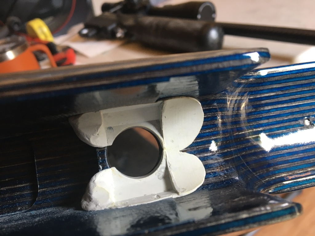

Can you post a pic of the bedding in the stock please? I presume you are meaning a similar process to bedding a centerfire rifle without a recoil lug?

The bedding is done right at the area above where the fill port is, and where the neck of the bottle attaches to the action. Not sure what the material is, but its pretty hard and makes that area of the gun sit flush with the stock so there is no play at that point... Photo below:

It's similar to marine-Tex so that should work but be VERY careful not to glue your action to the stock. I put several layers of wax and still just lucked out on my first one.... I pulled it out while the epoxy was still very slightly green and it would have been STUCK if I didn't. The idea is to give the breech block 2 or more GOOD points of support.
