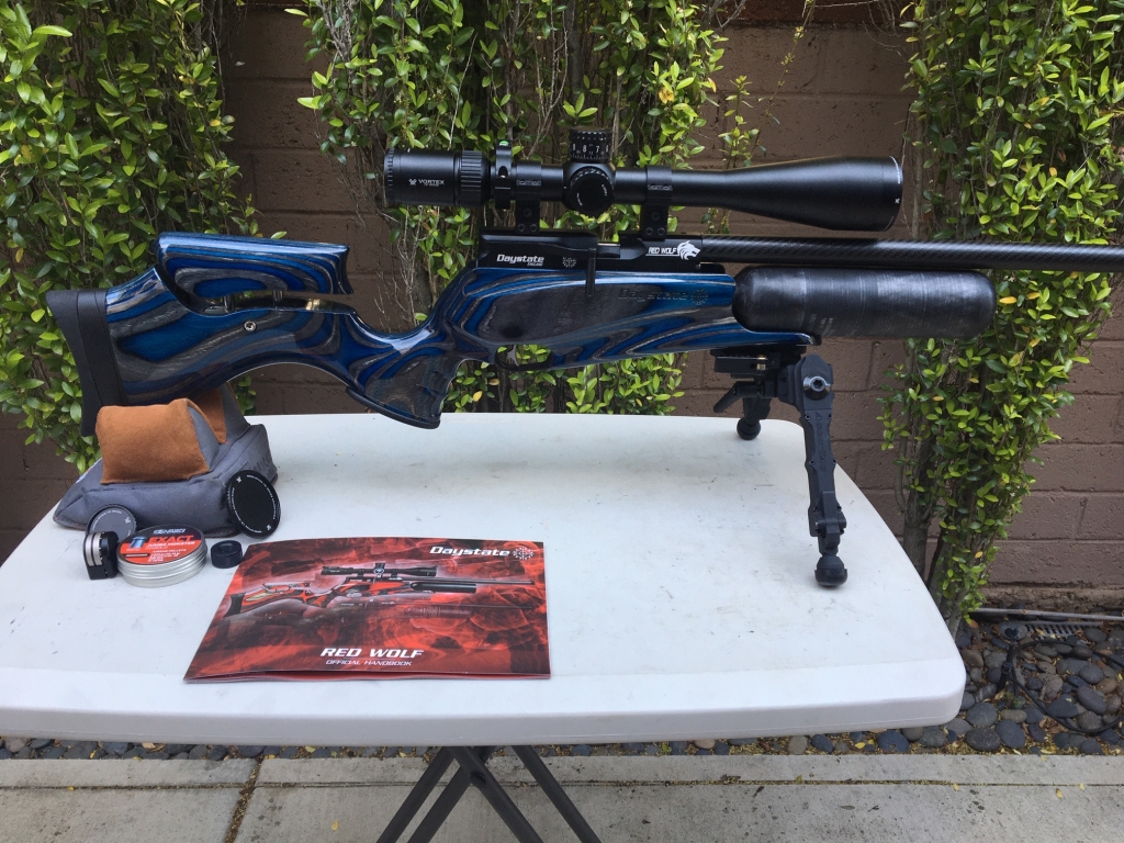

This has been a long time coming... After I won (Sportsman) EBR in October, one of my prizes was a trip for two to England, a tour of the Daystate Factory, and my choice of any Daystate gun that they make. Well of course I want(ed) the new Delta Wolf, but with Covid-19, and travel restrictions, plus the serious troubles in Italy (where some of the parts are made), I decided to take Robert Buchanan up on his offer of a custom .22 Red Wolf (safari power) HP in the gorgeous blue laminate stock. Thanks AoA, Daystate, and Robert!
My reasoning for this is that I wanted to shoot the .22 RD Monsters this year in competition, since I have shot them side by side with the .30 JSB Exact in my .30 Bobcat Mk2, and the RD Monsters (in my EDgun R3 Long at 960 FPS) were more predictable and less affected by the wind, especially up drafts and down drafts. So as a favor, Robert sent the gun to Bobby Corcorran, the Yoda of Red Wolf tuning, for a tune and make over. Bobby installed new high performance orings, polished and waxed the barrel, bedded the action, and tuned the gun for approx 995 FPS on Medium power with the RD Monsters. On High, it shoots the JSB Beasts at 935 FPS, but they aren't nearly as accurate as the RD Monsters. On Low power, he tuned it for the 18.1 JSB at 880 FPS as per my request, since I shoot in a monthly 25M BR tournament at LDs Club, the Temecula Airgun Club. He also installed a pic rail, since I was hesitant on this gorgeous stock... Thanks Bobby, its PERFECT!

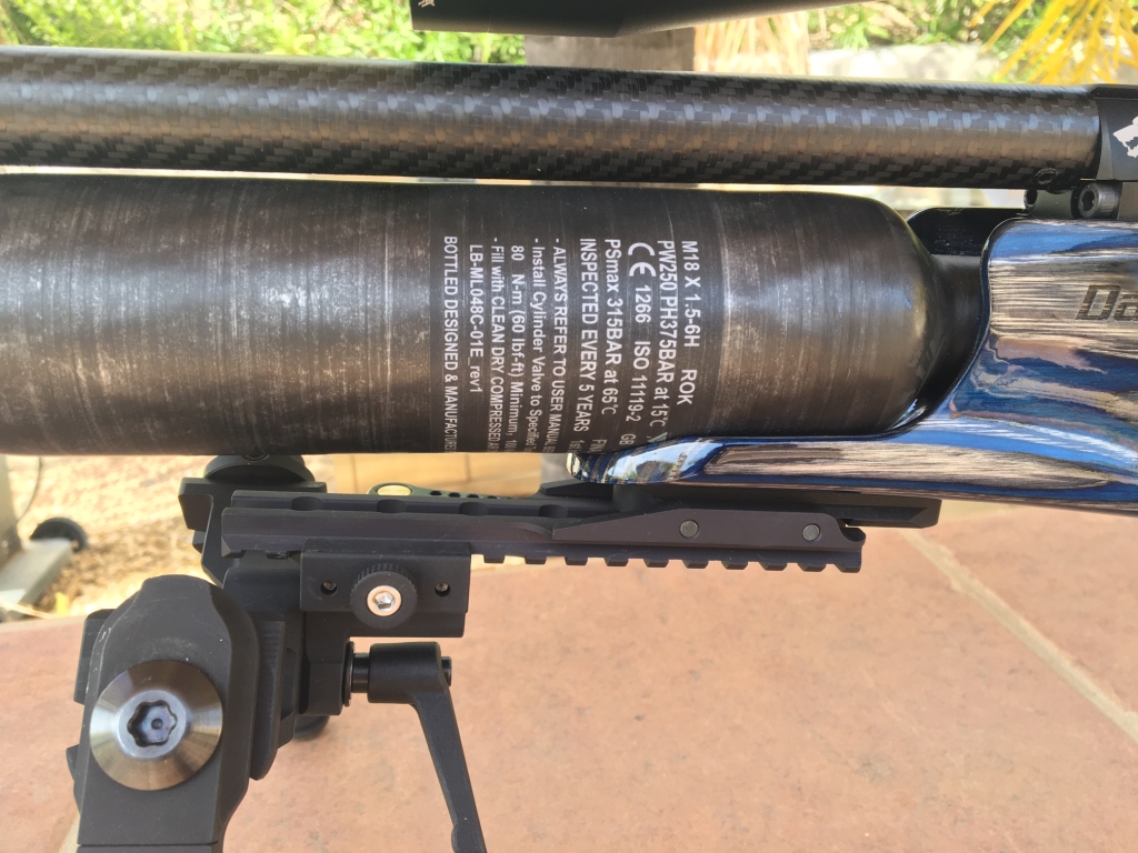

I received the gun on Tuesday last week. Its as beautiful as any gun I've ever seen. I ran it over the chrony to confirm speeds, and they were exactly as I was told. I had planned on waiting until the weekend to shoot it, but went out Wednesday after work. Prior to that, I installed a Vortex Golden Eagle 15-60x52 that I had bought from a Team Centercut member, Dave @dwilson050 Awesome scope by the way...

The gun is very easy to shoot, trigger is perfect and there is almost no motion (unlike a .30 caliber air rifle) when it shoots. Four out of those five targets are MOA or better (as are both groups I shot Wednesday). Oh, forgot to mention. This was shot with the standard Daystate ten shot magazine. and a gorgeous blue Zero dB (0 dB) Moderator, which made the gun super quiet, and didn't affect the accuracy or precision one bit. I'm stubborn. I was told by more than one person to use the SST, and to not use a moderator. But I don't like shooting with a SST, and the horses don't like a louder gun (I was shooting next to a horse corral at a ranch).
