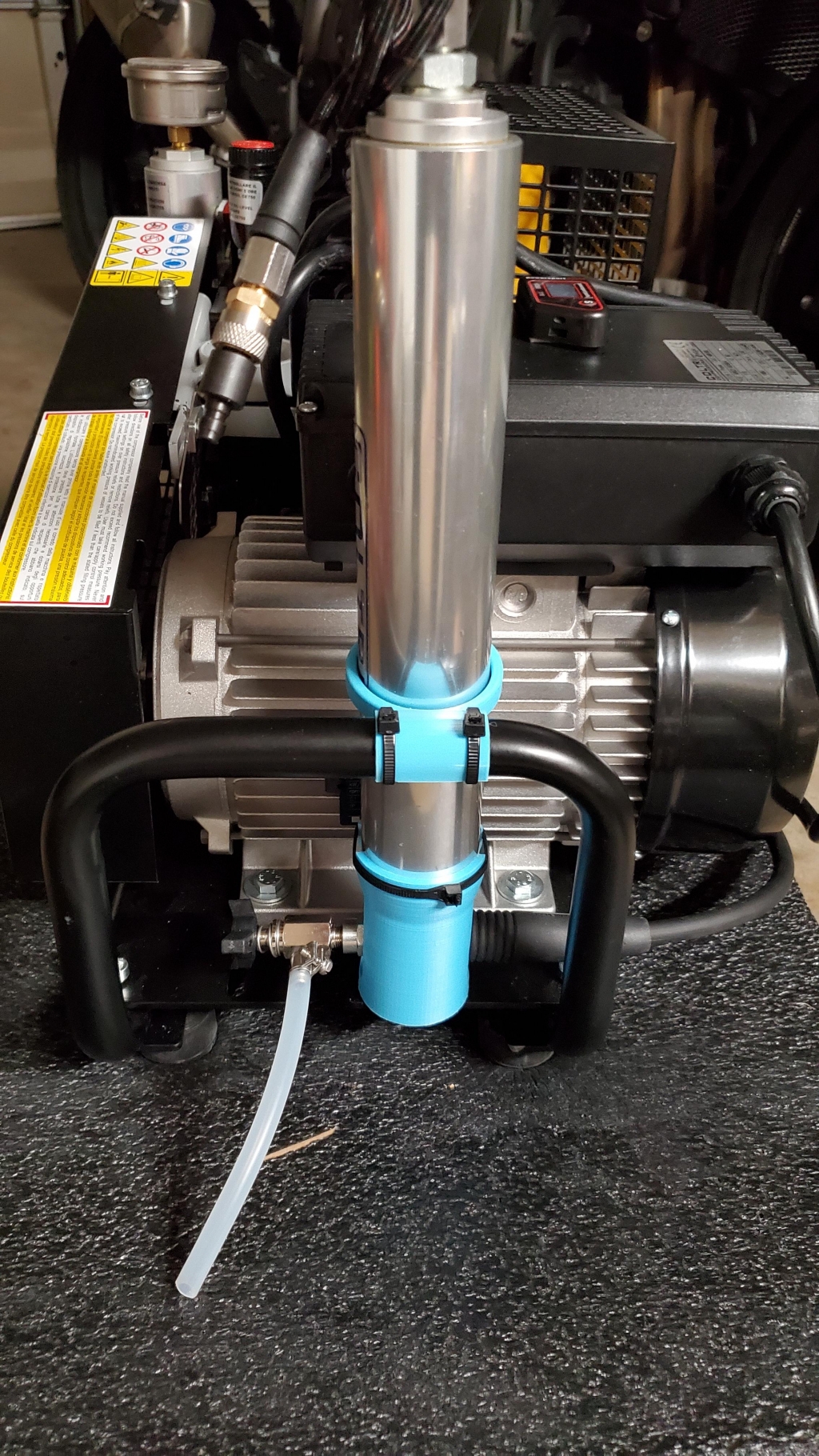

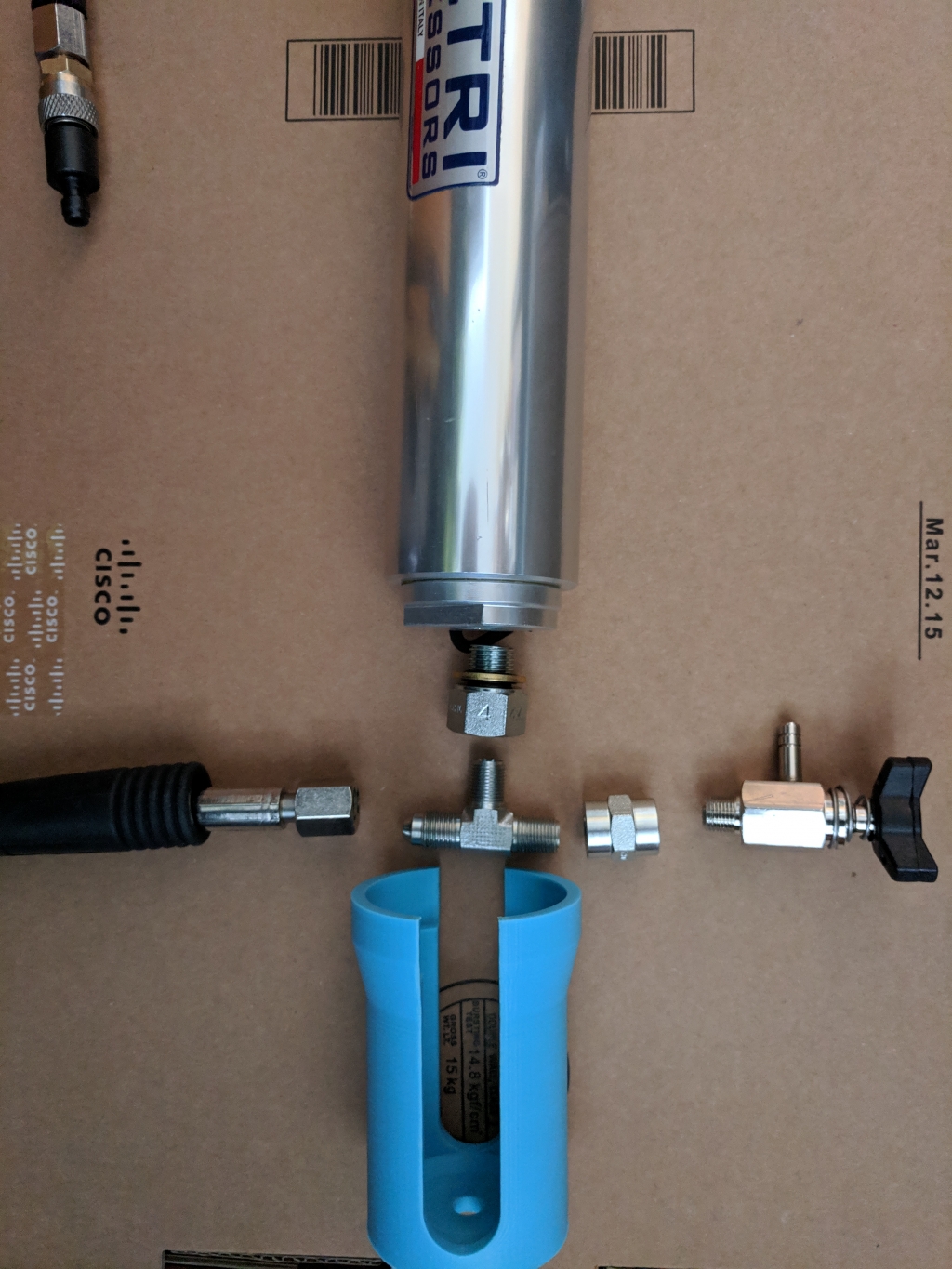

Just finished setting up my LC110, I have had it a while, but was fortunate for some reason mine was shipped with a Coltri secondary filter I checked with the vendor and was told I was shipped all the correct items although I could not use the filter as it had foster connections. Well looking at what was supplied for the price of the standard compressor I also received a filter worth $260-300. Looking at this thread and searching for parts I added a few connectors, I tried to put the filter in the center, but with my bleed valve there was little clearance, I therefore opted to put it on the end next to the motor, here are some pictures of my installation.
Filled the oil and ran for 2-3 minutes to test everything with a dead head in, no leaks allowed the pressure release to activate (mine is not one with the automatic cut-off that's being shipped now), I then released the pressure using both bleeds everything worked as planned.
Then I got my Air Venturi 74Cft tank it was down to about 200 Bar, hooked it up, started the compressor, closed the first bleed, then the second bleed, let the pressure build to 200 Bar, opened the tank valve, 7 minutes into the fill I bled both valves, first one under the gauge had some moisture, valve under the filter appeared to have no moisture, Second bleed after another 7 minutes, at 310 Bar I closed the tank valve, started a slow bleed at the valve nearest to the gauge, then a slow bleed at the filter, as the pressure dropped opened each more until it was at zero, disconnected the Foster link, ran the compressor for 3-5 minutes to cool down.

@steveno - that'll work! :) I now have two Coltri tubes and I have my setup configured with both filters / moisture separators in the output circuit, with a Fosters WD female on the end. It wasn't fun taking out the DIN from my great white, and then having to connect the male DIN from the filter to my tank each time. I'd have to use Teflon tape each time, and it was an aggravating setup.
