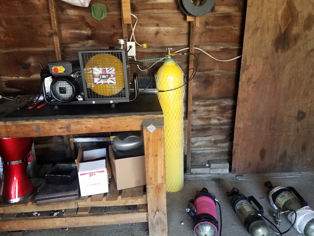

Arrived today and I'm filling tanks like a mad women!
Ok sooooooo, after filling my large storage tank I filled a 30min, and a 45min scba tanks from around 3500psi to ~4500. I then refilled the storage tank in about 30 mins.
As soon as I find the male/male adapter I've misplaced, I'll time filling the 30, 45, and 60 min tanks directly.
Also, filling the storage tank from 3500 to 4500 took 1.5 hrs. Much faster than I anticipated.
No more loading that heavy tank and driving 30 to 45 mins to get to the paintball store. WhooHoo!

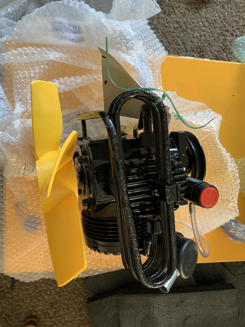

I had bought another one from AoA on recommendations from some others, which ALSO had problems. I set it up correctly, when I got to the point of filling my tank it, the pump started rattling violently right before the pump seized (while the electric motor was still taking power, but stalled in turning).
Longer version short, AoA is sending me a replacement pump unit (due to arrive tomorrow). I have to swap it out, test it, and if all goes well - I'll send them the old unit back so they can tear it down and figure out what went wrong.

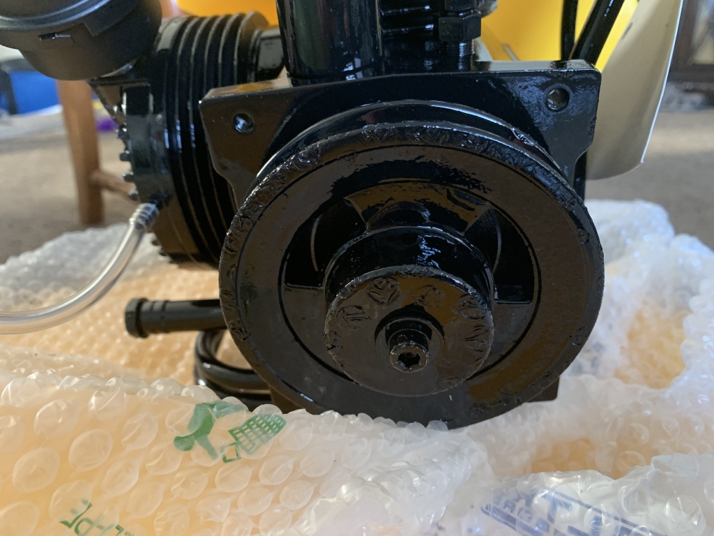

My replacement pump unit arrived. It was bubble wrapped and taped shut with Coltri labelled tape.
The paint job SUCKS. It looks like it was wrapped it while it was still wet:
Not real happy about that. If I decide on getting a big 472cu ft tank(s), I'm going to want to get a more industrial compressor, like a Bauer or an Airtex, which would extrapolate to selling this compressor to someone else. I can already imagine the low ball offers or PayPal dispute that could arise, if someone OCD bought it and nit picked at the shoddy paint. It doe
It doesn't look like $2000
