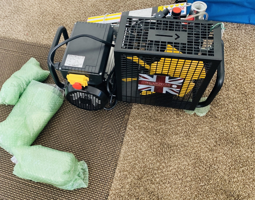

I meant to taunt you earlier to ask if you were waiting by the door yet :) Yeah man, this thing is packaged so well I think UPS/FedEx could just kick it out the back loading gate and never slow down the vehicle when delivering and it'd take no damage. Just wait until you see it.
1f603.svg
Haha, it's funny - I saw FedEx roll up ~5 minutes after I posted. You're absolutely right, this packaging is superb! I'm blown away at how small this thing is, I had it in my mind that it was the size of my gas power generator lol
