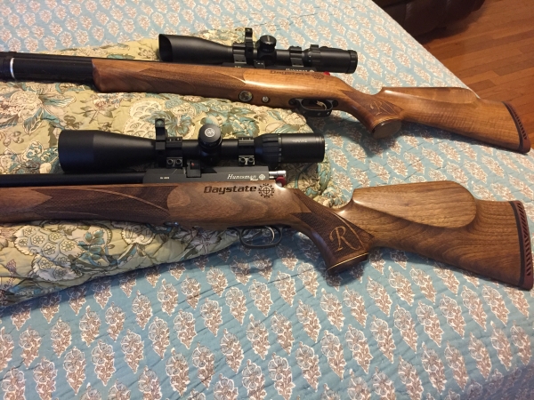

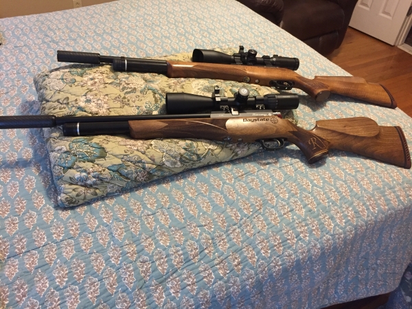

Based on the above experience with the excellent Regal in .177, I purchased a Regal XL in .25 cal. Major mistake.
The .25. cal employs the same platform as the .177 and .22 caliber. Unregulated, the shot count is low -- you'll get maybe 4-5 consistent shots, then, because of the small air cylinder, you basically have a shotgun. And the .25 caliber is loud. This rifle in .25 caliber could in fact be a very good hunting rifle. Plinker and target shooting, no way.
The 2 rifles are identical in size. In the photo above, the .25 caliber is the rifle in the foreground.
