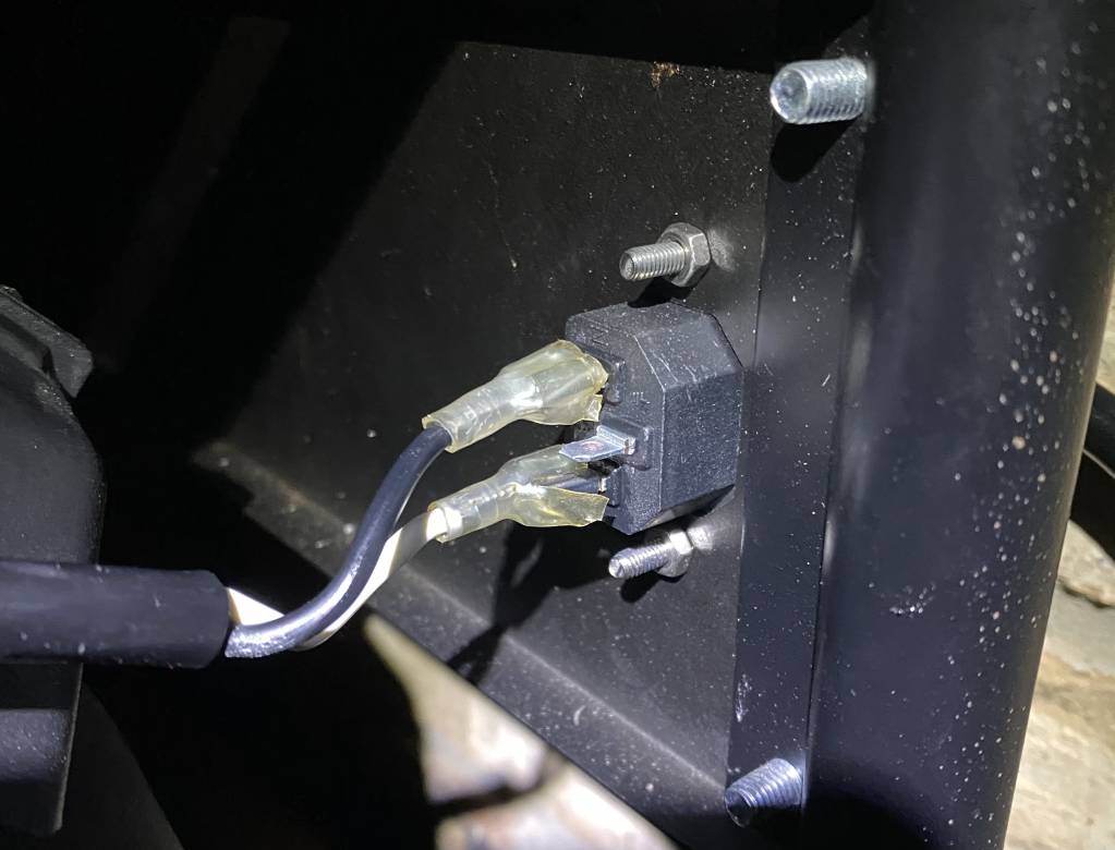

So I found corrosion on the power wire contacts where it comes in off the plug. I cleaned those and it fired up. It had actually melted the rubber insulation boots a bit on each of them.
I am not an electrician, so just wondering about that connection to the plug. There are two wires coming off of it and heading towards a box with a reset switch on it. My question is, should there be a third wire coming off the plug from the cord? Like should it be grounded or is it grounded in the plug itself? There are three prongs on the back but only two wires, is why I ask.
I swear I felt a little current running earlier when I was fiddling with it before I cleaned the plug. Made me a little concerned.
I am going to go get some new spade connectors tomorrow to replace those, they are obviously shot. I used deoxit on the connectors for now, just trying to see if it would run and I ran it for 5 minutes without a load.
