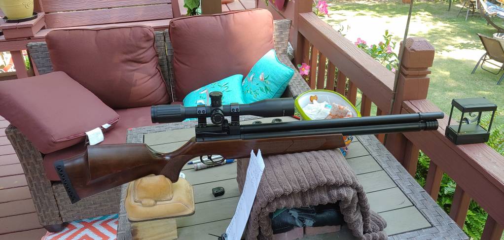

You mentioned the gamo urban. I have one and love it. It is super accurate. To get velocity close to 900 you have to shoot 14 gr pellets. If it were me buying a first gun knowing how great the urban is I would go on Ebay and search for BSA buccaneer. There are black stocked ones on there for 300. Basically the same gun as an urban. It has a slightly bigger air cylinder and a 4-5 inch longer barrel. With the longer barrel it will produce more power. I would guess it would push an 18 gr pellet in the mid 800's. Perfect and the BSA barrels are laser accurate
