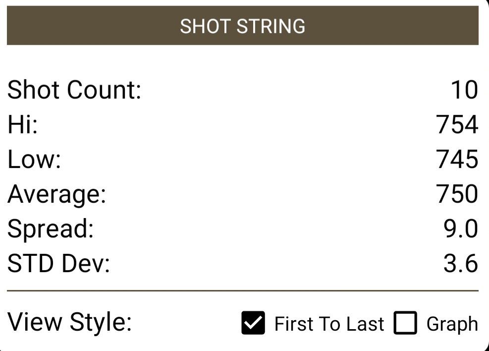

Thats a good point. Just ran 2x 10 shot strings for a comparison. That did show a significant change between the two skirt types.
PERFECT SKIRTS:
DAMAGED/FLATTENED SKIRTS:

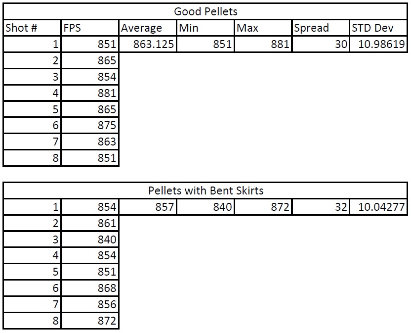

Sounds good to me after conducting this experiment myself. Here are the numbers that my pellets put up:
This includes my "fliers" even though I mentioned that they sounded different, and I suspect that it had something to do with freezing.
I think that it is pretty safe to say that I didn't experience a significant difference in velocity, but as I mentioned, my plenum is running really high on that gun, so it could be "fixed" right after pulling the trigger.

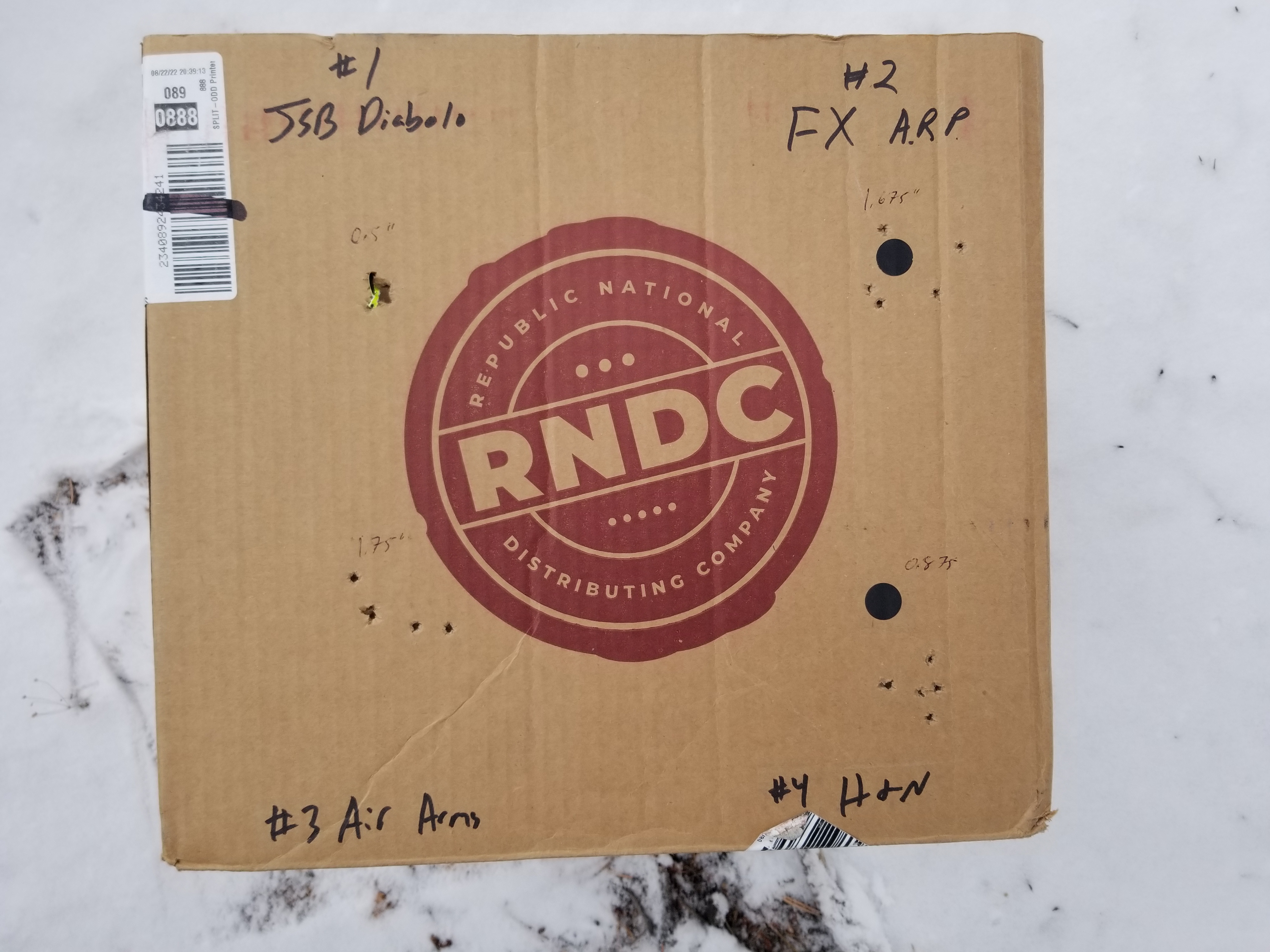

Even JSB's with bent skirts are grouping better than FX or Air Arms with the exact same pellet weight in my particular gun with my barrel. Your position is pretty ridiculous with respect to this thread:
Bad skirts on the right with a 1.0625"c-c:
Comparison between JSB (0.50"c-c), FX (1.675"c-c), AA (1.75"c-c), and H&N (0.875"c-c):

I'm a bit curious as to why your non-dented skirts numbers are that high. The spread and deviation seem to be higher than what I would expect from most guns. What gun are you using here? (Sorry if you mentioned that already)
I was surprised that my spread was that high too. It is a really modified 2240 that is PCP. It was really cold when I did this, and my spread definitely goes up when it is below freezing outside, so I figure it was just moisture. I mentioned this on a thread a year or so ago. Even though the spread will increase in the cold, the POI doesn't seem to be affected...much.

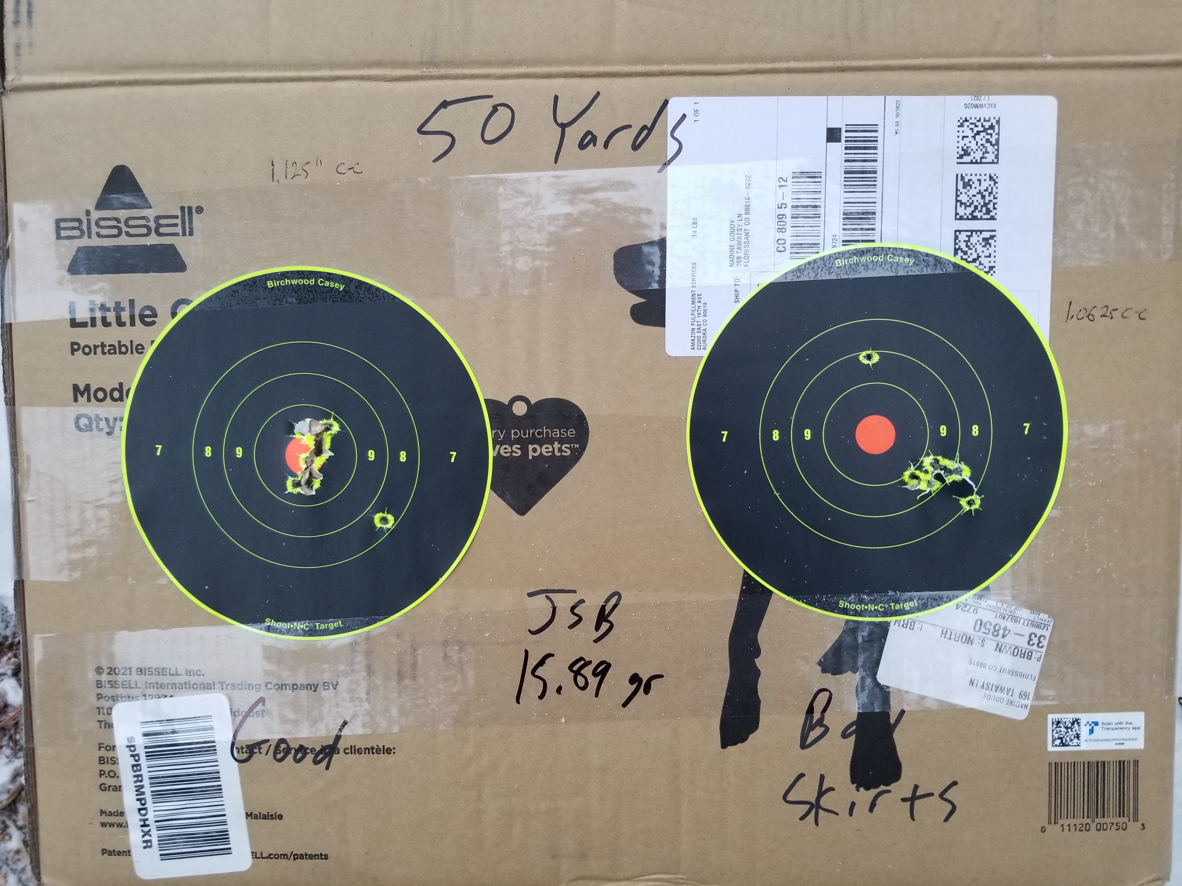

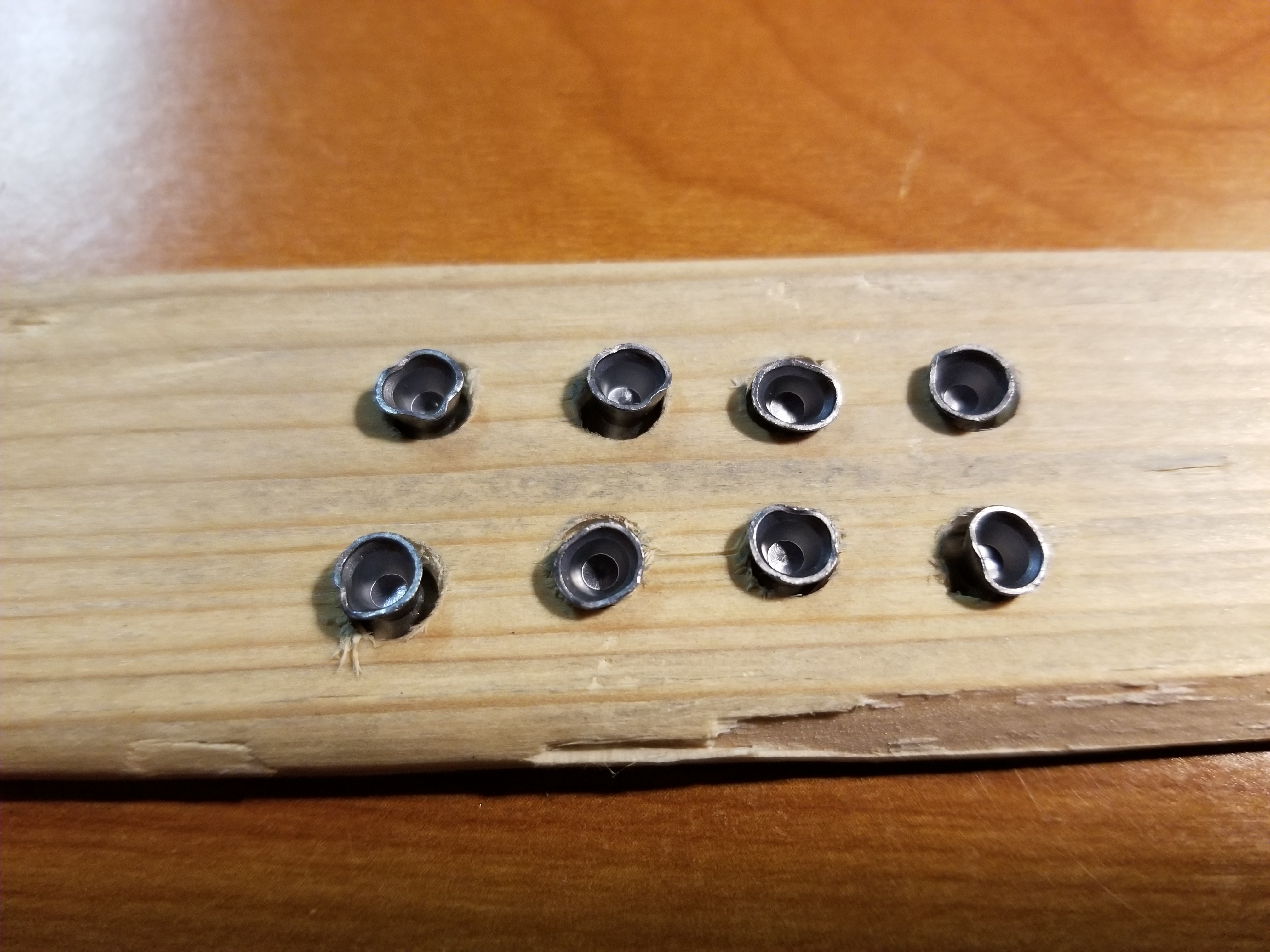

I too have had a bunch of pellets with bent skirts. In the past, I would just toss them in the trash, but the last batch that I got had nearly 10% of the pellets that had small issues at least. I didn't want to toss 50 pellets in a tin, so I have been firing them lately at the cans on my range, and I didn't notice a remarkable difference in the performance...especially not to justify throwing the pellets away. I did a test myself of "good" pellets versus those with bent skirts at 50 yards. Here is a video of the test:
Just to note, here are the pellets with good skirts:
Here are the pellets with bent skirts that I shot:
Here is a picture of the final results:
I got a very slightly better center-to-center grouping from the bent pellets than the good pellets. I got 1.125" spread on the good pellets, and 1.0625" on the bent pellets. The most notable thing is that the POI was pretty consistently shifted low and to the right.
Believe it or not, I didn't notice a remarkable difference in the velocity between the bent pellets and the "good" ones. I expected the velocity to be lower with the bent skirts, and that wasn't the case.
I wouldn't want to shoot these at a competition, especially at the BenchRest, but for plinking, they may through off your POI a bit, but there is no reason to trash these if you are just shooting for your own pleasure. I thought they would be WAY off, but this is not the case.

Looks like they penetrated the boards about the same... ;)
