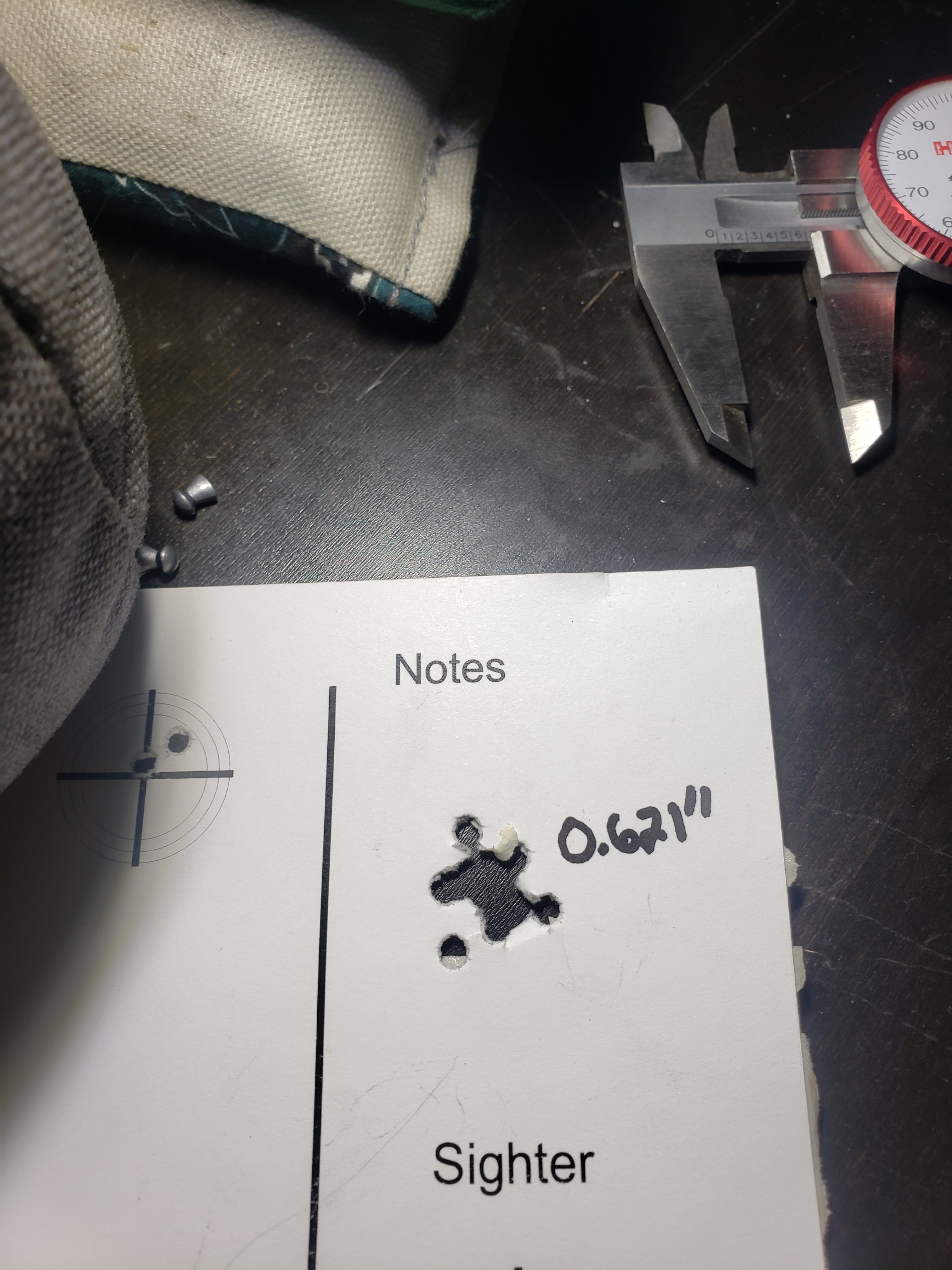

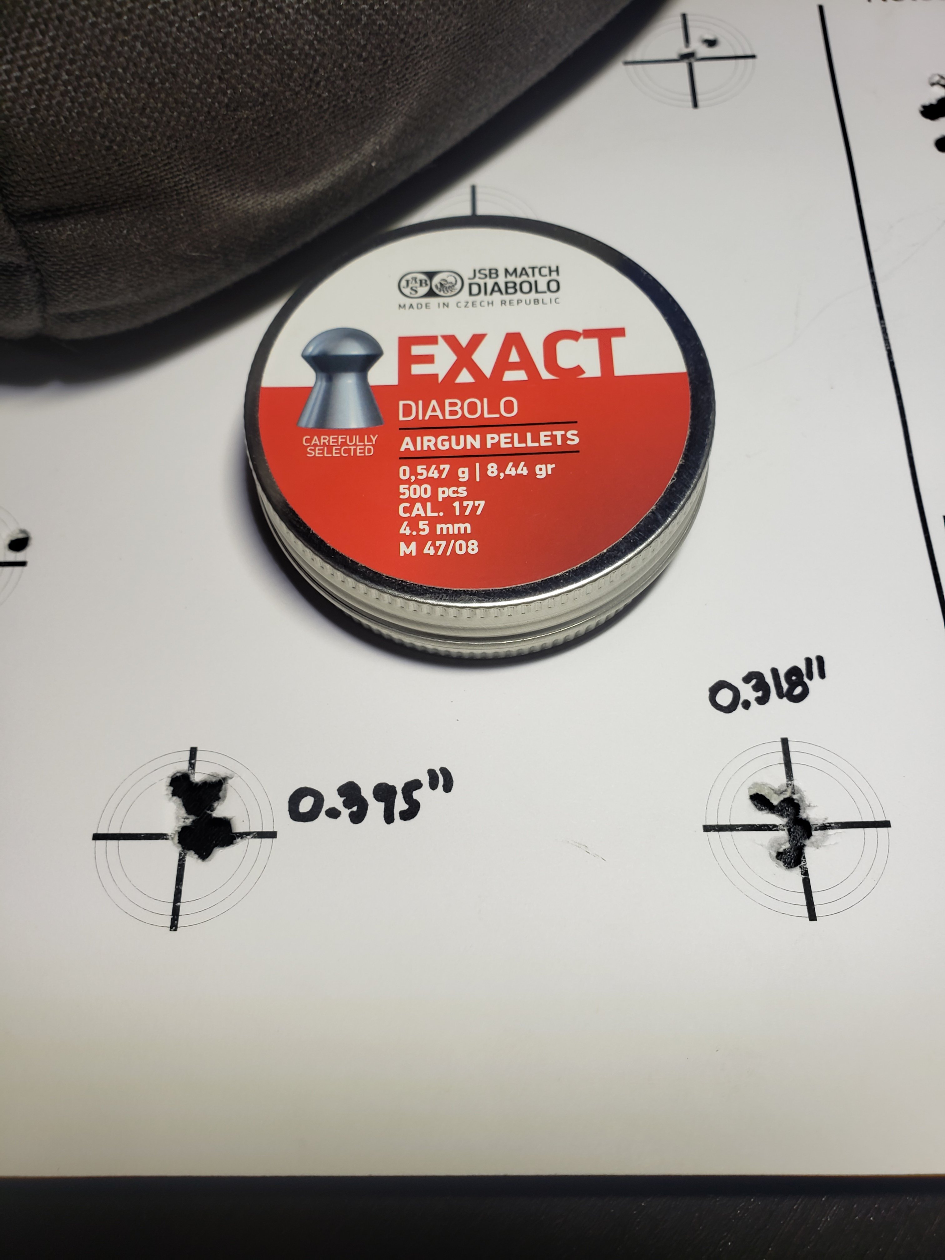

Got bored and decided to run a quick test to see the effects of damaged skirts on accuracy. I was honestly a little surprised with the results.
Undamaged Pellets Groups:
The picture above shows two seperate 10x shot groups taken at 30m. The group on the left is just 10 pellets pulled at random from the tin and sent down range. The group measured 0.395" CTC.
The group on the right is with 10 pellets pulled from the tin but each skirt was examined for any defects. If none were found, they were sent towards the target. That group measured 0.318". Pretty solid improvement if you ask me.
Damaged Pellets Group:

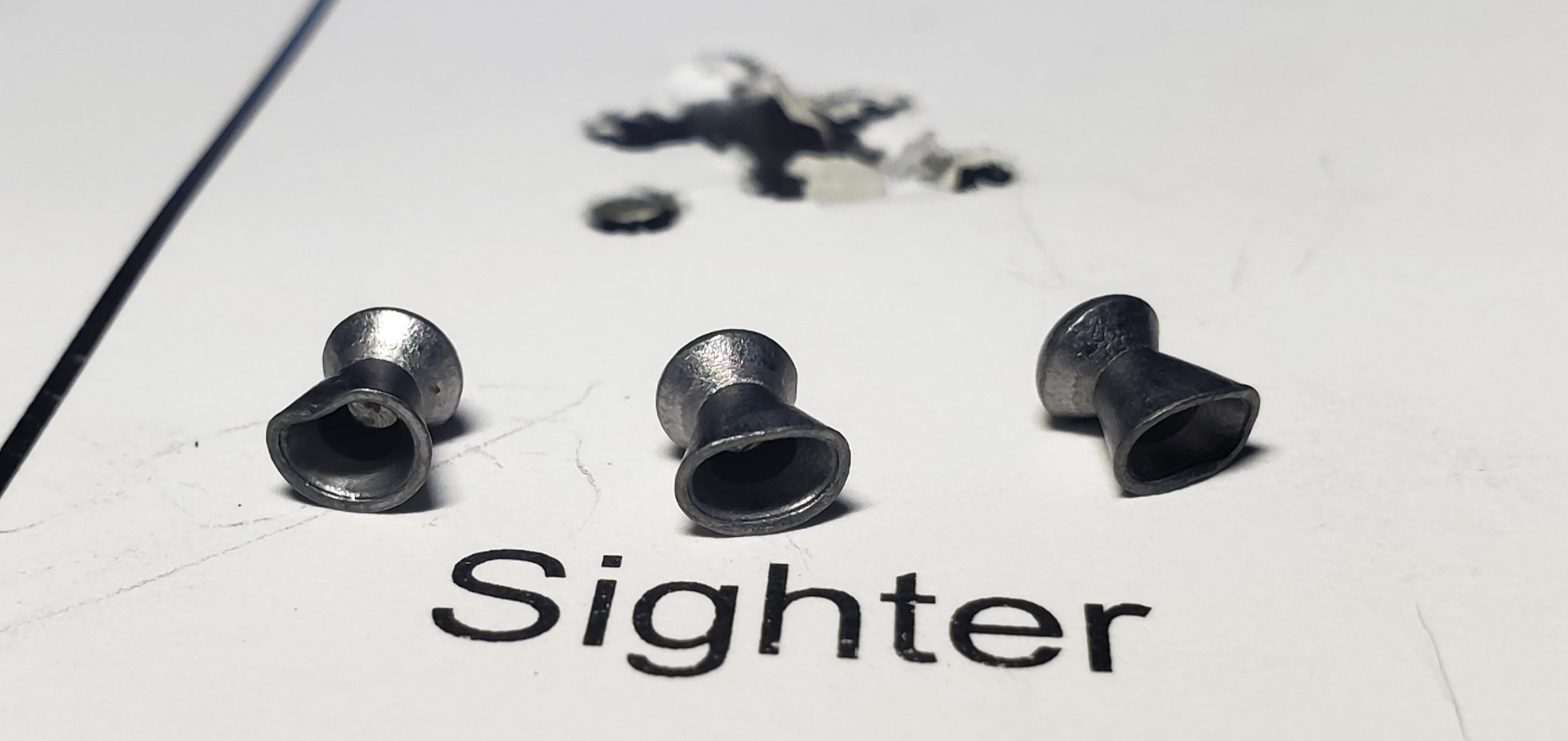

Here is where it gets interesting for me though. Picture #3 was 10 shots with more than just a little skirt damage. You can get a rough idea of what these pellets looked like from the first picture. One of these pellets had both sides of the skirt literally touching in the center. I was expecting an 1.5"+ from this group. What I got was 0.621".... I can live with that any day of the week.
I guess what I learned is that I shouldn't waste "bad" pellets. I wouldn't use them for hunting or in a match but for plinking? All day.

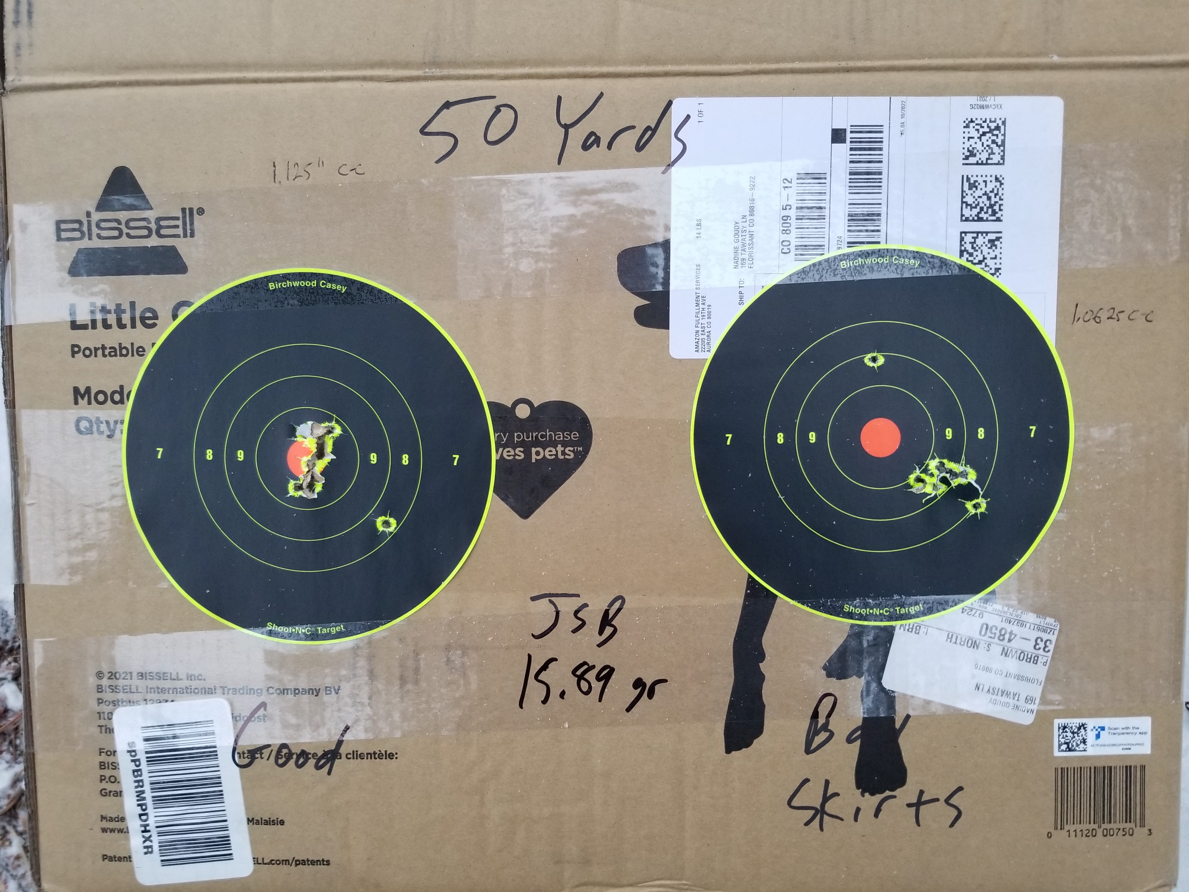

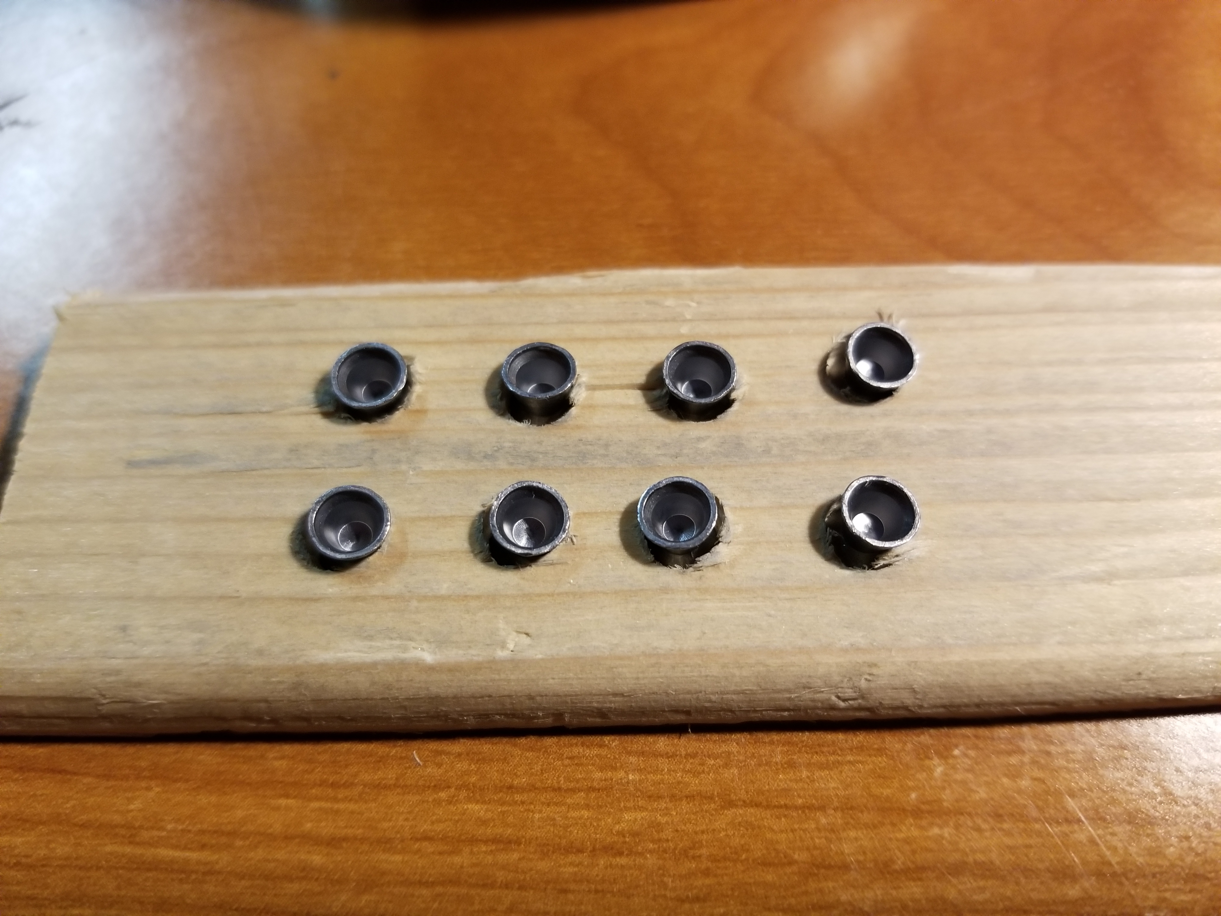

I too have had a bunch of pellets with bent skirts. In the past, I would just toss them in the trash, but the last batch that I got had nearly 10% of the pellets that had small issues at least. I didn't want to toss 50 pellets in a tin, so I have been firing them lately at the cans on my range, and I didn't notice a remarkable difference in the performance...especially not to justify throwing the pellets away. I did a test myself of "good" pellets versus those with bent skirts at 50 yards. Here is a video of the test:
Just to note, here are the pellets with good skirts:
Here are the pellets with bent skirts that I shot:
Here is a picture of the final results:
I got a very slightly better center-to-center grouping from the bent pellets than the good pellets. I got 1.125" spread on the good pellets, and 1.0625" on the bent pellets. The most notable thing is that the POI was pretty consistently shifted low and to the right.
Believe it or not, I didn't notice a remarkable difference in the velocity between the bent pellets and the "good" ones. I expected the velocity to be lower with the bent skirts, and that wasn't the case.
I wouldn't want to shoot these at a competition, especially at the BenchRest, but for plinking, they may through off your POI a bit, but there is no reason to trash these if you are just shooting for your own pleasure. I thought they would be WAY off, but this is not the case.

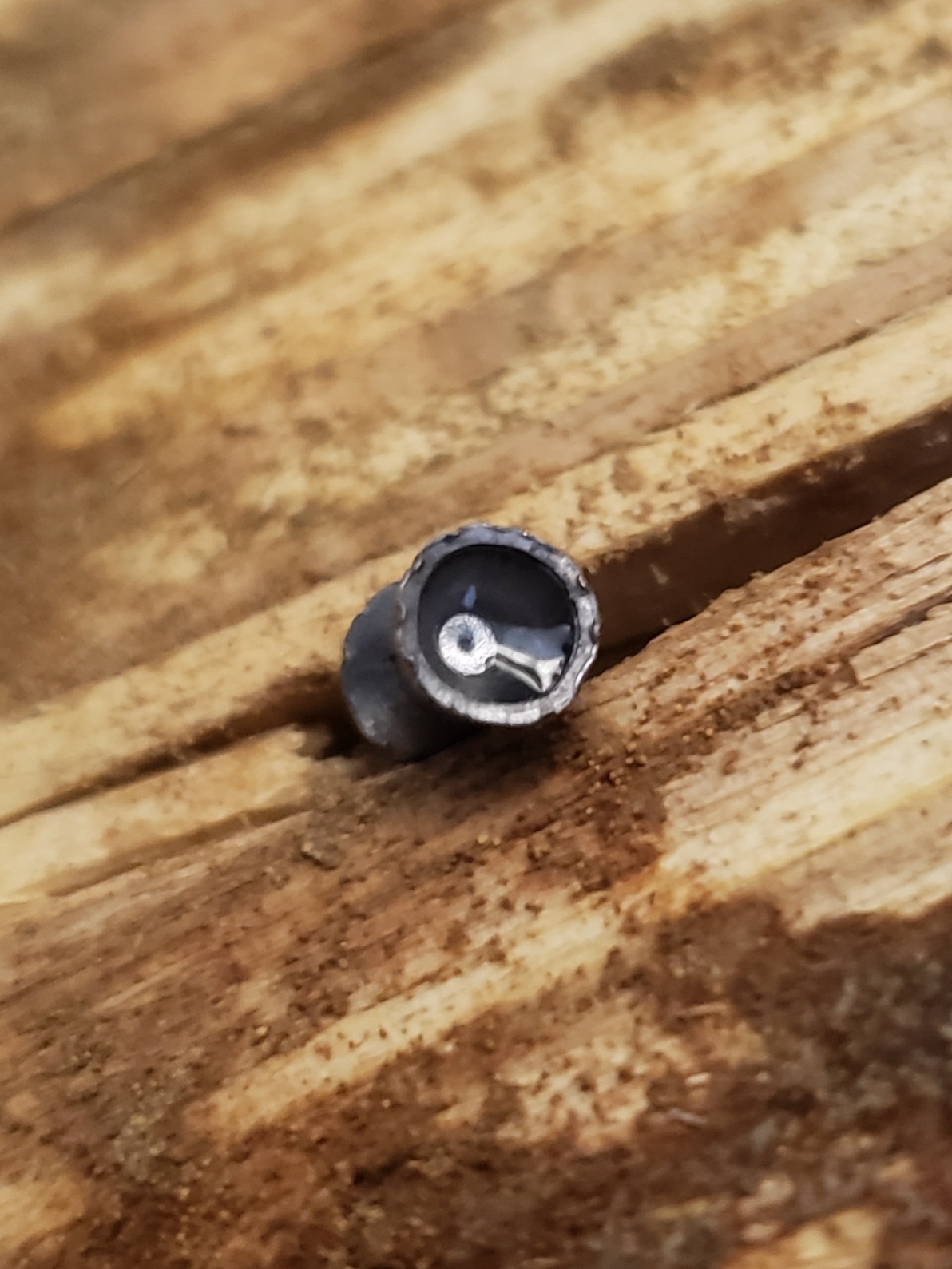

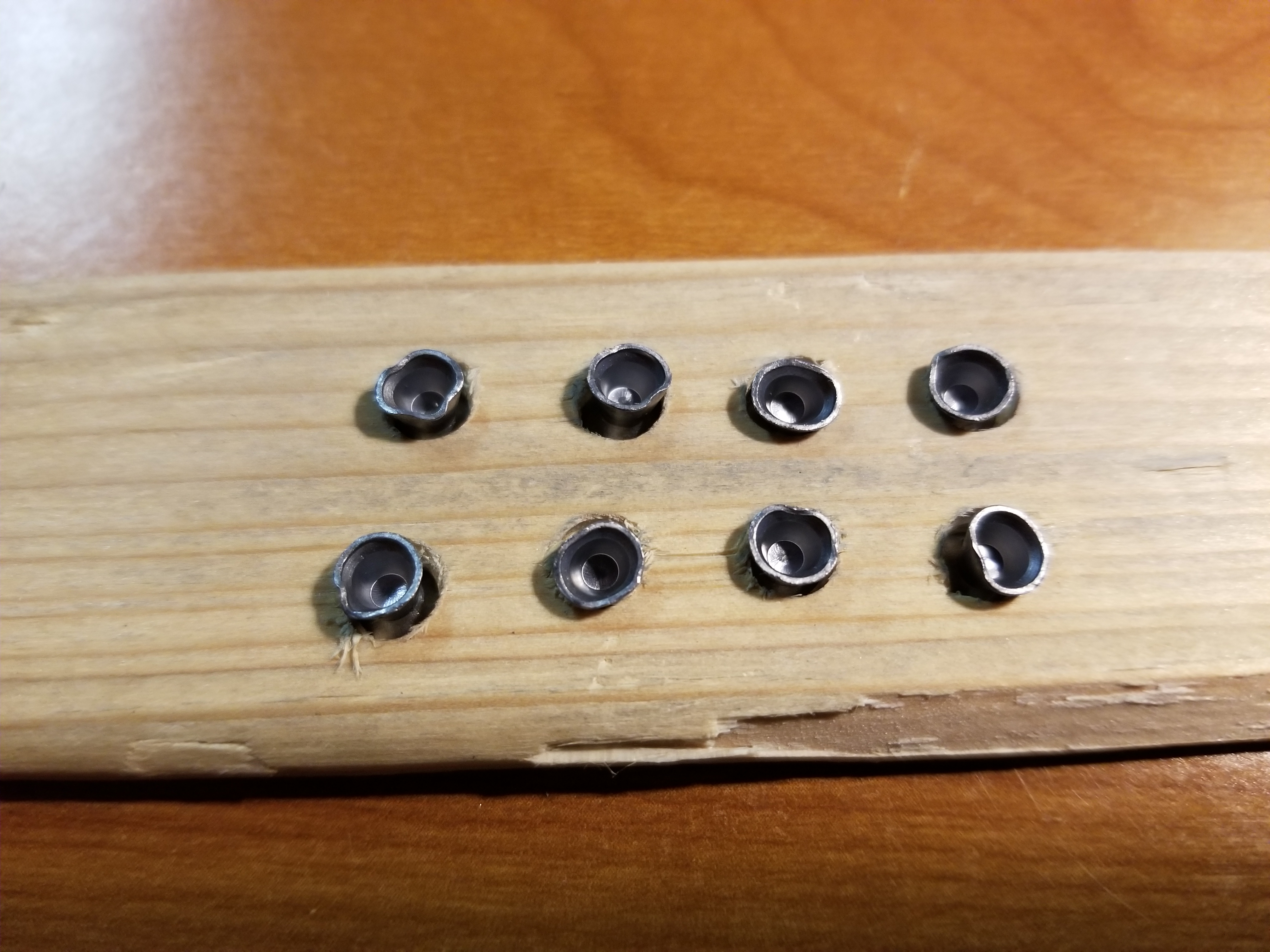

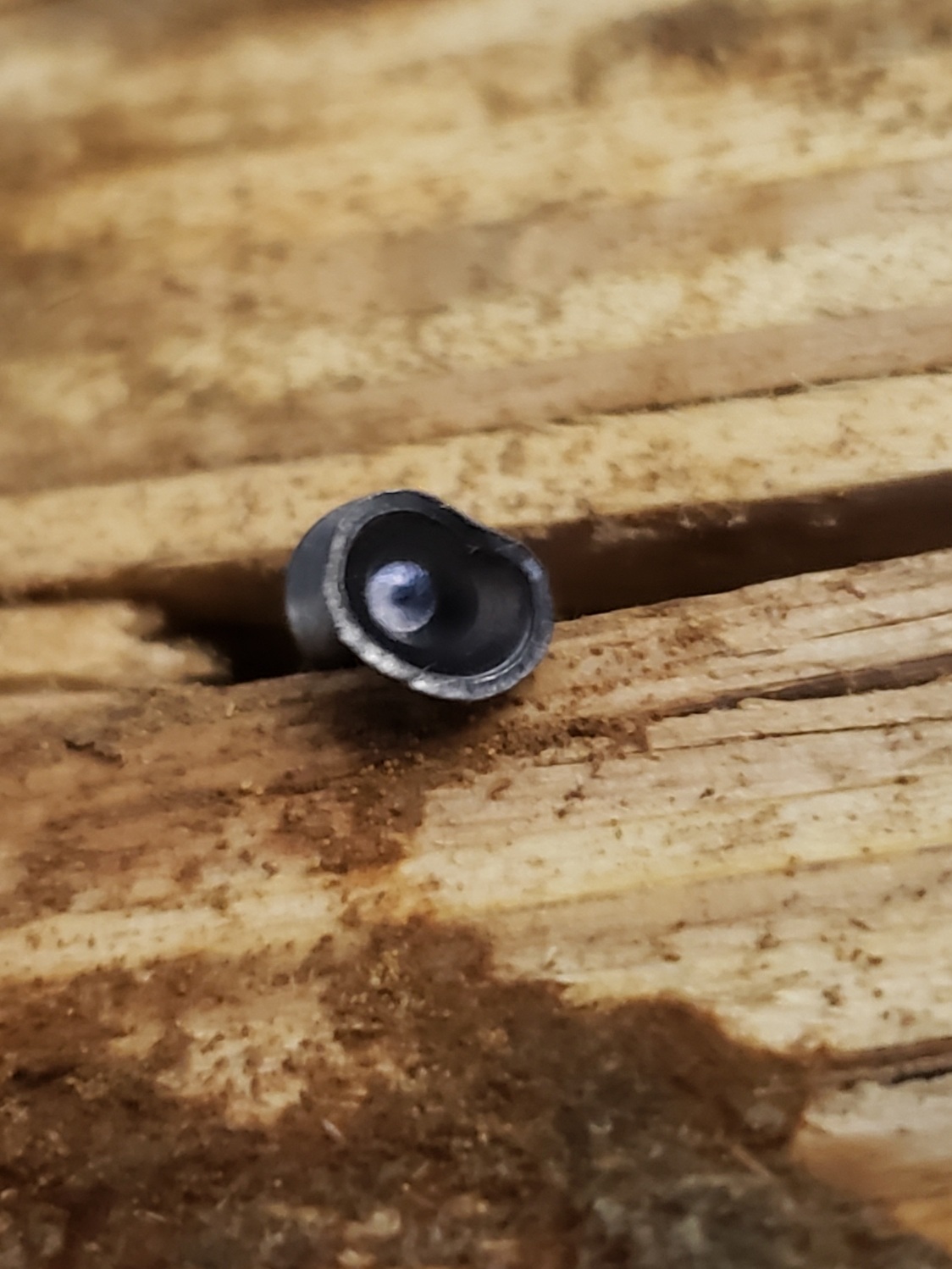

Maybe next time see if you can capture some of the damaged skirt pellets in a foam backing if possible and see if they opened up to something closer to round.
Be interesting for sure.
This is definitely the missing piece of data in this experiment. I feel pretty strongly that the skirts will be "fixed" by the pressure and rifling. The pellets consistently gave right at 26FPE whether the skirts were perfect or deformed.

Another issue that's relevant is your damaged pellets, once they've been extruded through your barrel will be deformed yet-again. I imagine much of your damage will be erased by this process. Perhaps if you fire them at slow velocity into a gelatin you could check to see the extent to which your pellets are "corrected" via the barrel extrusion.
