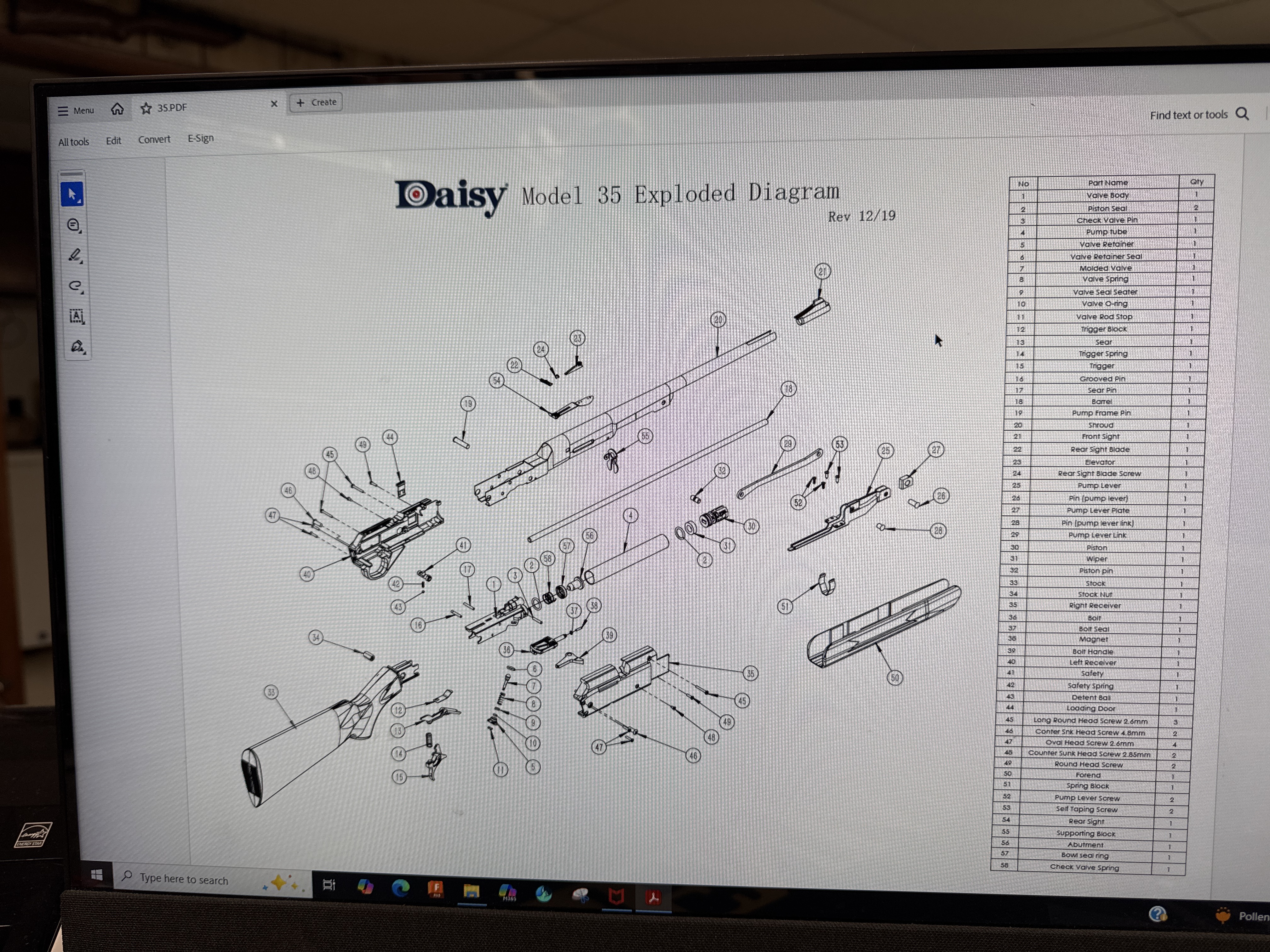

Daisy powerline 35 schematic
.😎 ICONIC GROUP.
It’s the safety spring. It also has a ball detent with it.
Reactions: d3vnull and TnCnDn
okay so where did you find the diagram
and if the spring is miss so is the ball
bearing balls are easy to find on Ebay over the years i have bought 2-2.5-3.0mm and that covers most and the way Daisy has done all the style safety balls and springs are always lost
i have been use 3mm balls in my 7-7 pistols and a spring of the same size will work grease the spring and buy some bearing balls
Find? Don’t need to find. Airgun Revisions is WELL connected with airgun manufacturers and currently a part of the Iconic team (Crosman,Daisy,Gamo,Benjamin,Centerpoint,BSA,Gamface, Lazermax ect.) ASA member, Full shop Air gun business owner, Service center blah blah on and on. So I have the keys so to speak. We are way more then just a dealer as stated in red by our name here.
For Daisy you can find what you’re looking for easily through E-bay guys.
