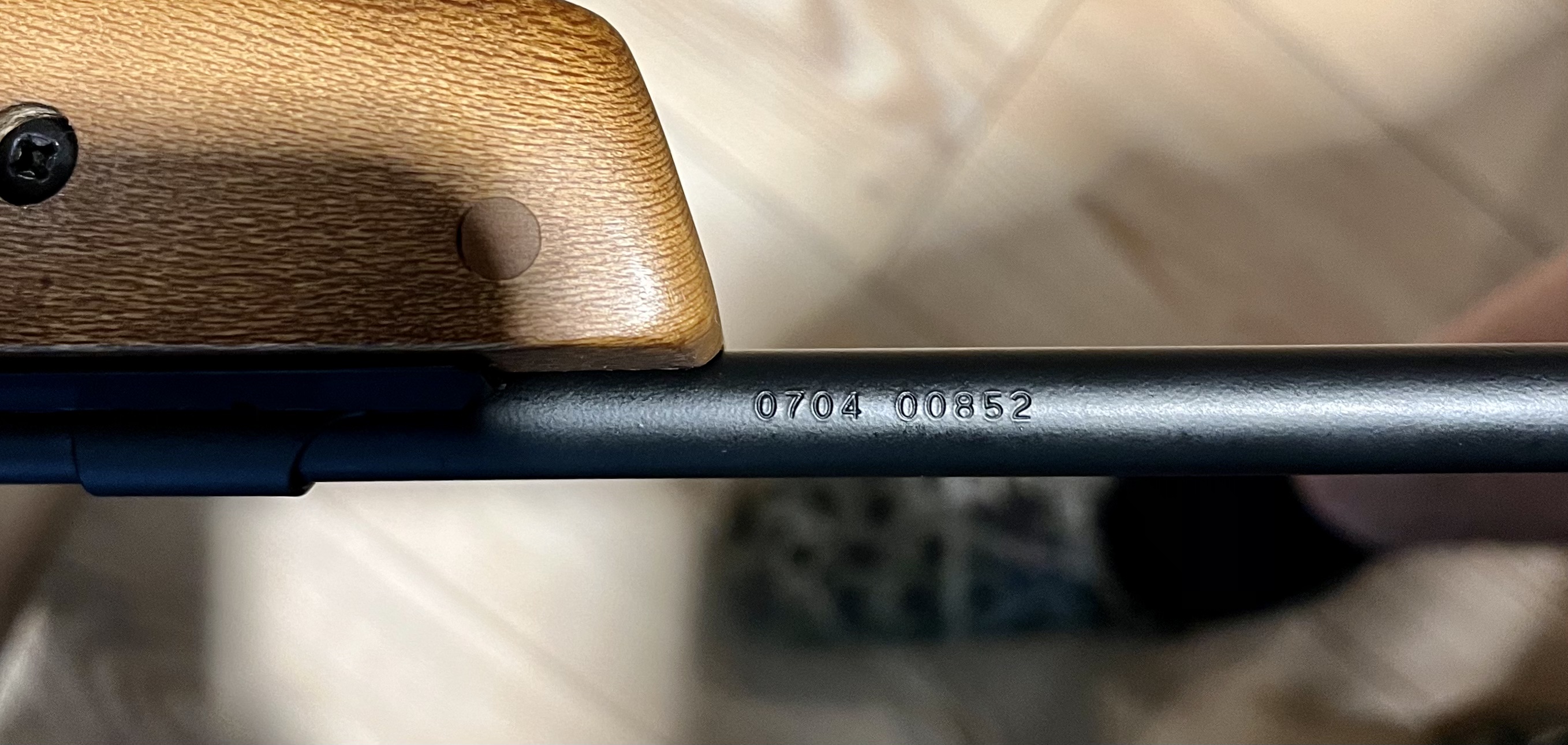

I recently picked up this Daisy Avanti 753W. New old stock. Trigger was horrible. Over 10 pounds. Did the complete trigger job which included a adjustment screw added for sear engagement. Now 12 ounces with no creep. Could go even lighter. Accuracy is outstanding. On a calm day it will bust aspirin tablets at 40 yards. (Using 7 grain RWS Hobby) This one loves these pellets better that RWS R10’s. Most accurate gun I’ve owned since the Diana 75 and FWB 300. I’m trying to find out the year of production. Maybe July 2004? This one has the cast metal pumping lever. Not the plastic one on current models. I am also wondering when Daisy started making the plastic pumping lever. And if the plastic lever holds up. I have mounted a scope on this one but would like another one for the Diopter. Any help is welcome. Opinions on one you might own.

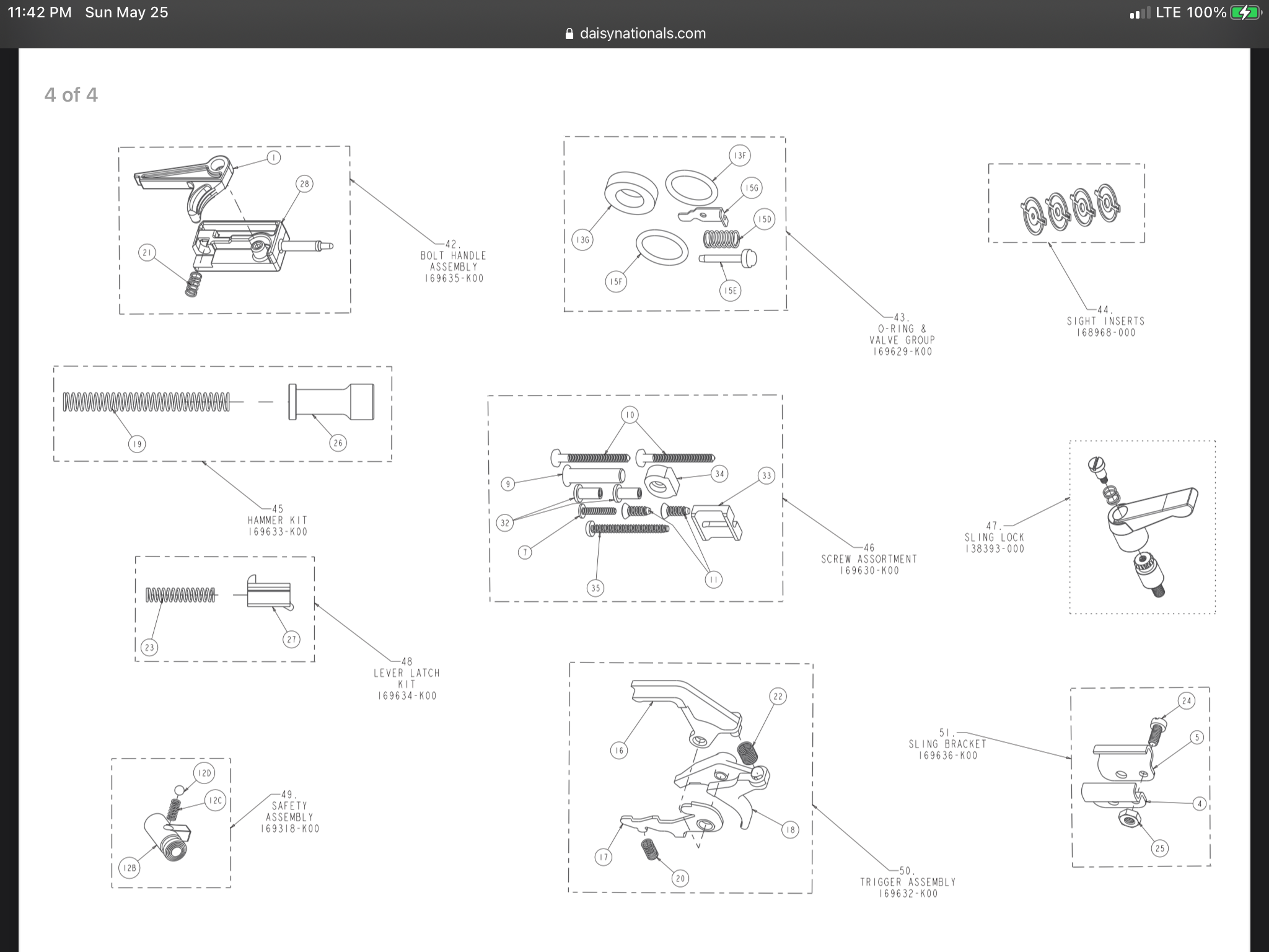

Not complicated at all. Here is a step by step guide. I also ordered a new trigger guard, trigger, sear etc. (Parts needing to be modified) It came as a unit from Daisy. The lady at Daisy was very helpful. I modified the new parts so as not to damage the original ones. The entire order with o-rings for three rebuilds came to $23 including shipping. $10 was shipping. Daisy parts are dirt cheap. The parts list is confusing so this was my order. Took about a week. The trigger is now outstanding.

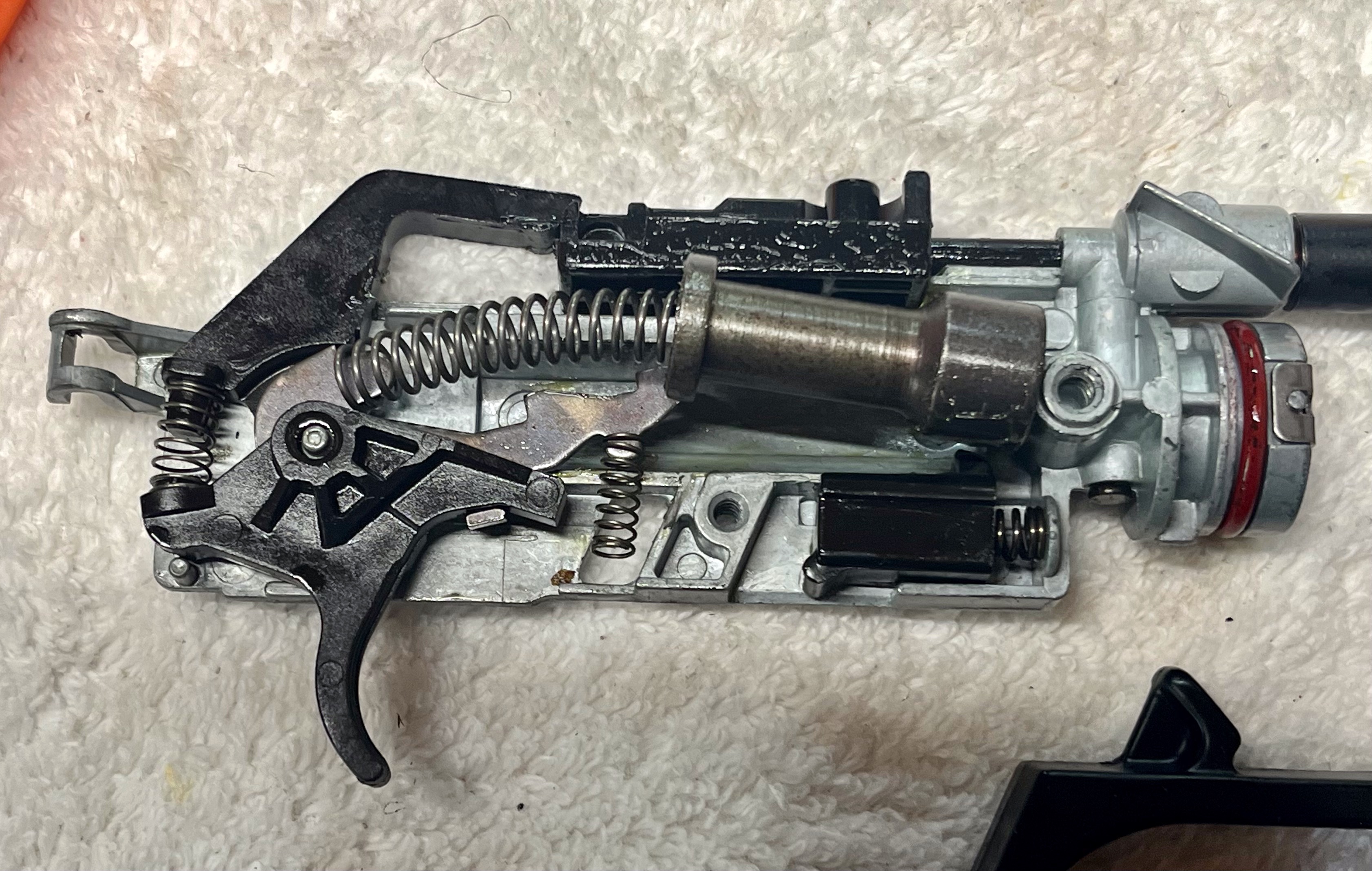

Yes. The hammer spring drives the system. The “lawyer “ spring under the sear can be removed. The spring from the trigger to the piece above the trigger can be reduced and shortened to almost nothing once the sear adjustment screw is installed.

1. Keep in mind that when the new adjustment screw is turned inwards to lessen the sear engagement, the spring on the upper left of the trigger is compressed. This spring needs to be almost with no pressure on it when the adjustment screw is not yet inserted. And VERY light duty.
2. When using the 8-32x3/4 socket head screw, turn the head down to a bare minimum to be able to tuck in the new trigger housing channel. I used the small 1/4 sanding drum Dremel bit to make the groove.
3. The mod calls for the removal of the cast pin on the trigger housing. I used a Drexel metal cutting bit, not nippers. The pin only needs to be partially removed. Just enough for the adjustment screw to pass through.

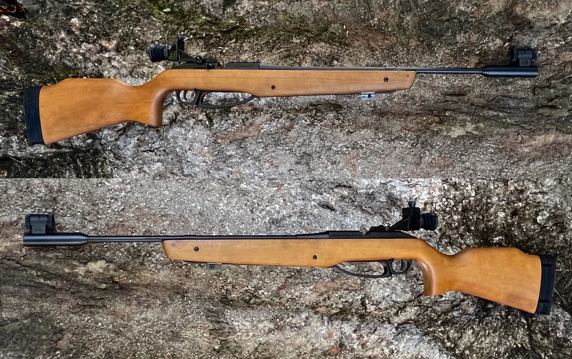

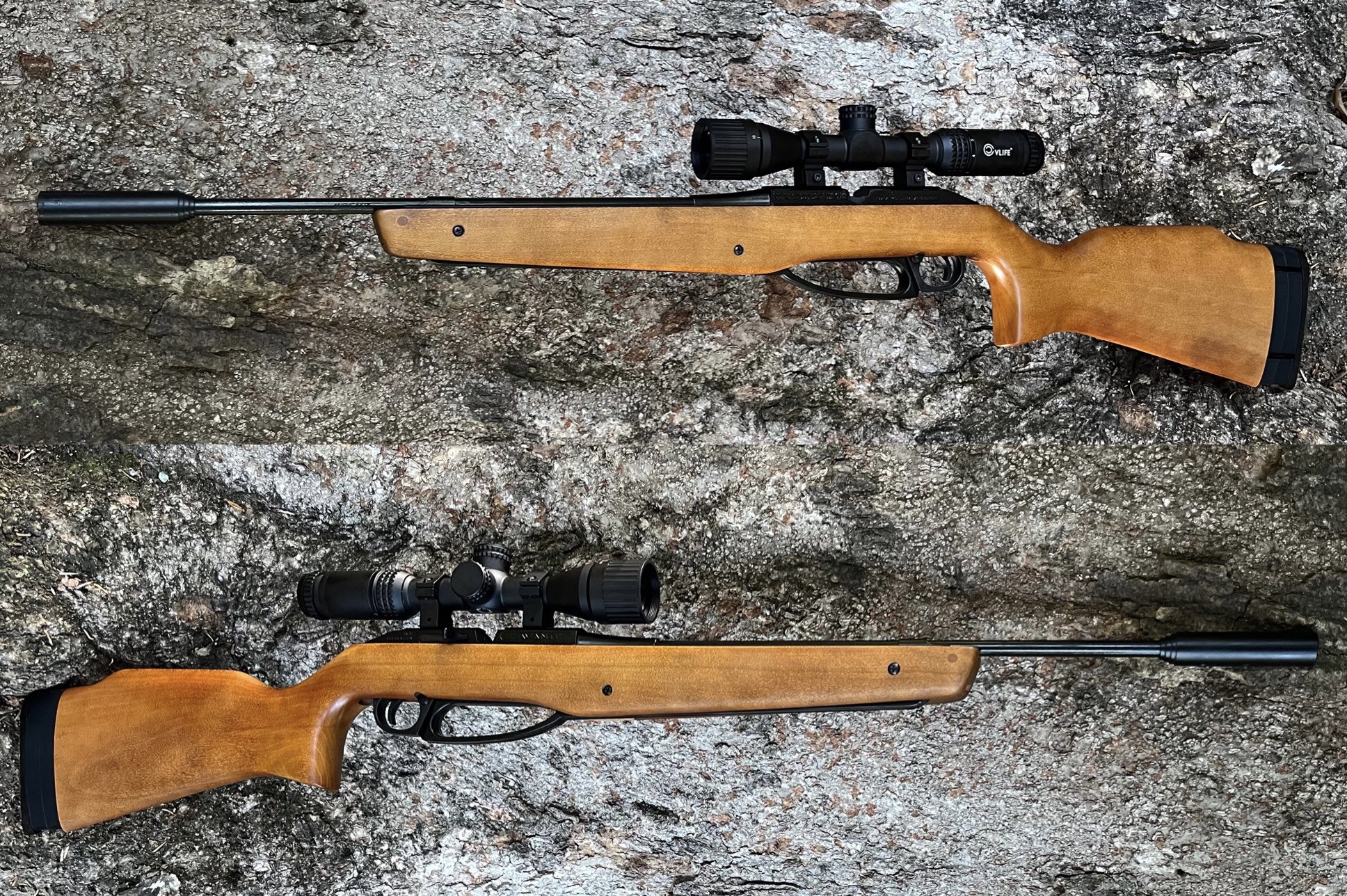

I recently picked up this Daisy Avanti 753W. New old stock. Trigger was horrible. Over 10 pounds. Did the complete trigger job which included a adjustment screw added for sear engagement. Now 12 ounces with no creep. Could go even lighter. Accuracy is outstanding. On a calm day it will bust aspirin tablets at 40 yards. (Using 7 grain RWS Hobby) This one loves these pellets better that RWS R10’s. Most accurate gun I’ve owned since the Diana 75 and FWB 300. I’m trying to find out the year of production. Maybe July 2004? This one has the cast metal pumping lever. Not the plastic one on current models. I am also wondering when Daisy started making the plastic pumping lever. And if the plastic lever holds up. I have mounted a scope on this one but would like another one for the Diopter. Any help is welcome. Opinions on one you might own. View attachment 565350View attachment 565351

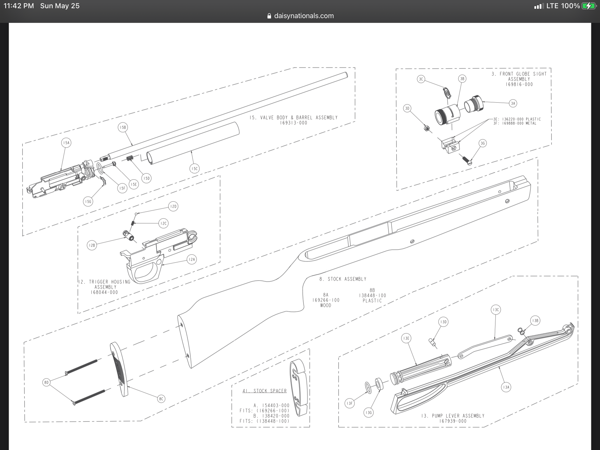

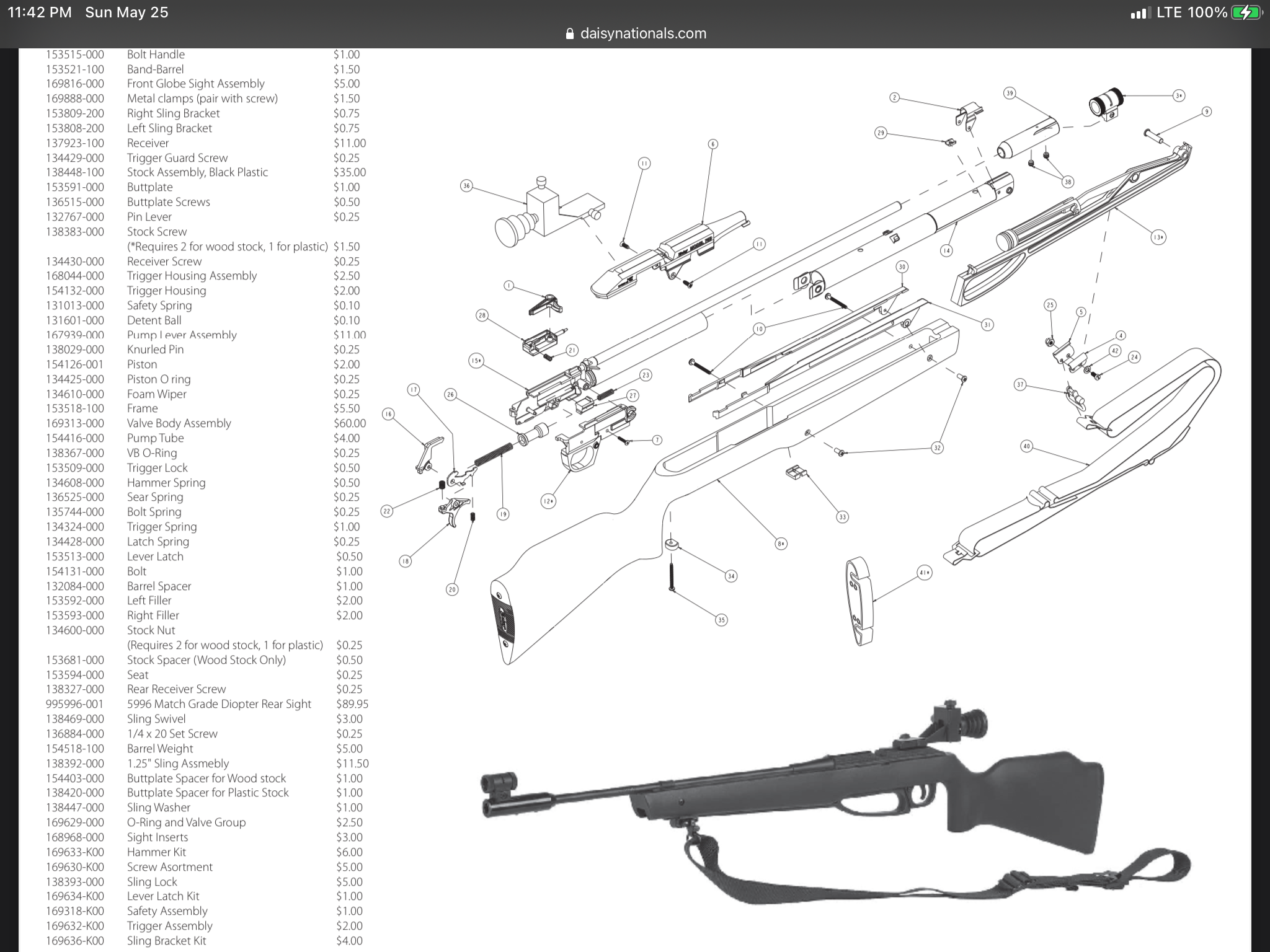

This is a complete parts and price list.

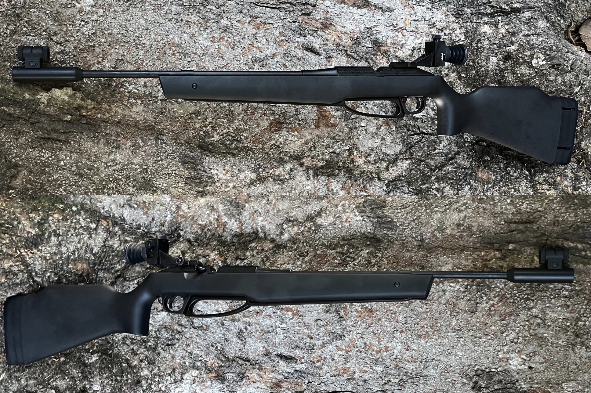

Got in my new 753S. Did the trigger modification and lube. Kept this one with the Diopter. Unbelievable accuracy at 40 yards. This one loves the RWS Hobby 7.0 grain pellets also. Shoots them at 525 fps. Love shooting with the target sights. Not crazy about synthetic stocks (packed the cavity with memory foam) but these 753’s aren’t lookers, just shooters. No other 6lb one pump or one cock rifle out there that I know of with this accuracy. The simplicity of the 753 is amazing. This is how mine are rigged.
Got in my new 753S. Did the trigger modification and lube. Kept this one with the Diopter. Unbelievable accuracy at 40 yards. This one loves the RWS Hobby 7.0 grain pellets also. Shoots them at 525 fps. Love shooting with the target sights. Not crazy about synthetic stocks (packed the cavity with memory foam) but these 753’s aren’t lookers, just shooters. No other 6lb one pump or one cock rifle out there that I know of with this accuracy. The simplicity of the 753 is amazing. This is how mine are rigged. View attachment 568289View attachment 568290
Very nice Dan. I should look into a 753 to go with my 853. They are a pleasure to shoot, especially after the trigger is fixed.
